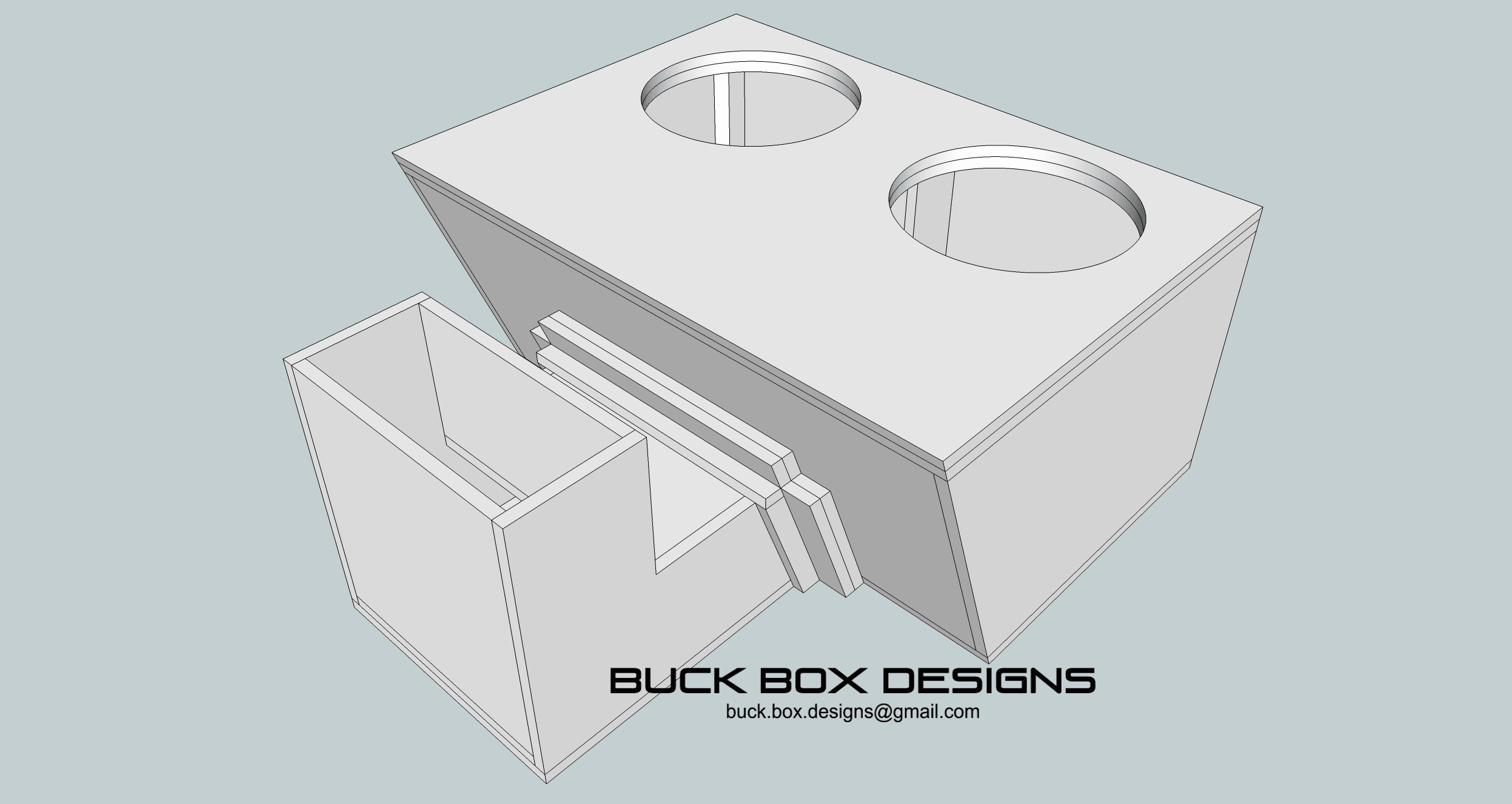

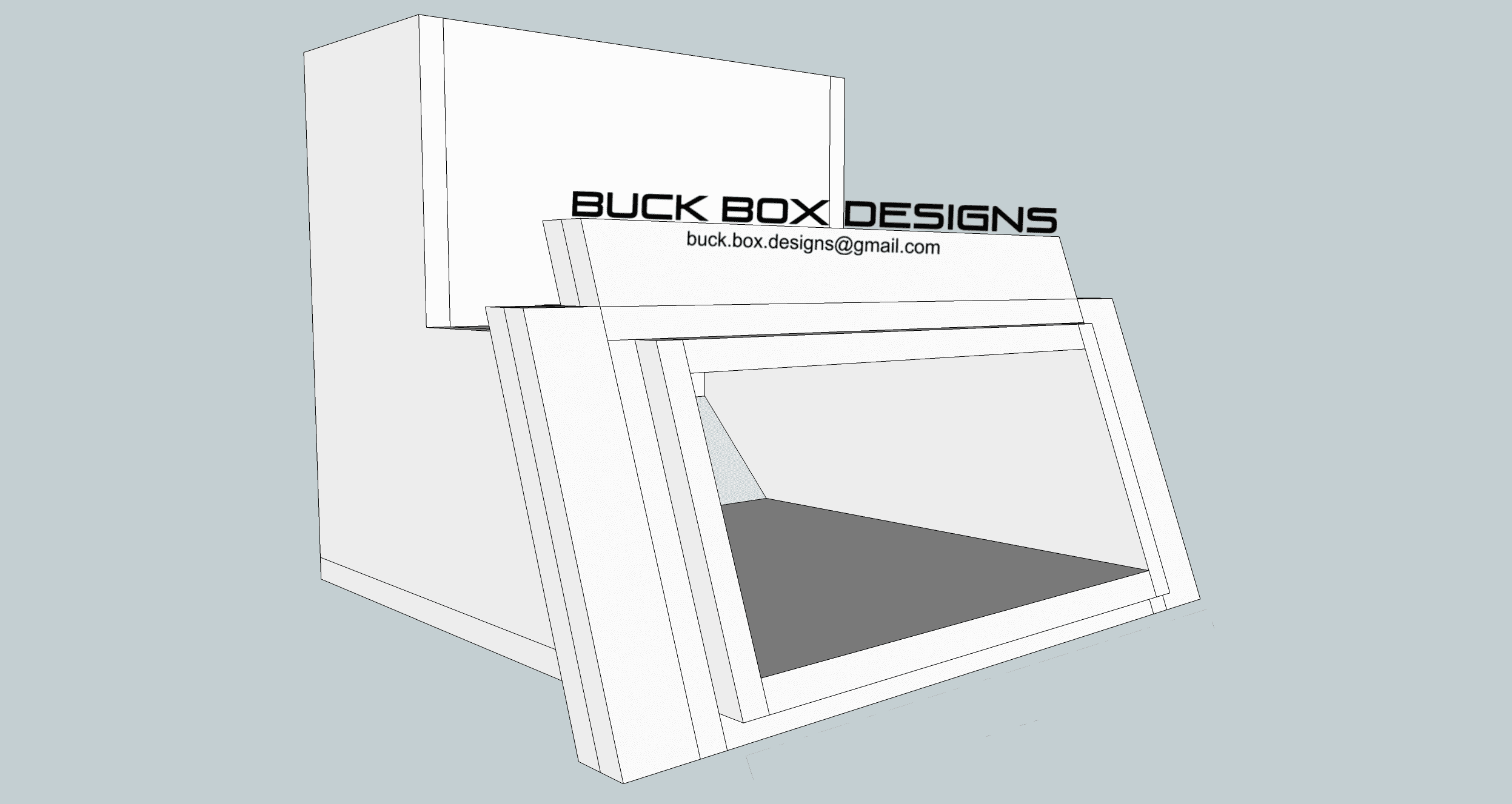

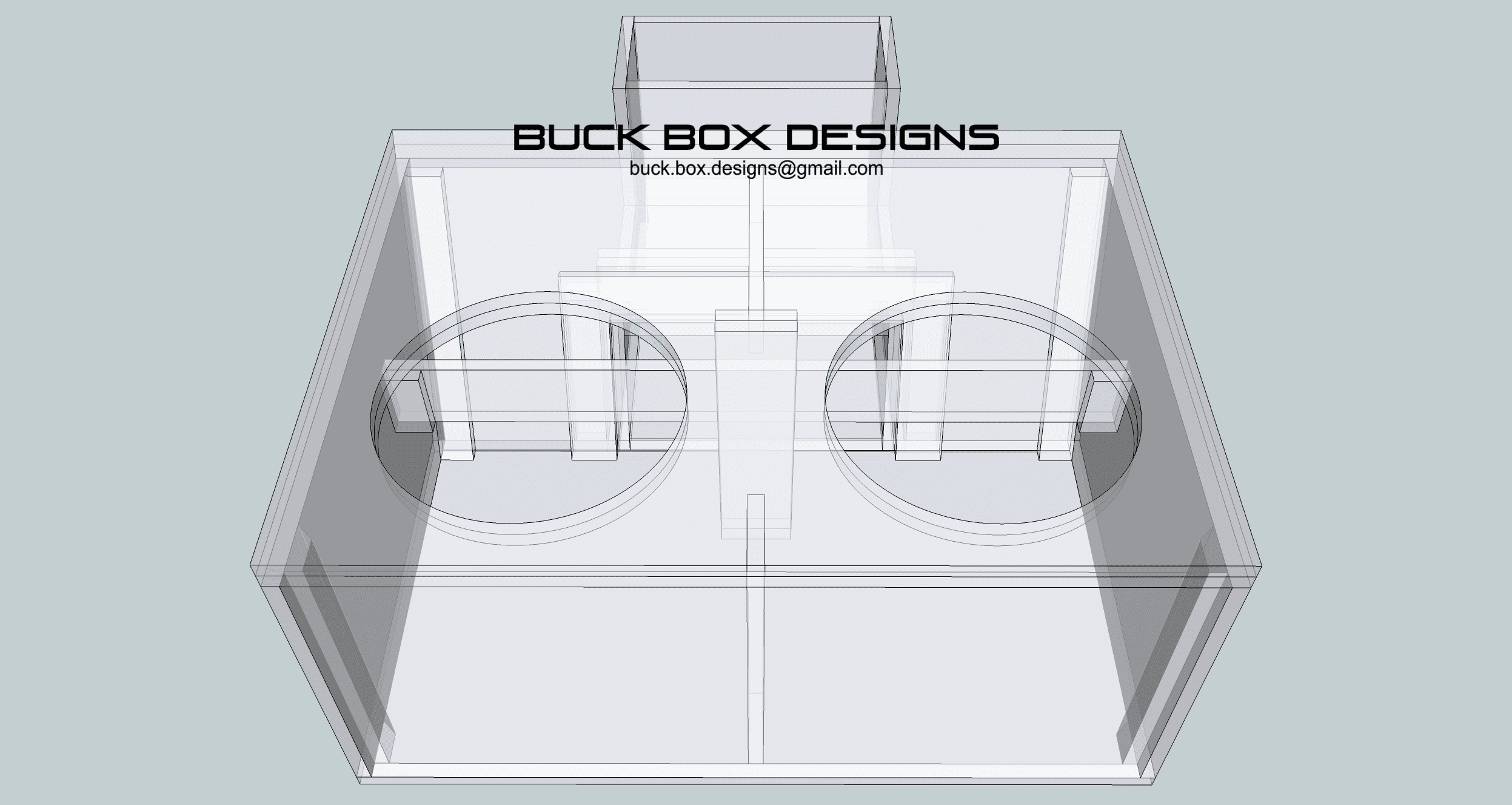

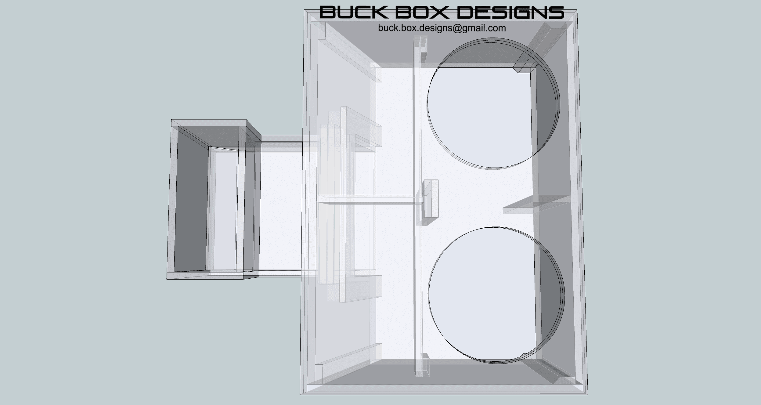

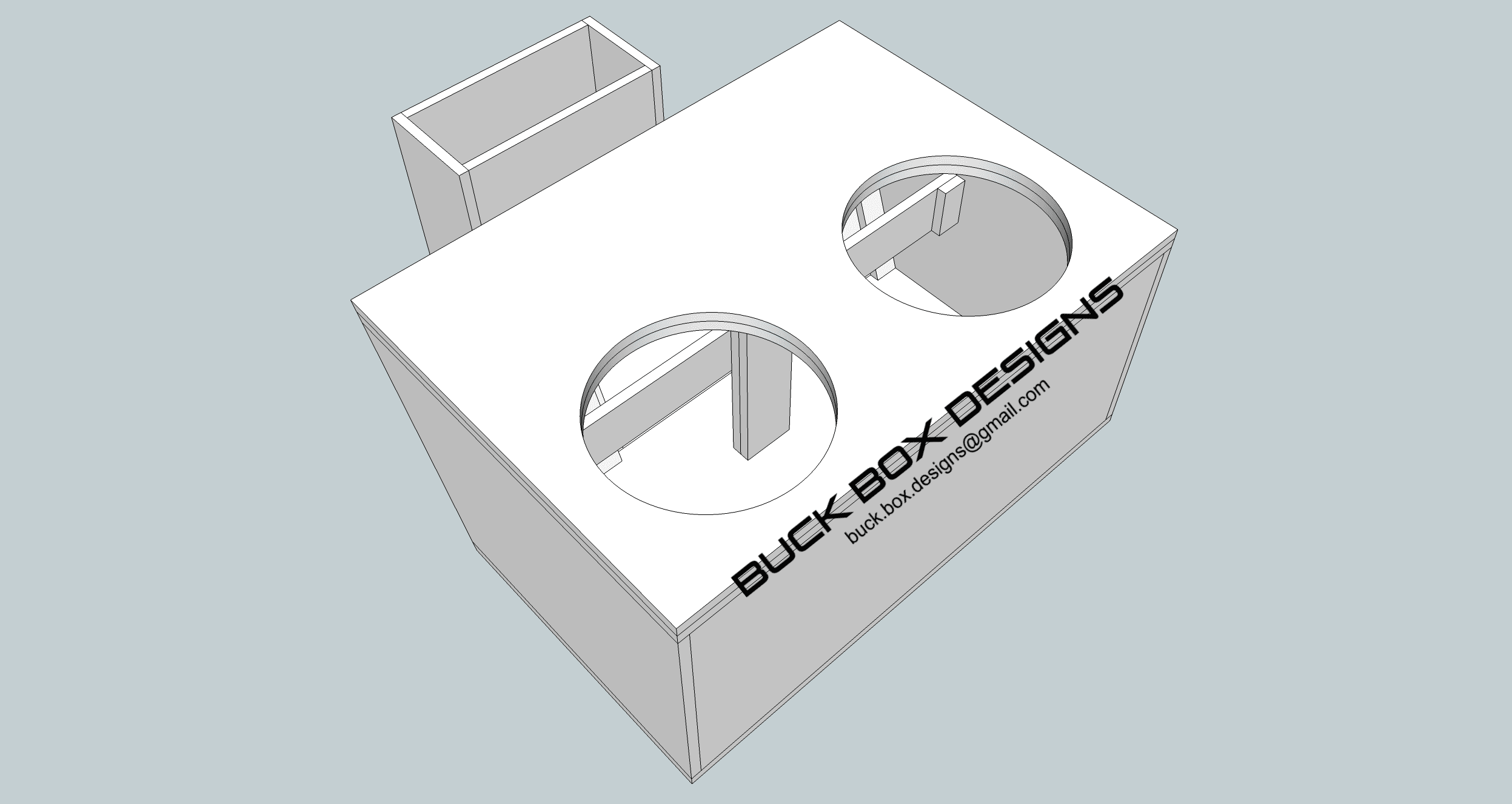

This one was for 2 DD 715's. It never got built because the owner changed his mind about what he wanted to do. I really wanted to see this one playing.

^^^In that box, the whole top of the box is about level with the top of the rear deck (he was going to add a flush mount extra top baffle that conformed to the doors). The port was detachable/made as a separated piece, and he was going to make a mount to secure the port on the bottom of the rear deck. This port came out basically in the center of the rear deck, iirc.
It stinks customer never built this; he did and I did a TON of measuring and back and forth to get this layout, and it's very specific. Oh well. It was fun to design and challenging.
A box like that acts better than just a ported box. Using the rear deck/window shape, along with using the baffle of the sub box and the roof, this type of enclosure should pressurize the cabin very well. You could even fire the subs forward, and do some horn math; it would be loose horn math, unless you made a wall. It's all about how much work you want to put into it. The same style box can be done different ways in order to try and achieve different effects. I'd run the subs up and pressurize all of the port and sub air in between the roof and the top of the box, that'll be great loading.
