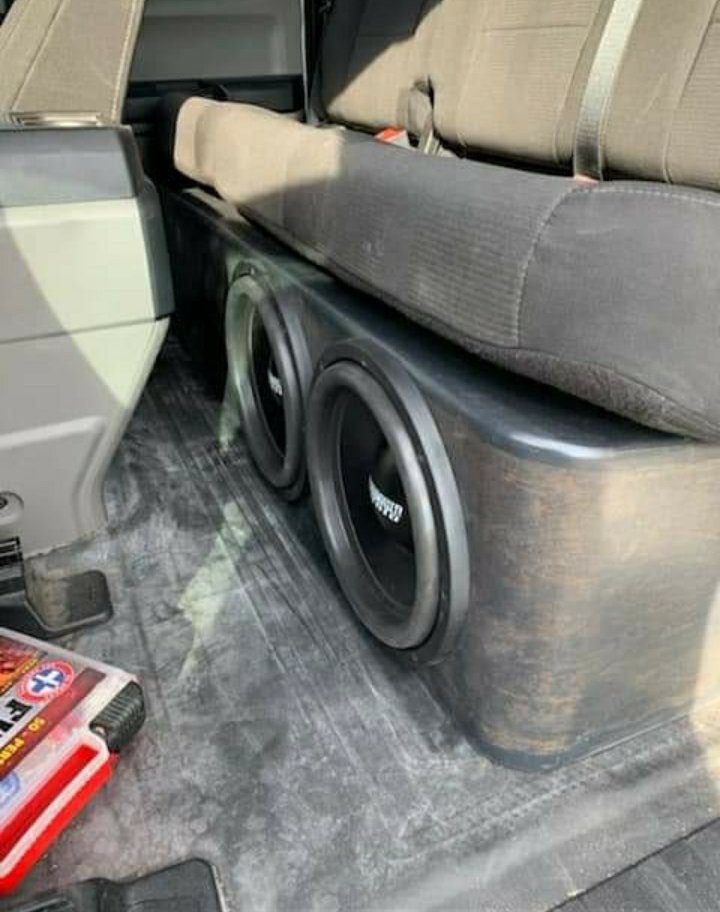

Btw the lmi welding seat lifts come with longer hooks in most cases and should bolt up to his short hooks even if you have to drill new bolt holes on the hooks that would solve that issue entirely. I had 2.5inch lmi lift with 1/2 inch steel bar under that and could front fire 10s ported at 3cubes at 36hz with dual 4inch aeros
I think that's starting to rub the surround on the floor during high xmax events. But it should work. You can't even do 1/2 inch spacers under the seat brackets. You should be able to use factory bolts.
Btw the lmi welding seat lifts come with longer hooks in most cases and should bolt up to his short hooks even if you have to drill new bolt holes on the hooks that would solve that issue entirely. I had 2.5inch lmi lift with 1/2 inch steel bar under that and could front fire 10s ported at 3cubes at 36hz with dual 4inch aerosView attachment 44143
That's a dope box!
