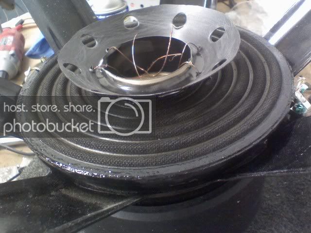

Well I had a 19Ov2 that needed are recone because the tinsel lead broke right next to the VoiceCoil.
I found out that it would be a little cheaper to have PSI do the recone and I figured it would be cool having custom parts instead of the regular eD parts.

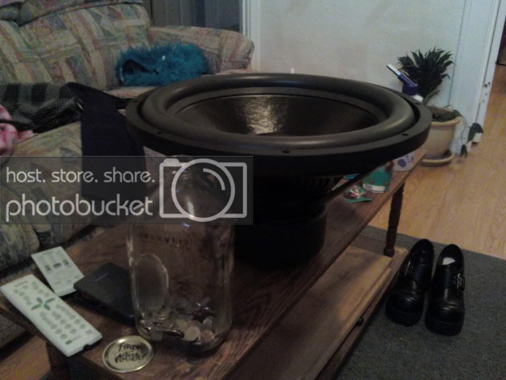

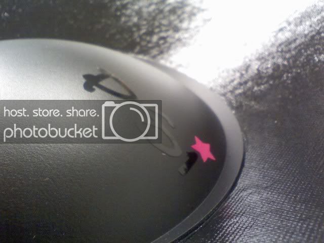

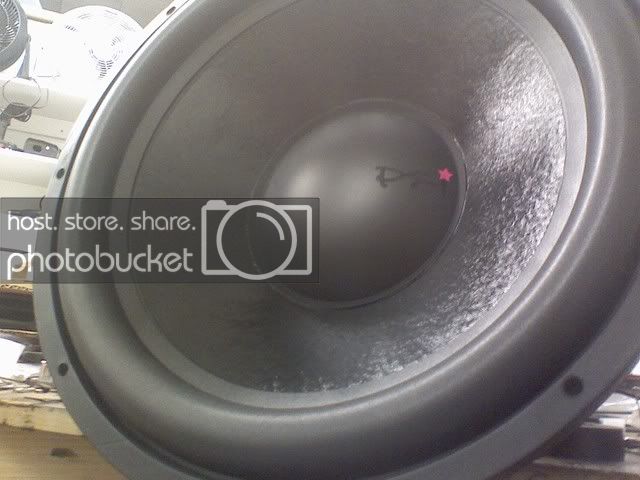

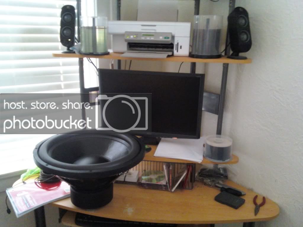

Well after some time I finally got it sent in and reconed. This sub looks so nice. I really like the TeamPSI emblem on the dustcap and I cannot wait to try this sub out.
Here are some pics before I start asking questions....

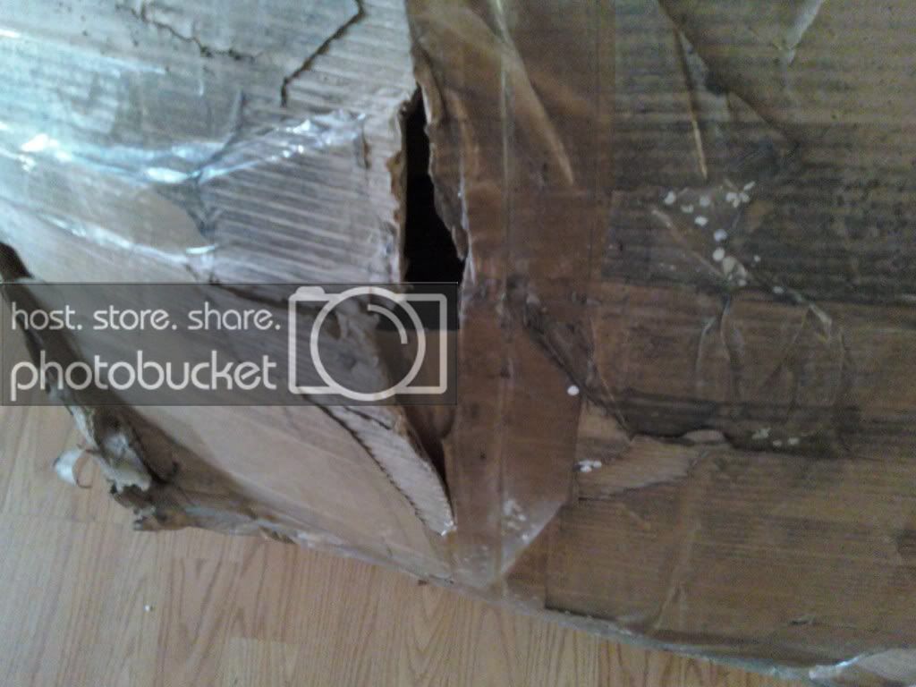

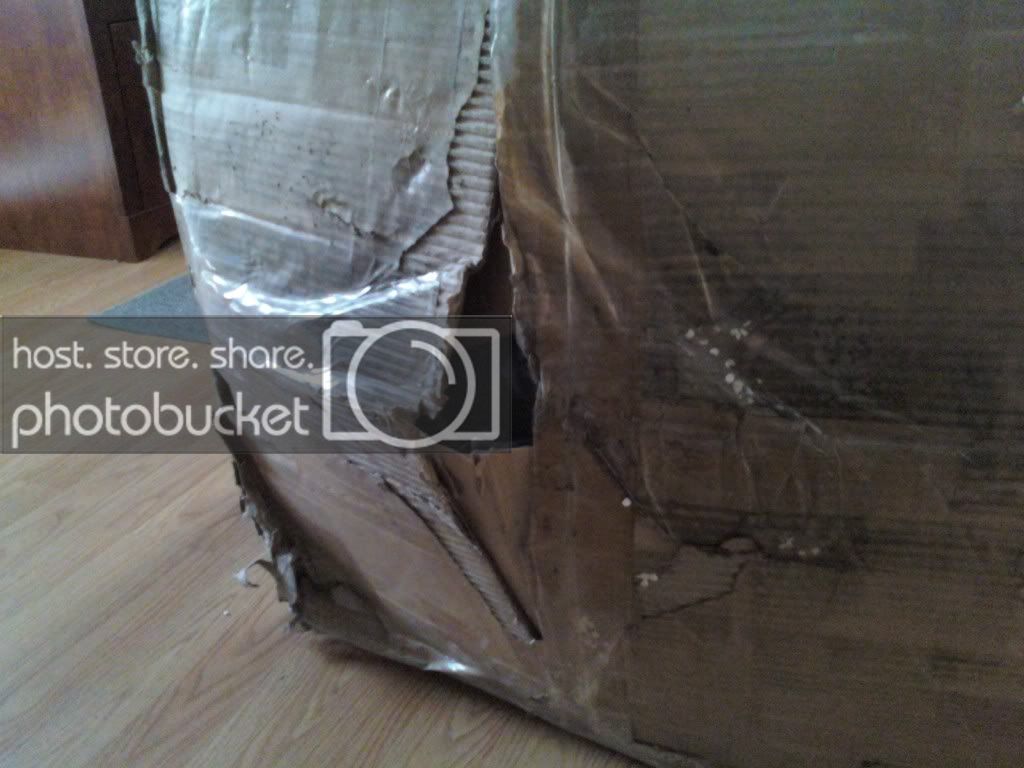

Well when I got my sub in from FedEx the box looked like shit. It really scared me and I thought the sub was gonna be scratched up pretty bad on the magnet.
What happened was the Styrofoam at the bottom of the box broke and when the tape broke I guess FedEx decided they werent going to tape it all back up.
I took the sub out and it looks just fine, the magnet doesn't seem to have any scuffs on it. Also, the coils both read at around 2.2 and it is a D2....so that seems fine.
Now I know I am not supposed to push on the cone at all, but I was curious and pushed on the very middle just a little bit and it sounds like the coil is scratching.....

I haven't ever really had a problem with FedEx either. But the bottom of the box was sagging so bad when I got it.
I was kind of hoping the box had only gotten like that on the last delivery truck and that it hadn't been thrown around from city to city with the magnet protruding out of the bottom.

Wouldn't the motor have to take quite a hit to get misaligned?
Scraping wouldn't be cause by a shifted pole. If the pole shifted the cone would be completely locked up.
I'm in the middle of reconing a pair of 16ov2s myself, and I can tell you the gap is not particallarilly tight either. (You should be able to move the cone in and out by pushing on it with no scraping)
If the basket dosen't look like it's been bent up I'd say the coil was probably misalligned..
