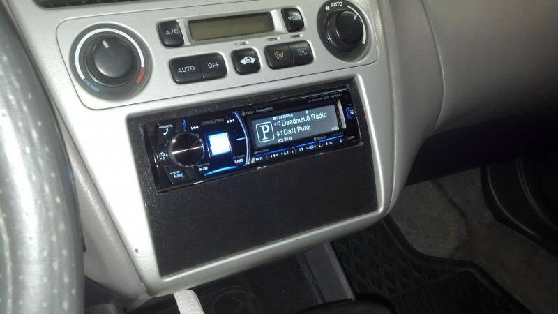

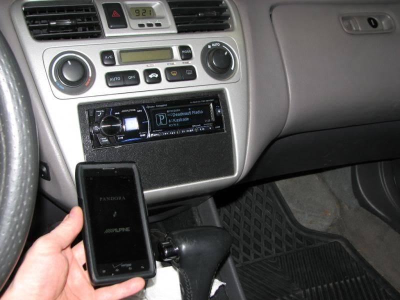

pics of the 149:
Pandora control through Android via BT
i am filling the extra space with meters in my car, then making a custom mount for it all that will have a stock appearance.
