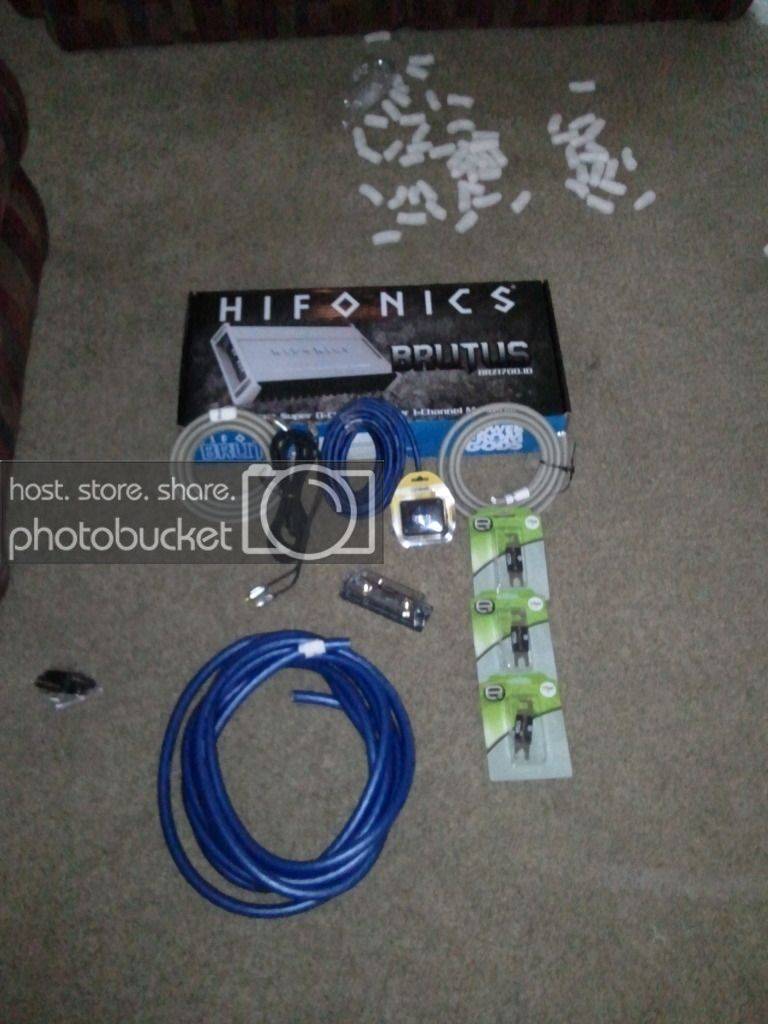

JL Audio G6600 6 Channel

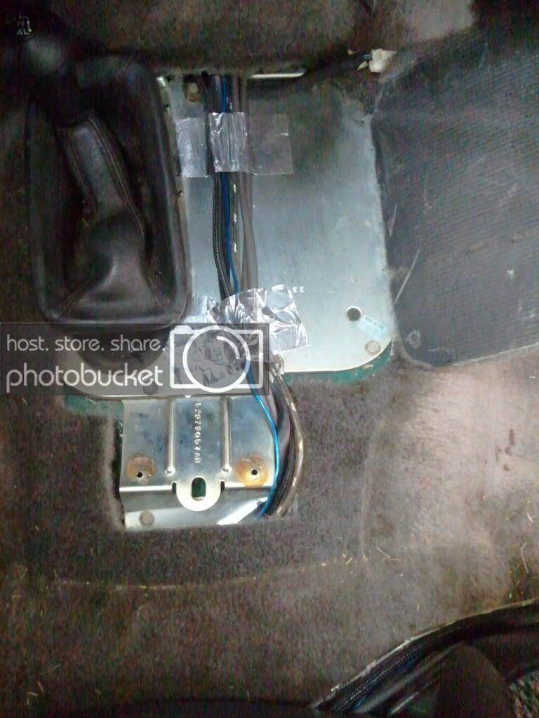

Wiring:
Kicker 1/0 for power and ground
Xscorpion flat 1/0 for Big 3
Kicker 12ga for sub

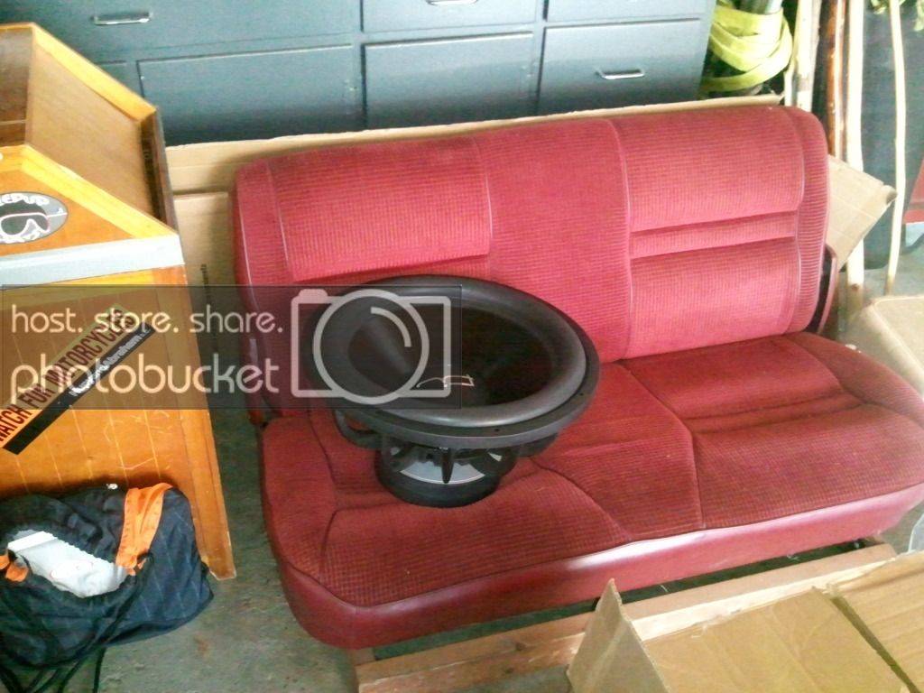

Sub:
Fi Audio BL 18 d2 fully loaded

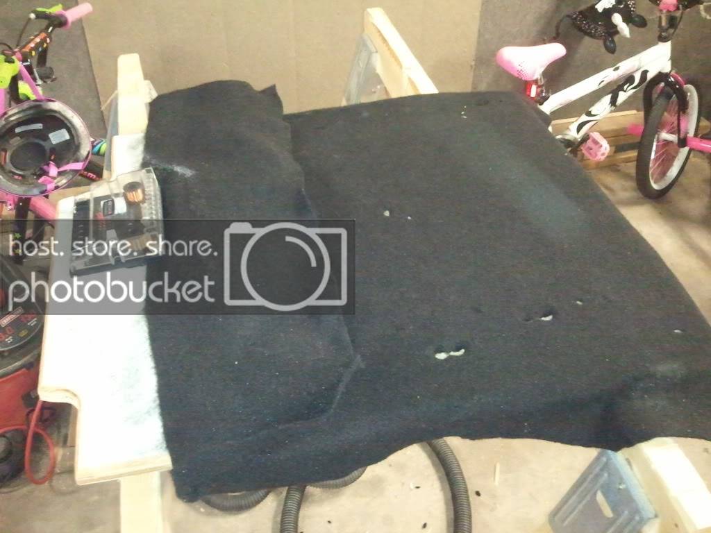

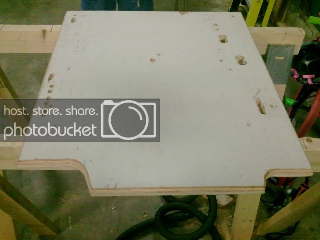

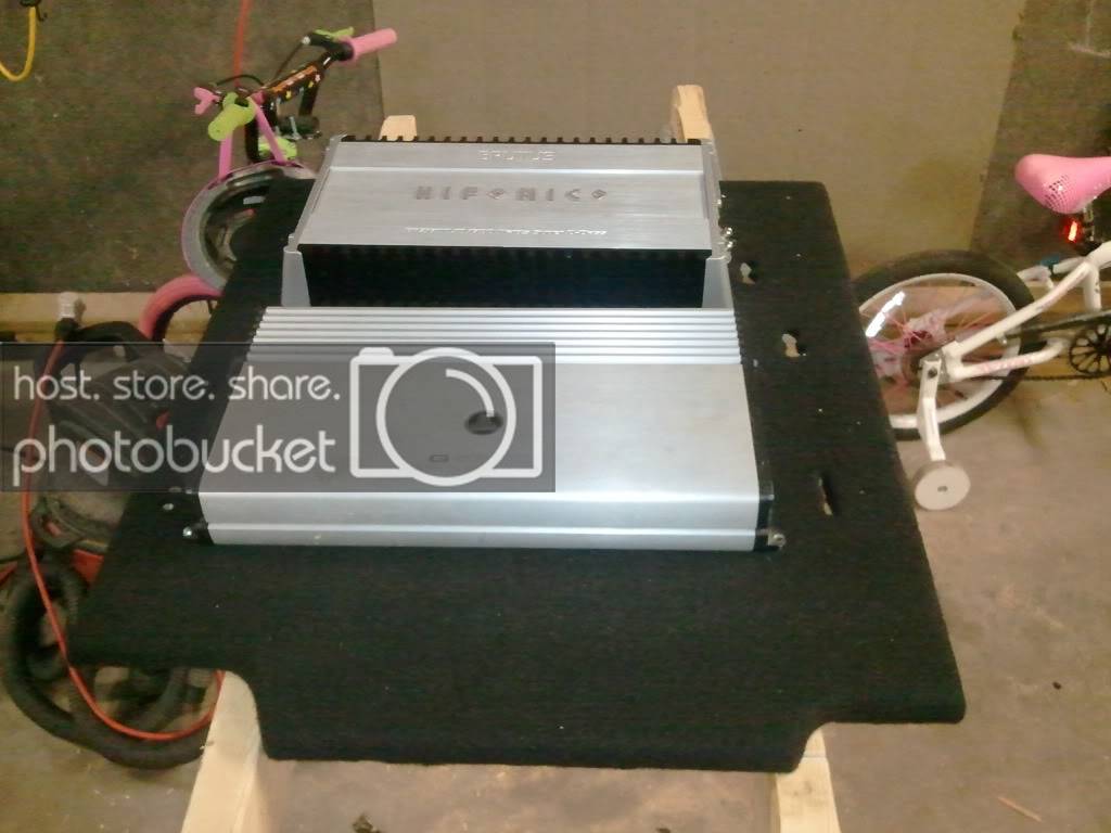

carpeted amp rack
From or made by keep_hope_alive

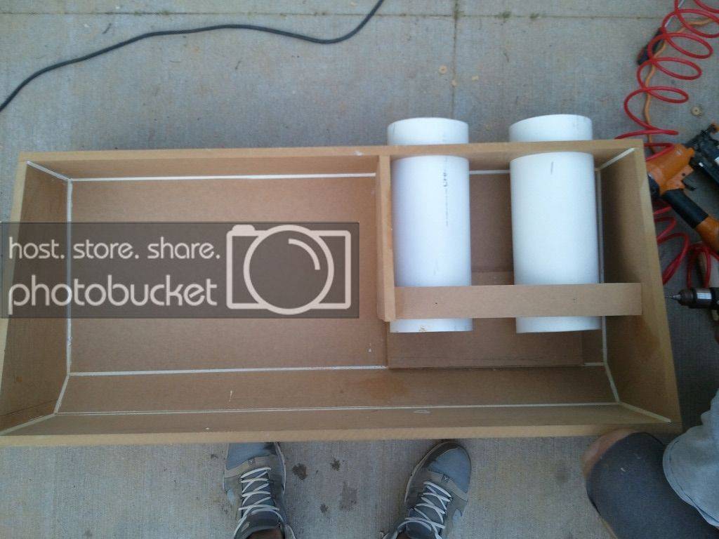

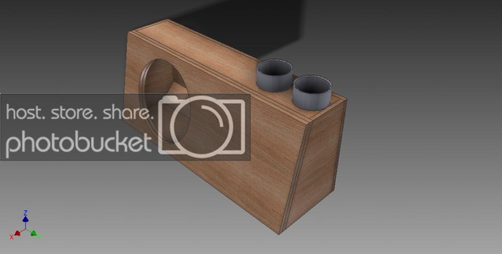

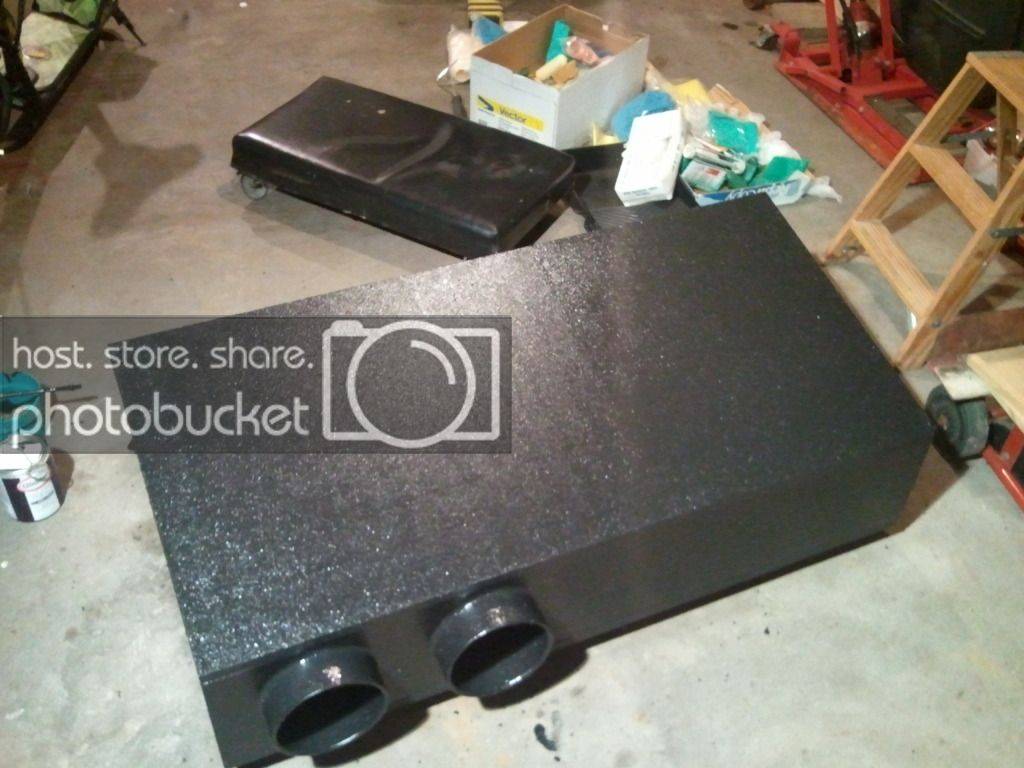

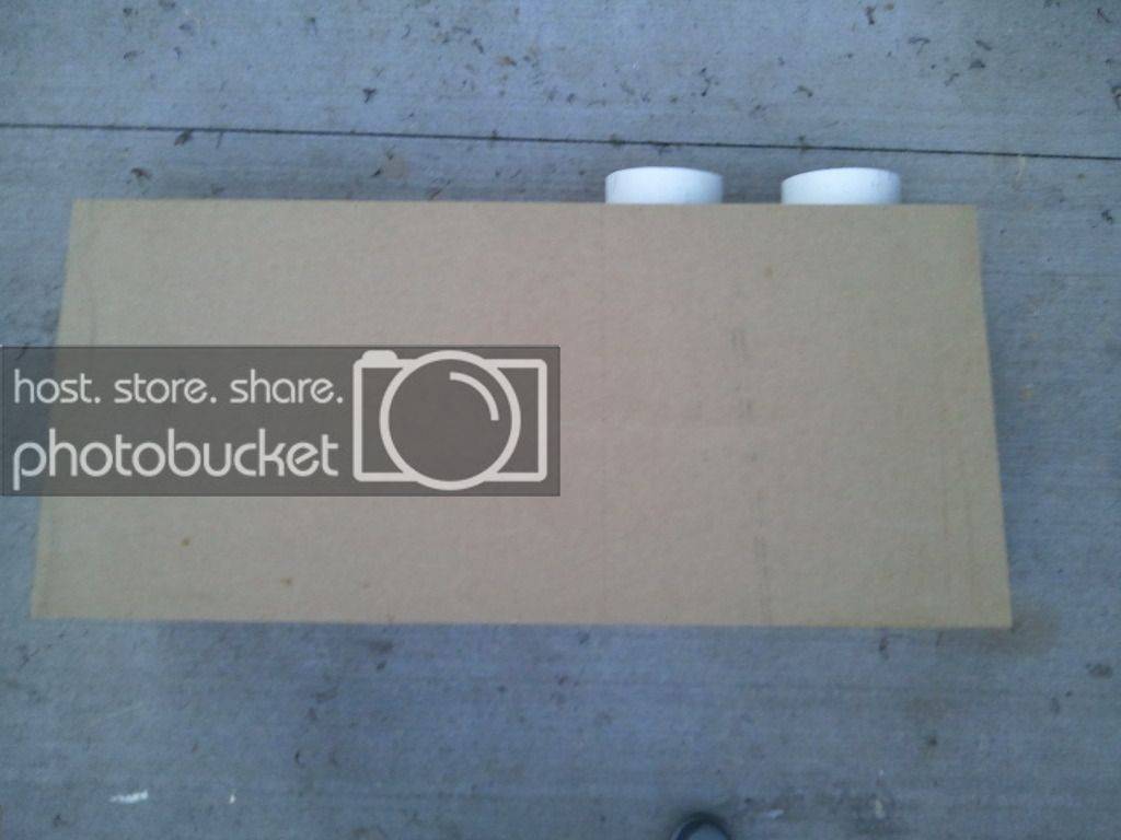

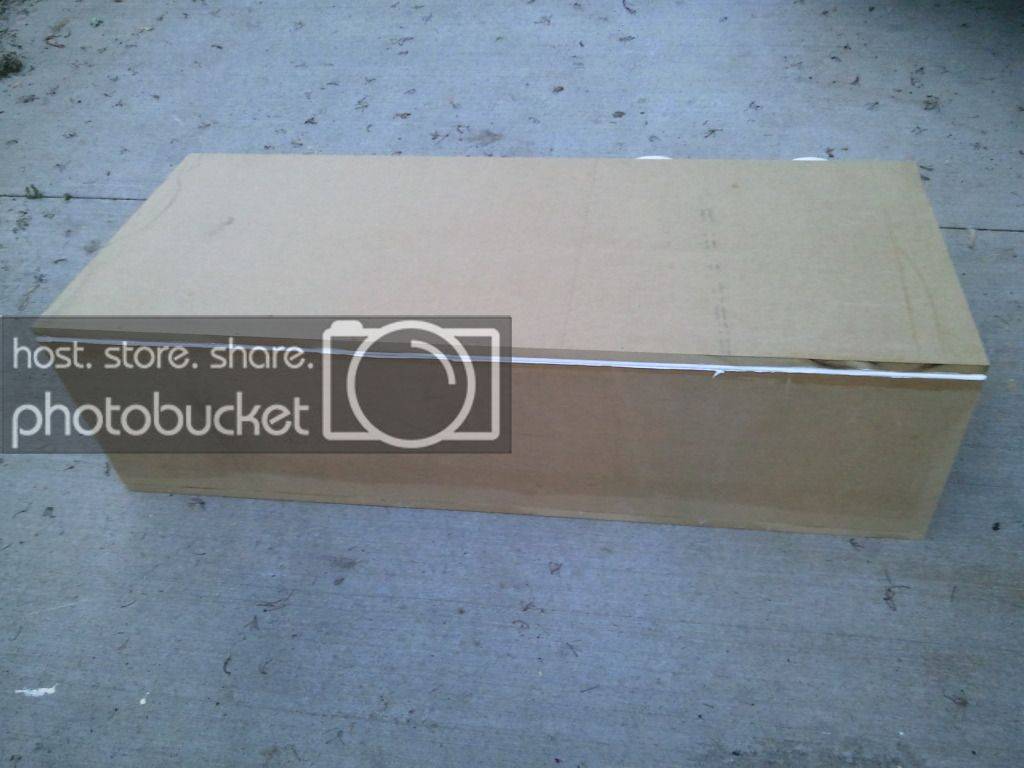

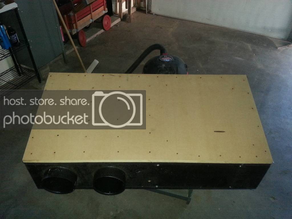

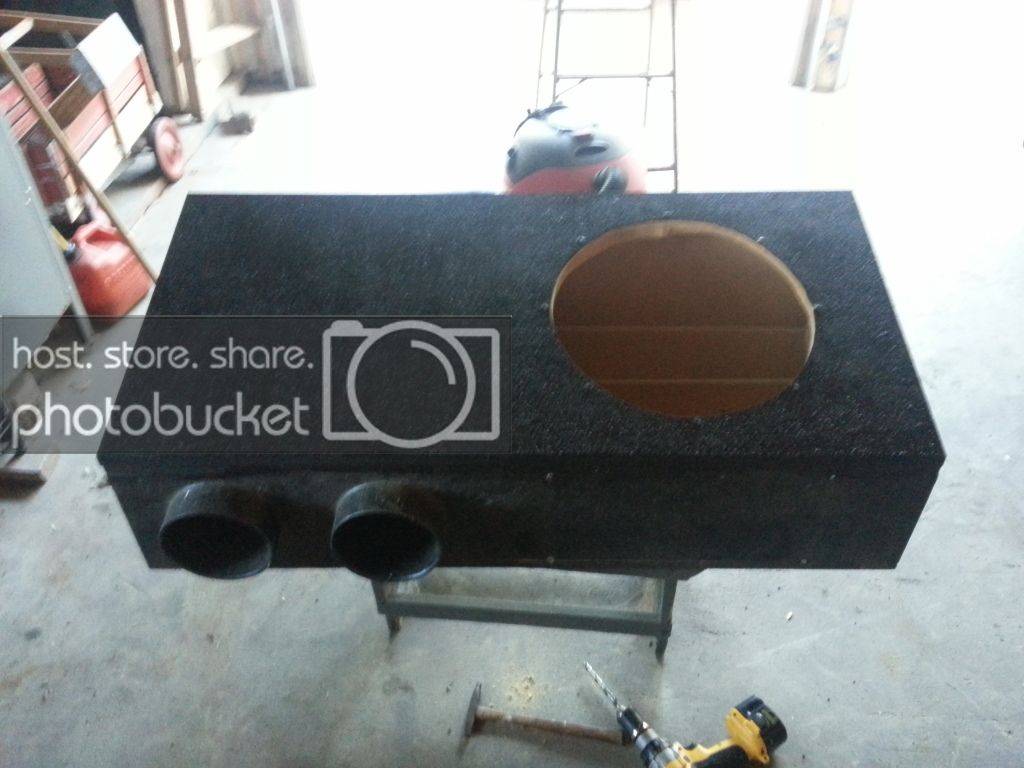

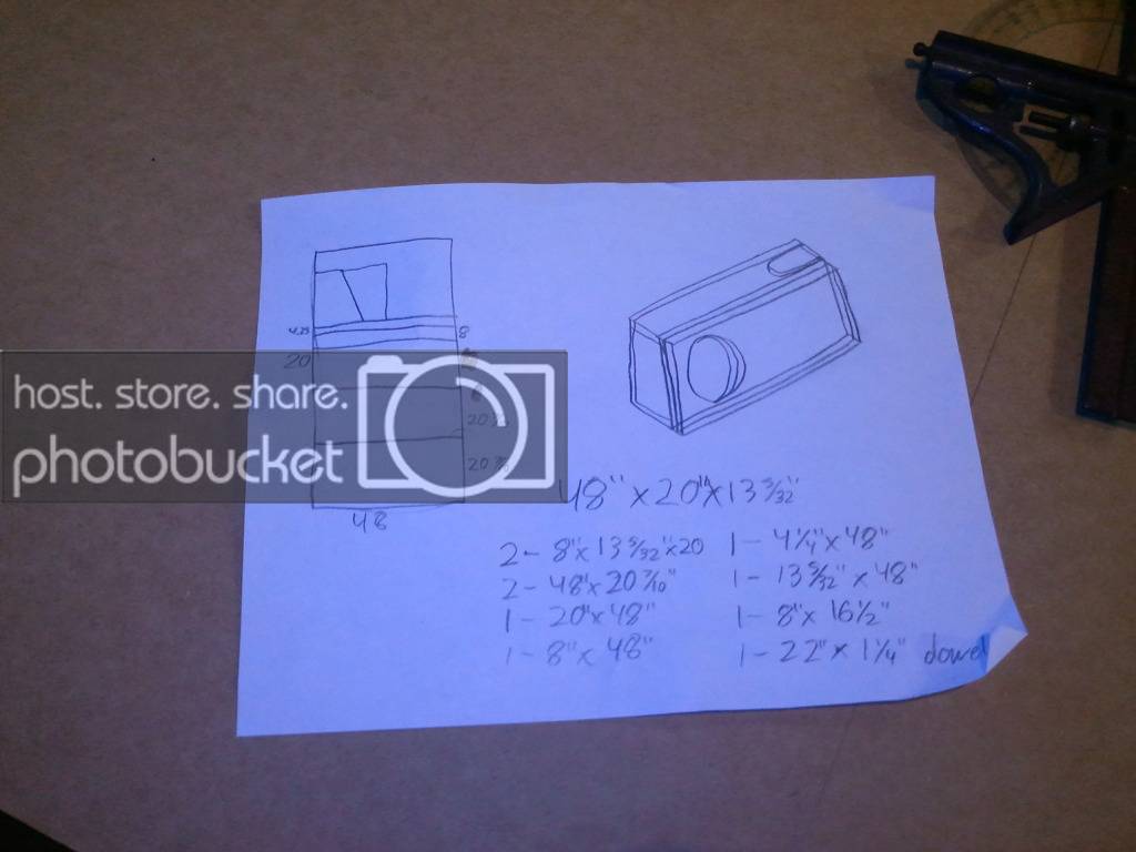

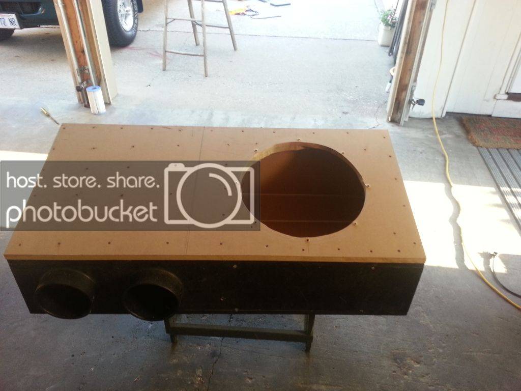

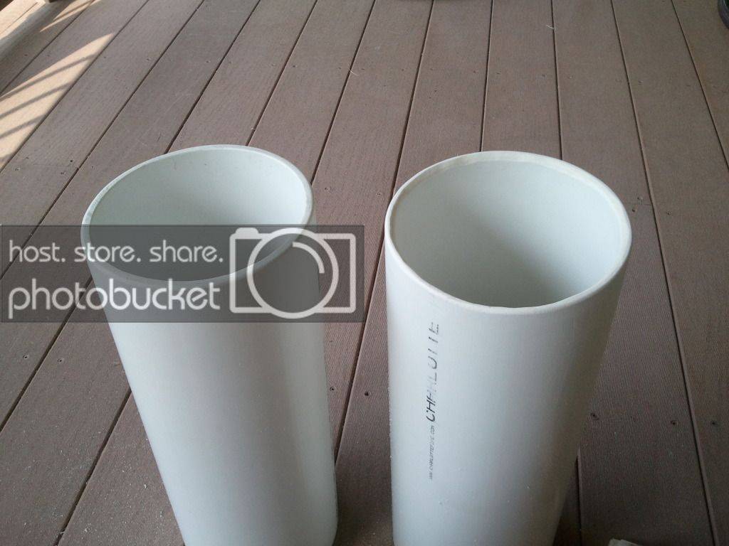

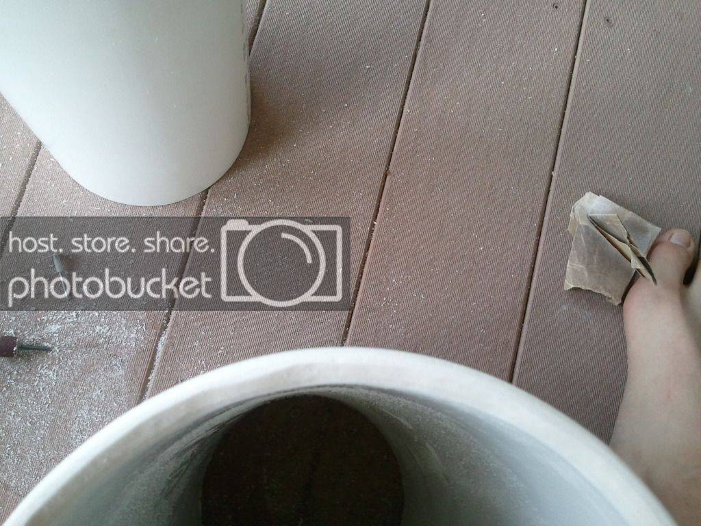

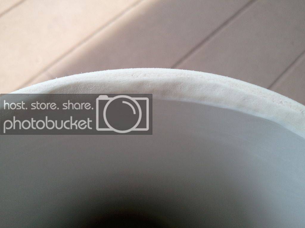

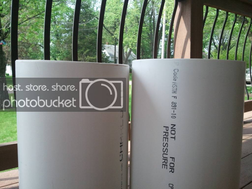

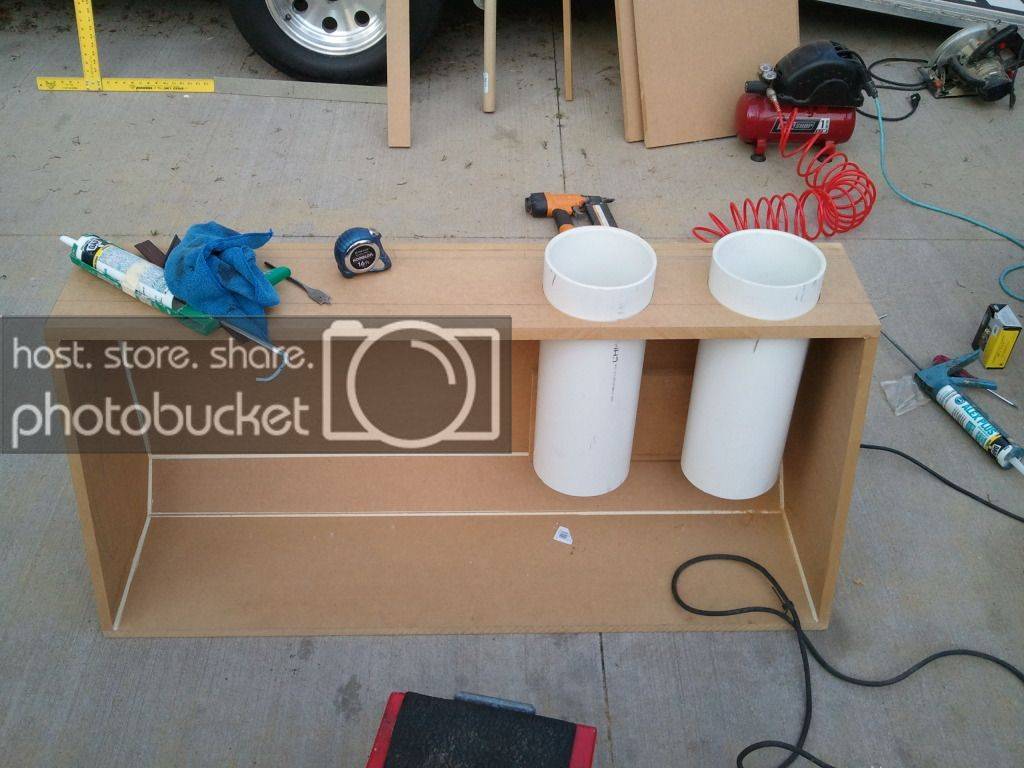

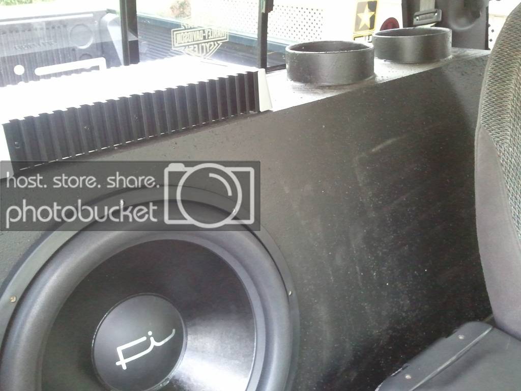

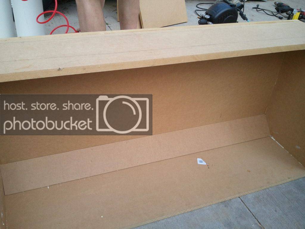

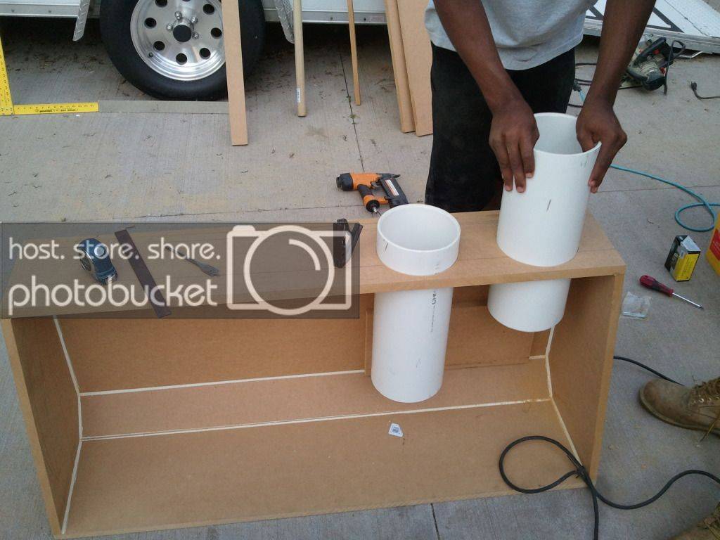

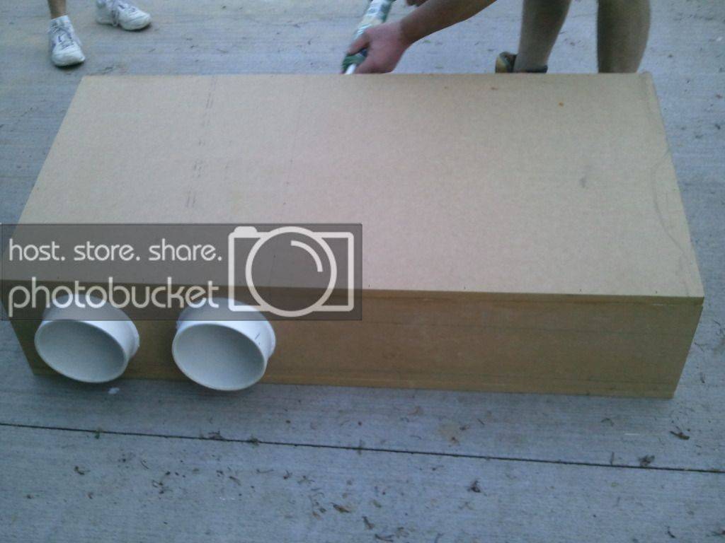

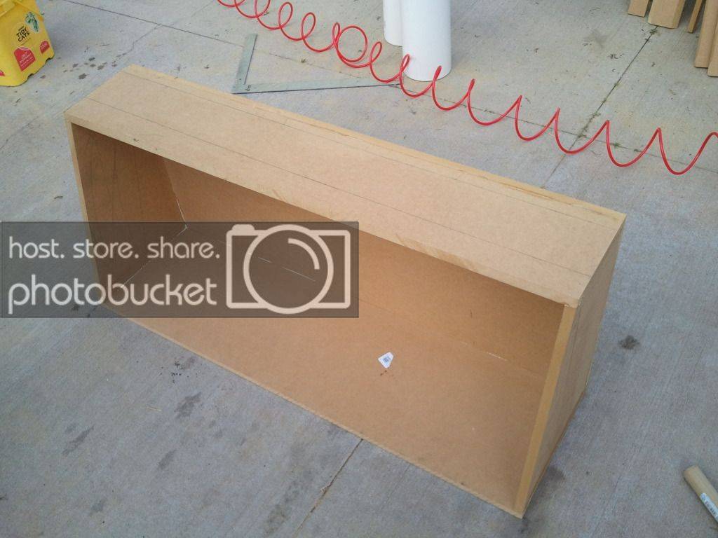

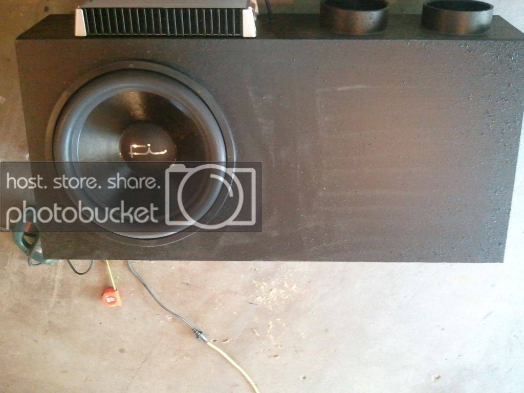

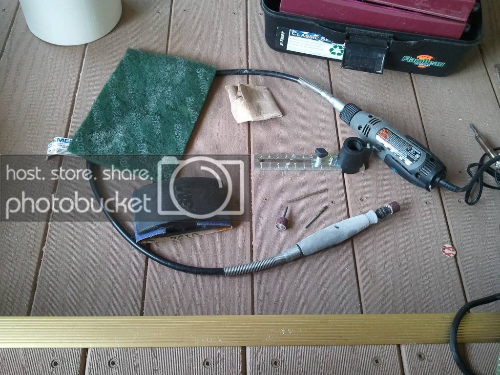

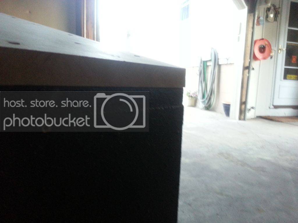

ports

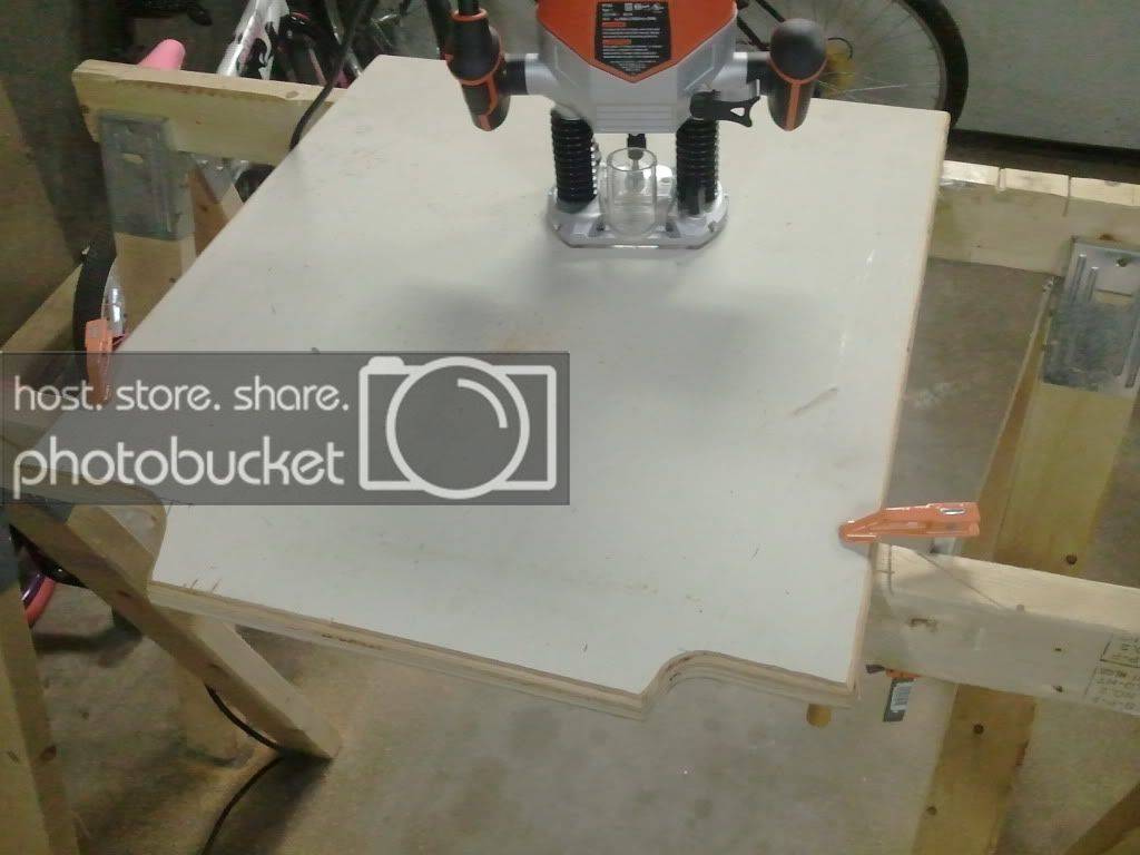

tools to sand ports

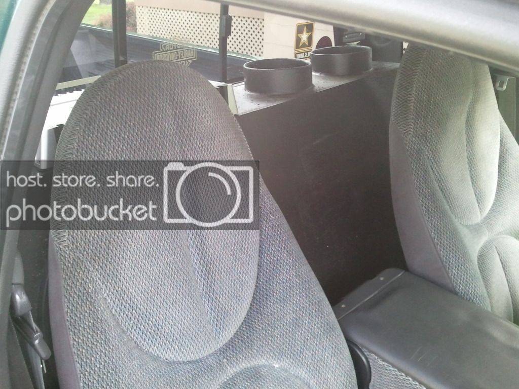

as of now that is the finished project minus a tweeter change and some tuning. it has been a great chance to learn some things good and bad. i cant explain how much help kha was to me. it would not have been done without him. hearing his car gave me a better appreciation for what sq really is. he inspired me to step this up a bit.

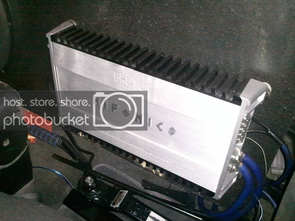

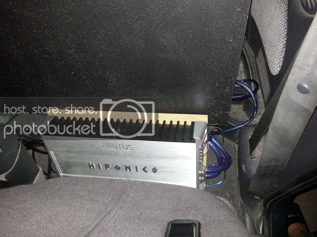

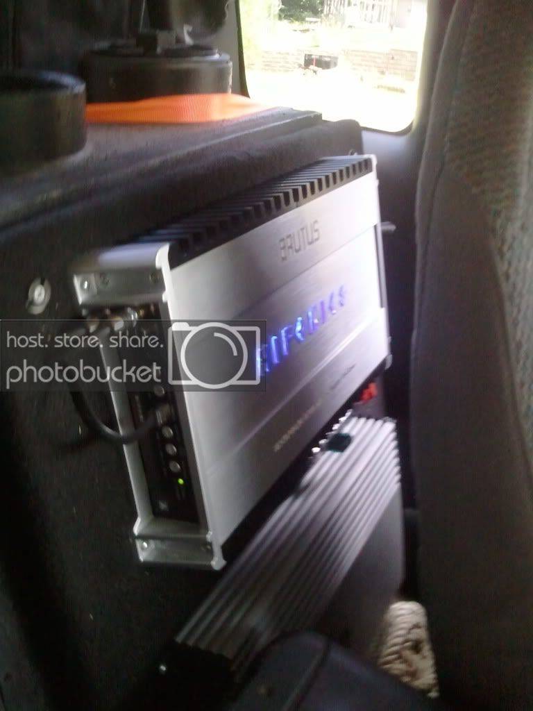

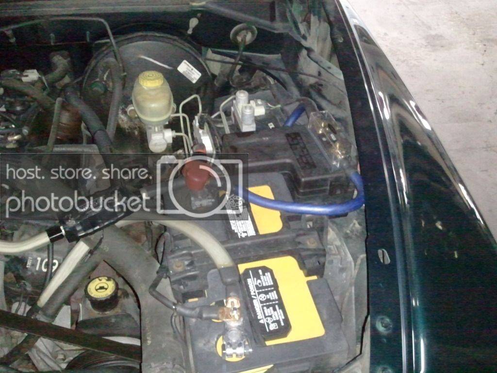

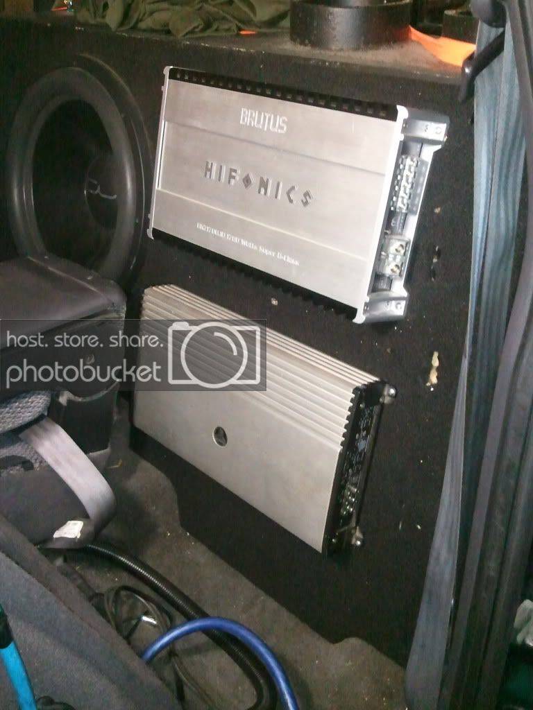

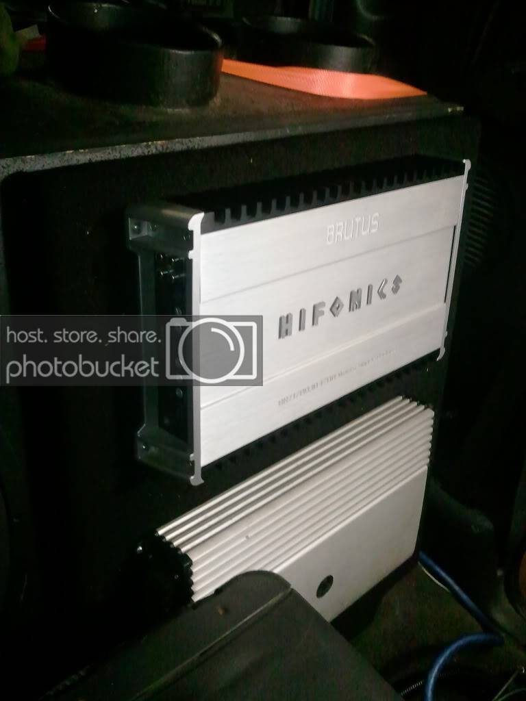

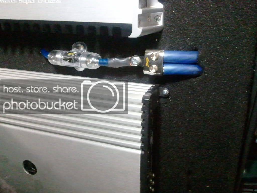

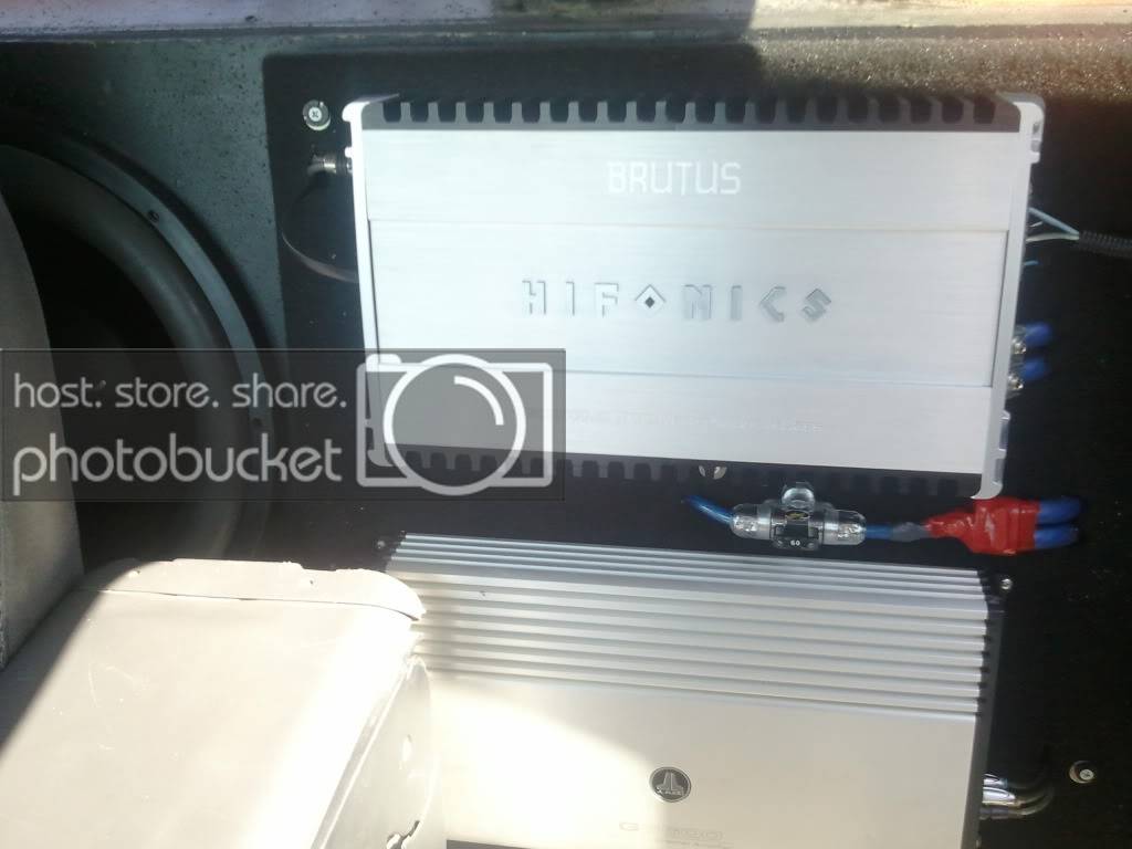

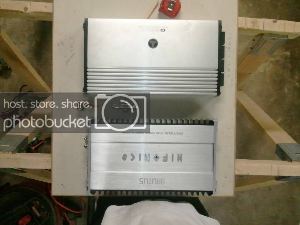

we used some rubber mounts (about 1/4" thick each) to gain space behind the amp rack and also absorb vibrations.

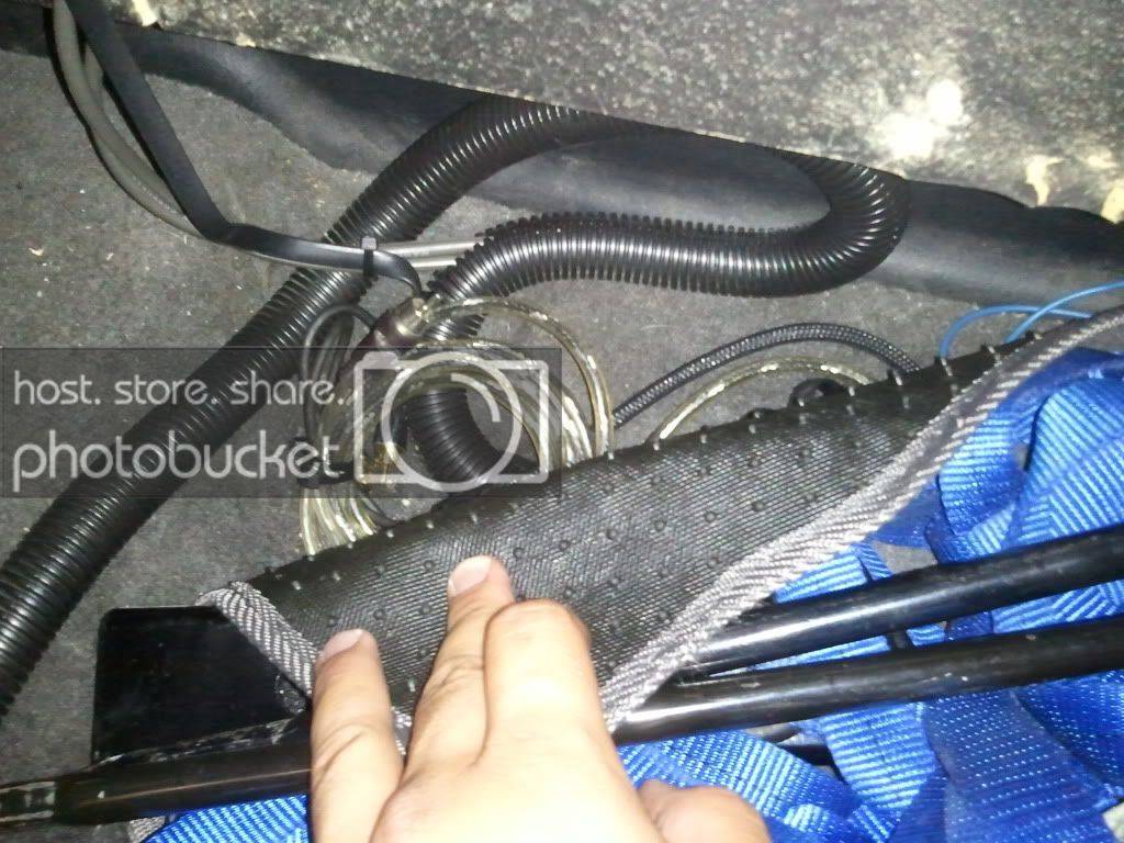

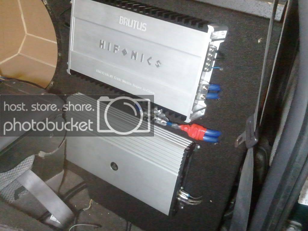

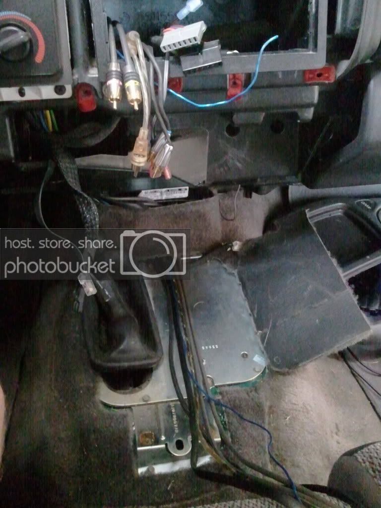

what this is:
we wanted to essentially tap the 1/0 power for the sub amp to feed the 6-channel. so this is a dual 1/0 connector with a short section of wire to a fuse holder to feed the G6600. once it was secure, i wrapped it with self-fusing silicone tape (rated to 1000V per layer).
