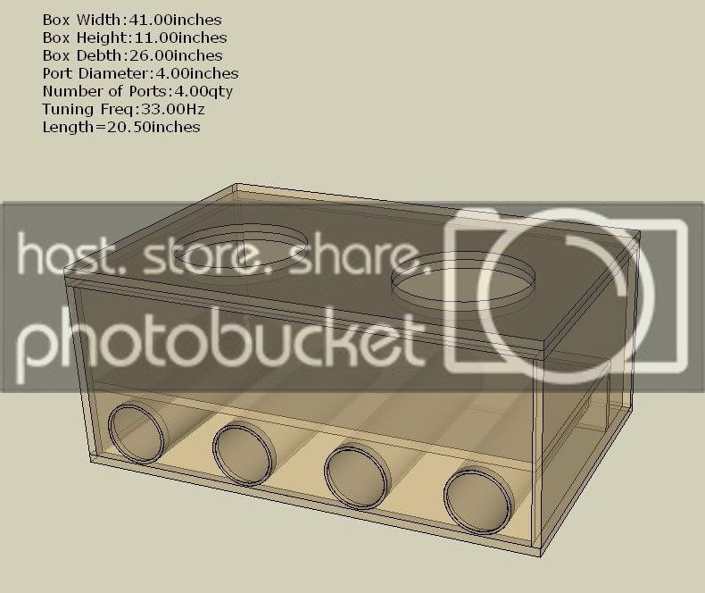

I will be putting a 15 inch FI bl in a 3.5 cubic foot box tuned to 32hz in a 1996 jeep cherokee. but i dont have the jeep with me as of now. i have everything else for my system ready to go , i just need the box and to get the truck from somones house. if anyone has a jeep that they could measure for me, or if you half already built a box for yours, then you might have some recomendations on how big to go with it. all recomendations are greatly apreciated, thanks. kevin
I have a 2000 cherokee and have built at least 4 different for for it.
the space I use is 41 x 18 x 26 max to fill the back compatment.
Here are a couple of designs I have built.
