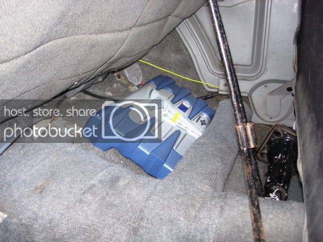

mm, it seemed really easy in my jeep, it's a 2 door. i ran the rca's right down through the dash and straight back on the passenger side under the carpet, hugging the center of the car..you can't see anything without taking off the dash piece. and grounded my amps underneath my back seats. in the 2 door models of cherokees (what i have), there are nice little holes in the base of the seats that you can run wire through, made my 1/0, speaker and rca wires very simple...not sure if it's the same with a 4 door though.
