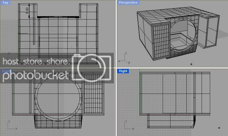

heres what i think will be the last design:*******: lol (yes i have said that a few times, i know)
once i get some money together i will be ordering the bl. i was suppose to be in vegas yesterday but didnt get that far east...so i wasnt able to pay a visit to the fi store
its 6.4 after port/sub displacement and is tuned to 35 hz with 93^2" of port.
sorry for the 7 pages and no actual build pics yet:laugh: atleast i now have a somewhat normal looking box thatshould fit/function well:)...i would be pretty retarted to just assume an 18 would fit in my trunk without planning ahead..
anyways heres the pic
