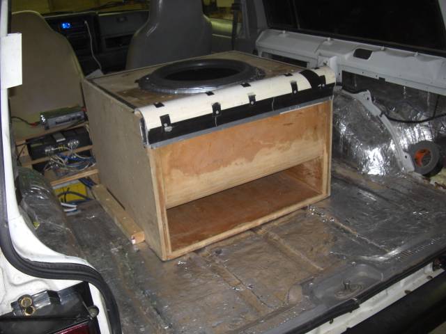

I am going to track my gains from here... so far 156.1 dB @ 53 Hz with the new Nightshade v.2 15" woofer in the Jeep with two SAZ-4500Ds on it, each at 0.25 ohms DCR.
Electrical consists of six Stinger SPV-70 Batteries and an Excessive Amperage 225-amp alternator.
Sorry -- no power clamp results yet... someone is borrowing my clamp and I cannot get in touch with them to get it back.
A few pictures of how it sits now :
I am going to track any changes that I make that gain SPL. I plan to change the batteries to stronger SP-1700s and do a few other things... perhaps try a different box as this one is 3 years old now //content.invisioncic.com/y282845/emoticons/smile.gif.1ebc41e1811405b213edfc4622c41e27.gif

If I had a second woofer I would, I currently only have one NS v.2 motor to play with... my dual sub box peaks @ 47 Hz.
My single box peaks @ 53 hz so that is where it will stay for this testing.

If you have seen / heard / read about the v.1 Nightshade this is alot like the v.1 except with significantly higher thermal power handling and lower distortion due to more linear stroke and significant steps to create linear / reduced inductance.
I don't do much else in my Jeep except SPL burps since every time I play music I tear up the vehicle -- I'd like to reach my SPL goal before destroying the Jeep after all //content.invisioncic.com/y282845/emoticons/smile.gif.1ebc41e1811405b213edfc4622c41e27.gif Although, I have bass raced 149.9 with this box before with the "Monster" prototype which is a dB quieter and handles less power than the v.2 Nightshade... rewired the amps at 1 ohm each.
