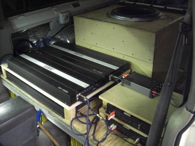

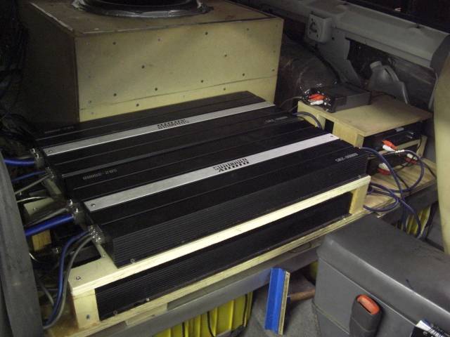

Ready to do some testing after lunch!

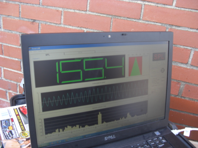

We will see if I gain extra SPL even after the additional impedance rise of running these 3500s @ 0.5 vs the 4500s @ 0.25
The coils are an actual Dual 1.0 DCR coil -- not a 0.7 -- so I am writing actual DCR not Z.
Not quite as loud -- my rise is pretty high so I lost power with more amps at a higher load:
My rise is usually 3x or so.
Now... if I had four 4500s I think it would be another story... unfortunately they sold out and not even I get to keep some.
Next step... go back to the two 4500s and swap to my Stinger SP-1700s. Also planning to put some of my interior back in... I suspect my Jeep was louder with the plastic side panels in... but I removed them for my dampener log.
hey Jacob, if you have time, try to remove all that stuff from the front of the box, leave just the bats and put one amp on each side of the box
