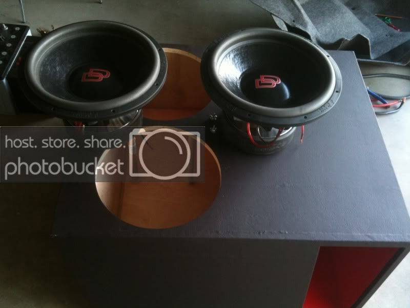

Decided to go with 2 DD 9515g's strapped to two Sundown SAZ-3500d. All the equipment will be in the trunk.

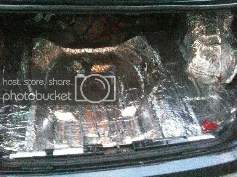

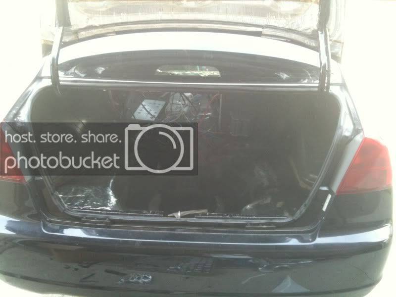

Empty trunk
50sq feet of AudioTechnix 60mil

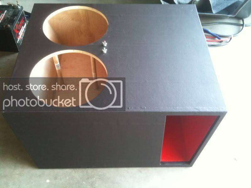

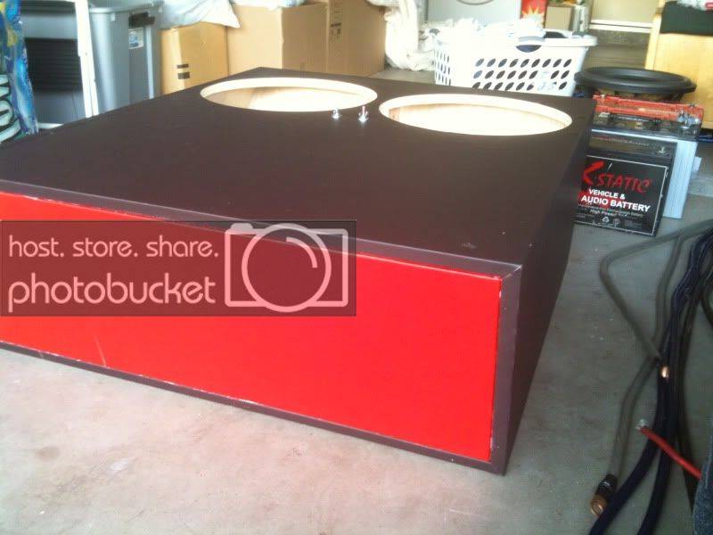

Gross Volume 8 cubic feet, Net volume 6 cubic feet. Designed the box myself. Biggest box I could possibly fit in my trunk. Port will be facing inside the cabin.

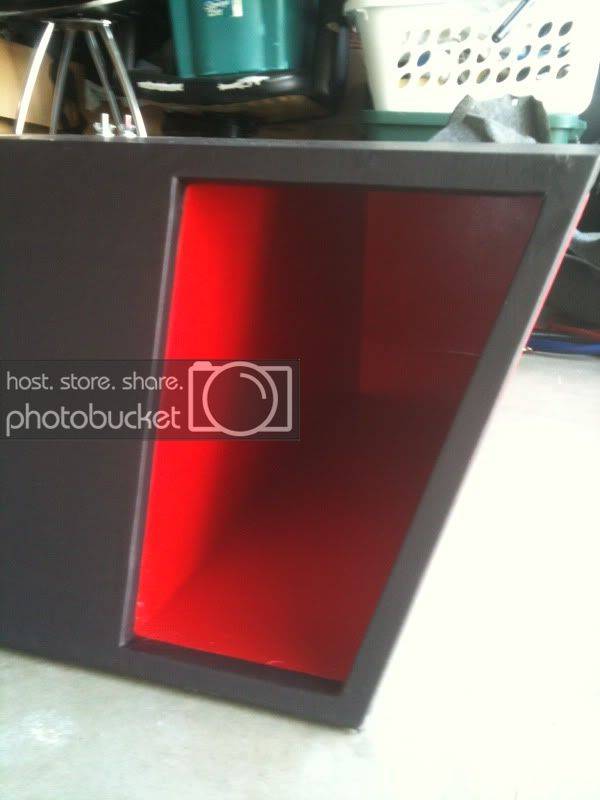

Looks great, why did you choose to not seal off the trunk and fire into the cabin? Thats the best way to get loud with a trunk. You will gain output if you can get a 45 in the corner of the port to direct the air more efficiently.
The port will be facing into the cabin, the box is only 13.5" tall so the only option was to have the subs facing up. The port wall that is angled is whats going against the folding seats.

not sure if its smaller then my civic's trunk but if its anywhere close to it i'm sure you could fit 8 cubes. I would have done 2 8" external aero port into the cabin however I wanted to be able to fold the seats up. After port and sub displacement im right around 6 cubic feet.
