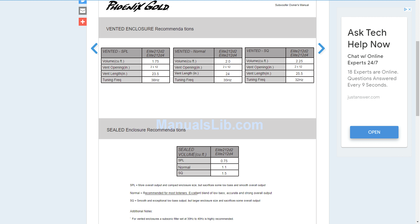

12inch Phoenix gold ti elite quick box q
Internal dimensions 40cmX40cmX53.5cm 2.25cuft of just the sub area excluding port and sub displacement
Port 5cmX40cmX82cm tuned to 32hz
I also rounded as much as I could port wise
I built a 2.25cuft the exact litres of the manual and tuning to the manual and it doesn’t sound As good as it did in a generic box I have but , I feel it can def be better as I had the sx which is rated at 400 rms and nearly half the Xmax excursion ,in my car before which sounded a hella lot better than the ti currently does
Offhand the enclosure itself looks fine, is it a more capable sub on the same power?
Sounds like azz? or just not as much output as you expected?
Check phase, HU settings etc.
You do have a quality signal going to the amp correct... not some cheapo Loc on a factory radio?
