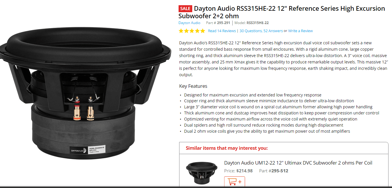

If you must run that 2 channel amp, just get any 12” woofer that you can afford, dual 2 ohm so that you can wire the sub in series (500@4ohms). The RF is decent enough but in my opinion they don’t compete well, as well in that price range crowded field as a lot of others, American Bass, NVX, any number of brands. Heck this Dayton is an awesome sub at $207.48 plus tax, sjhipped! 3” VC, 2+2 ohm 3”VC, 800 watts RMS in a 2.37 cubic foot box (15Hx15Dx24w), tuned to an f3 of 26Hz 88.1db, stellar!

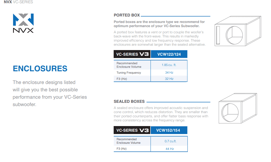

Or this NVX VCW122v3 12” Dual 2ohm sub is also a great, optimal sealed box volume: 0.85 cubic feet (.75lb stuffing) or optimal ported box volume: 1.85 cubic feet $209.00

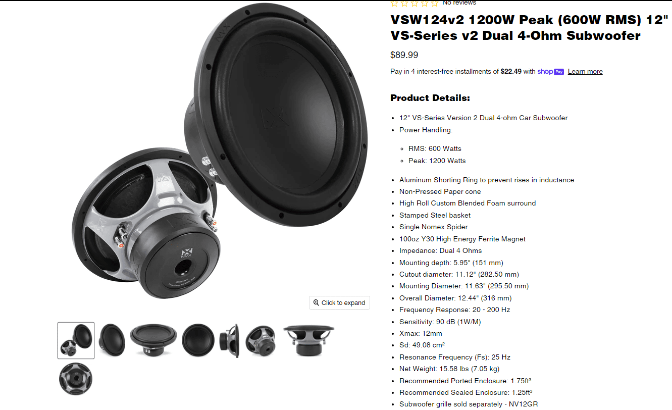

Or 2 of these in a 2.5 sealed enclsure, stuffed w/ 2lbs of polyfil for like $170.00 (Sonic elctronics) plus tax. Parker the basshead on youtube did a best under $100 (per sub) vid and agrees, hard to beat for SQ and overall value. I've used these in a sginle 1.25stuffed enclosure and they sound very good. They come in dual 2 or dual 4, you would want two dual 4 ohm units and you could wire the coils in series and the drivers in parlel to get to the 4ohm load. For sound quallity at 500watts, this would be my pick, especially for techno!
