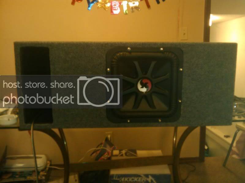

Wow, what a hot thread i got goin here! Kinda left me in the dark on my first box build, but oh well. To anyone who cares heres the final pic. Havent done the custom work yet.
wow finally some replies, I didnt carpet the sides because I plan on getting a speaker term. but wanna find one that takes 8ga. Then I gotta break out the sold. gun and do it right! Im doing some custom work with the carpet next weekend. Still have to get some alum. stock to make a grille for it because they dont make one for the x. Just finished it last night. I drive a truck, and havent been to my car for a few weeks but its getting installed in this weekend. Anyone know about how much itll run to get it checked(metered) at a local shop?

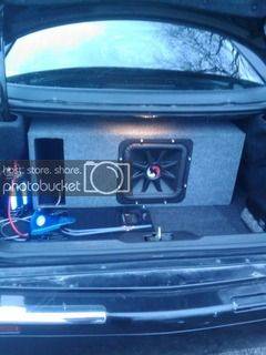

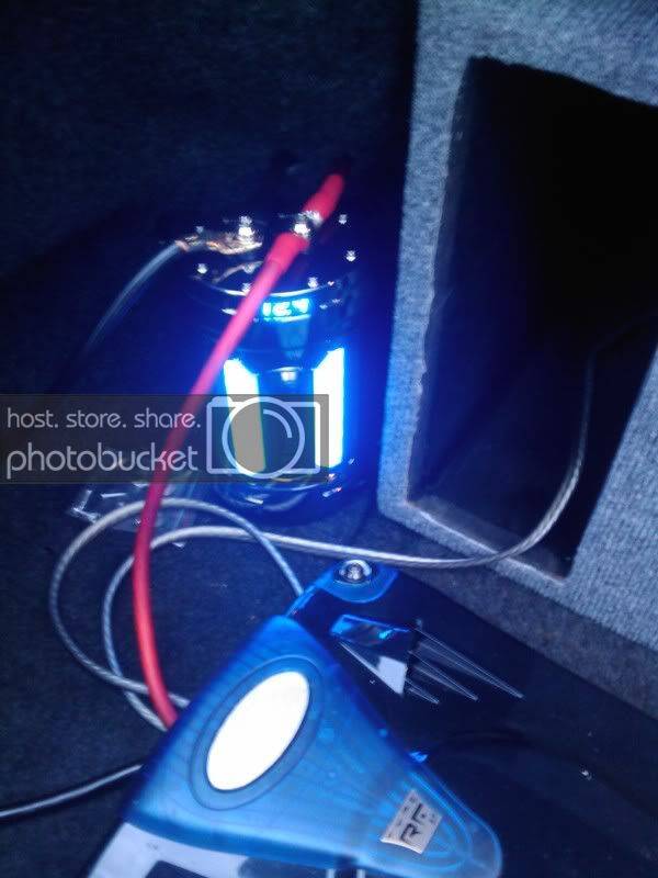

Got the x installed this weekend with my new cap, tried to hide all the wires xcept tha big uns. All I have to say about a 12" solo x is OMFG this thing hits hard in 3.25 cubes! I didn't even get two blocks from my house, and there goes the rear view swingin' by the compass wire. Got the wire terminals for the side this weekend and got my "x" design ready for the face of the carpet. Bought 3 lbs of polyfil from wally world for like $8, gonna try it out. Should be completed next weekend if the "X" does take too long to cut out. Looking like Im gonna have to upgrade to a bigger alt. The cap helped alot, runs steady at 13-13.5, but the volts are dippin down to like 11.75-12 when she wangs a long deep tone. Heh I think my single x is louder than my bro's 2 L7 12's. Plus I only have the gain @ about 80% and bass knob like a quarter up. Really surprised with the outcome of the box, also feels great knowing I made it! Guess the next step is to start dynomating the **** out of the trunk to get rid of all the new rattles this bad boy made in one weekend. Im gonna look at get some spl #'s in the next month or so. Well nuff said here's a few pics i got this morning b4 work.
why do you have everything mounted on the left side by the port? just cause you got the speaker wire running in the port?
Yea my only other option is to pull the spare out and put amp under there but I dont like that idea. The other side has my 12 disc cd changer, but Im going to end up relocating it, the bass is too much for it....hehehe Once I get the wire term. mounted on side and everything soldered, you wont even see the speaker wire the way Im going to run it. I wanted to mount amp on top of box but not enough room, theres like less than 1/8" between top of my box and 6x9.

So you have the gain almost all the way turned up. Yea I see that going well. If you have to do that you need a bigger amp. In all my set ups I have the gain at 1/2 or less. More power is better so u dont clip. Also ditch the cap get a battery. If the cap helps then you more less have problems with electrical. I suggest doing the big 3. Would help out more than that cap.
The box look ok I would get some terminals or do nut and bolt terminals as wire through port looks like trash
