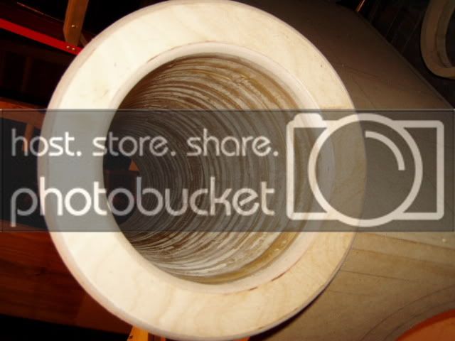

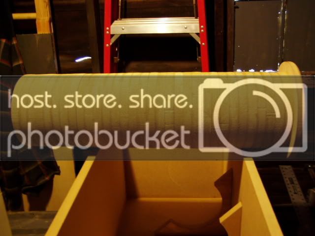

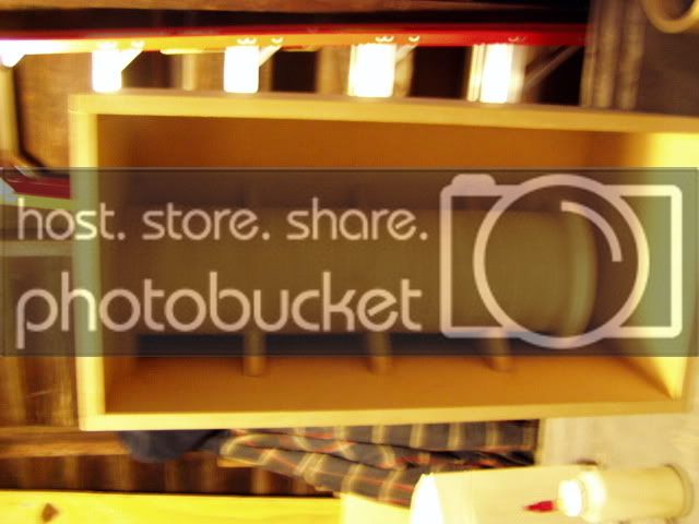

10" flared port buildup
The planned box will be 5.5 cubes tuned to 40 hz. Going in my 98 Jeep Grand Cherokee. The port is pretty **** big for 2 12's, I know. I might upgrade to a pair of 15's down the road. I haven't decided if I'm going to paint it yet. As long as it's smooth, I'm okay with it. SPL/bassrace ain't always pretty //content.invisioncic.com/y282845/emoticons/smile.gif.1ebc41e1811405b213edfc4622c41e27.gif If I do paint it, it'll be red
Awesome job man... looks good. I recently did something similar... but never thought to use bondo and wider rings to get a larger flare. Now I'm rethinking mine. Mine is only 6".
noice. Saw that on PWK. To get an even better flare, you could use different thickness of wood. Start with 3/4 then 1/2 and 1/4. I would still prefer a port like yours over a plastic one. Aeros and PSP ports are great but I like my ports to be solid with no vibrations. It was difficult to get a good flare instead of just an expansion but it came out pretty good. I still have to smooth it out a lot though, even on the outside. Time to bust out the belt sander.
I don't remember how thick mine is, but it doesn't vibrate and there is zero port noise. Its awesome. I'm definitely going to try something like you've done here, but for a larger sub soon.//content.invisioncic.com/y282845/emoticons/smile.gif.1ebc41e1811405b213edfc4622c41e27.gif
see for something like that....i guess its cool cause its different, but i would just fiberglass a sonotube or something... that had to take hourrrrrrrrrrrrrrrrrrrrrrs
Yeah, it took way too long for what it does. I had fun building it though, and it worked better than I had hoped it would.
