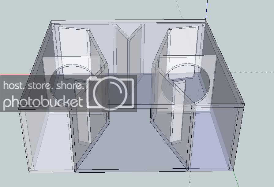

Box Design:
Will start build in the next few weeks, Goods haven't arrived yet, may start working on box though.
I measured the cu ft of the seal chambers. The sealed area is .785 cu ft
The QTC of the dayton 10inch HO is .728 in an enclosure sealed of that size so I'm thinking of mounting the subs in reverse (sub motor in the horn area) vs the typical install of this box which is sub mounted on the inside of the sealed area, but that would cut down on the volume of the sealed chamber and hurt the QTC more.
Of coarse I'm trying to keep the QTC as close to .707 as possible so .73 rounded isn't bad, it gets worse if I mount the sub in the sealed chamber.
Now this box is a dual bandpass folded horn, which is to say that there is 2 sealed chambers and 2 horns that share a mouth. I'm thinking keeping the sealed area as close to QTC as possible is going to improve my SQ.
Any thoughts?

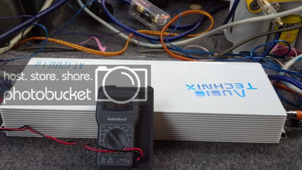

Just bought amp and subs, sticking with the 10" Dayton HO DVCs, switching amps though. Saving some money going with the Audio Technix 1200.1 d I know the sundown is probably a better amp, but the AT sure looks nice for the price it's at, I'ma take a small leap of faith really wanted to try their amps anyway. Should be arriving in the next couple weeks, I'll get to work on the enclosure this weekend.

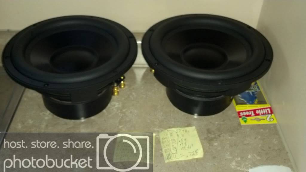

Subs arrived yesterday, Amp will arrive today, i'll post pics after work. Having to modify my box design so that it will fit into my trunk, so box will be completed this weekend. Excited to see the amp today when I get home.

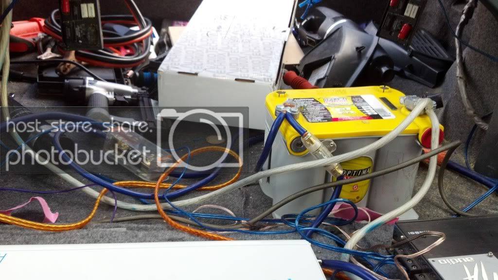

Marvel at my wonderous wiring! haha before you comment on it, I'm nowhere near done tucking wires bros, just setting everything up and testing.
BTW Noobz this is how to set your gains.

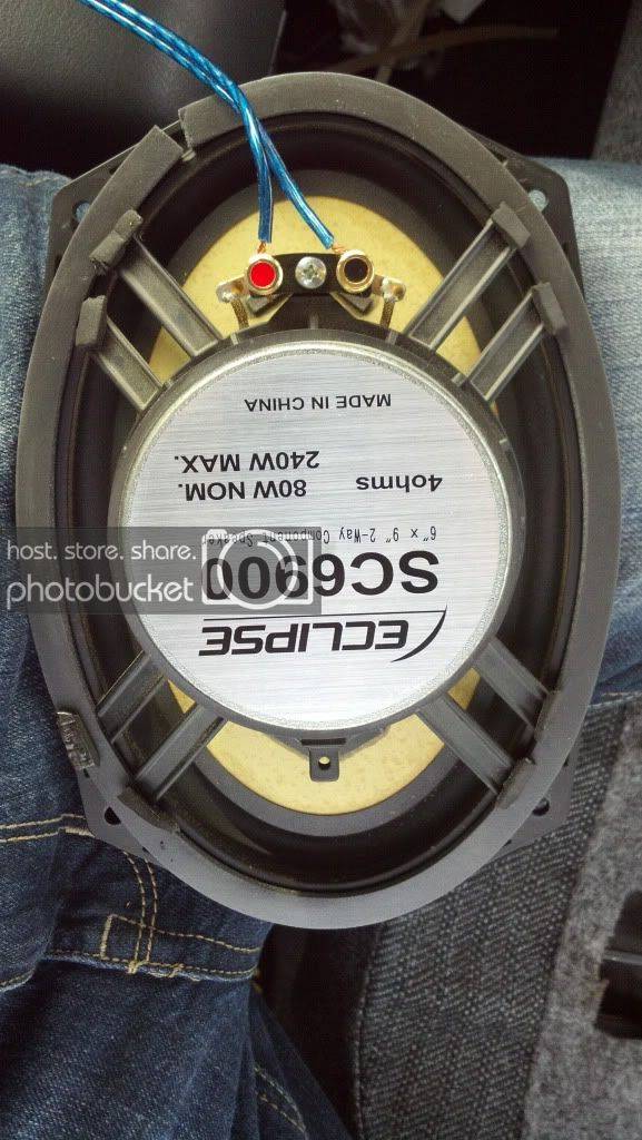

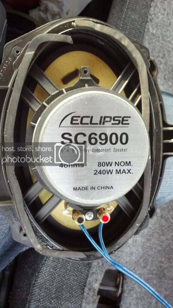

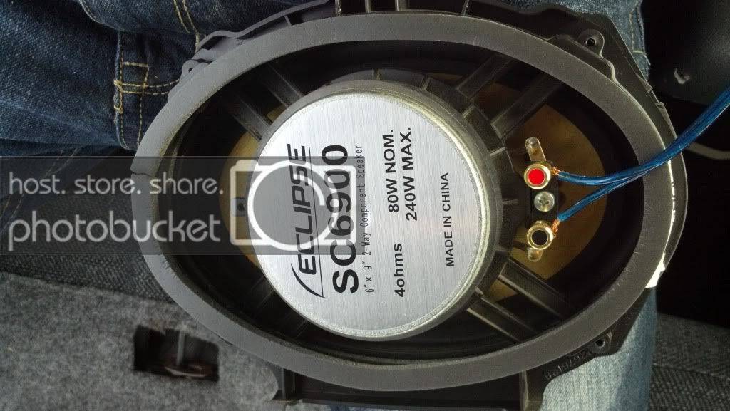

Since I had to work on my 6x9s the other day I might as well toss the picks up in here.
Before:
After:
Some of the best 5$ I spent at menards. After fixing rattle, and cancellation issues with some vinyl close cell midbass came shooting out of everywhere it wasn't before.
