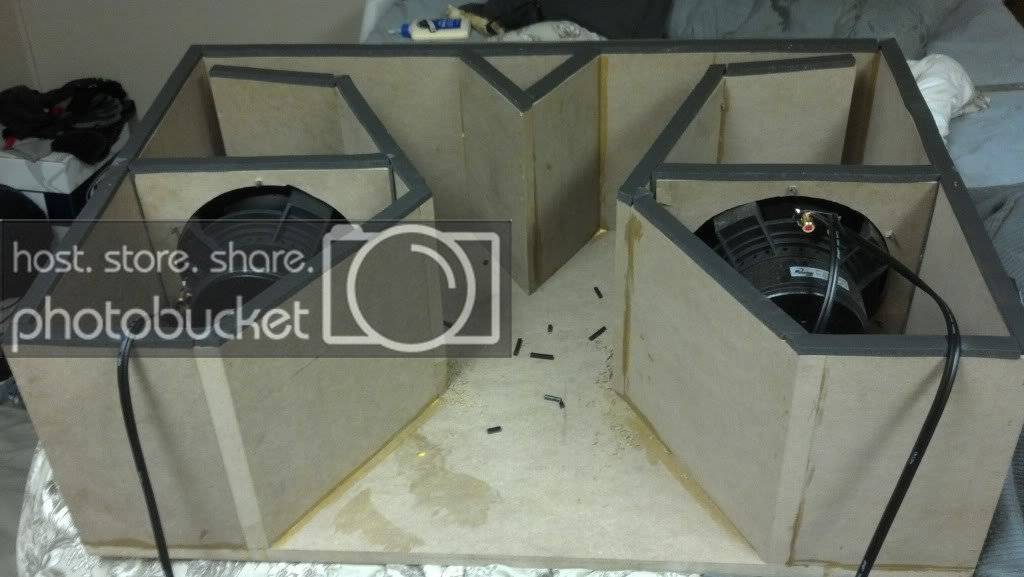

Close to finished

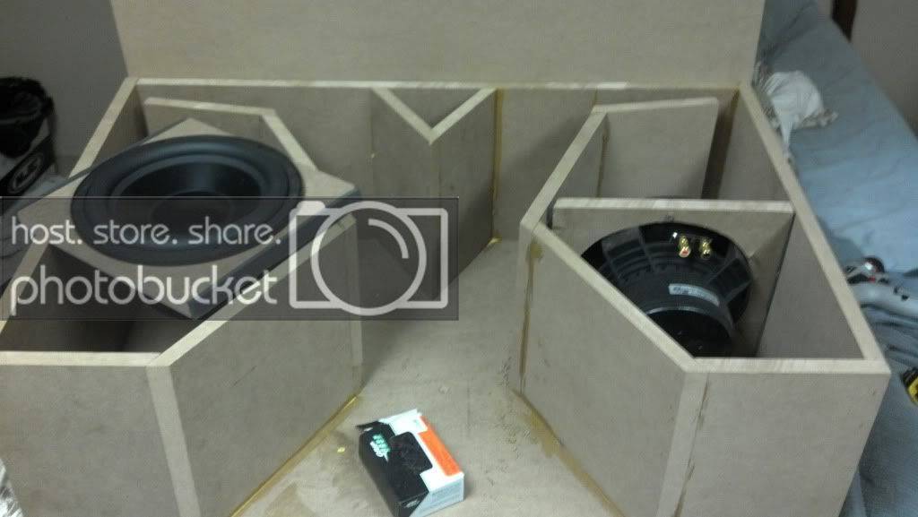

closer still
The box is semi-complete. I finished the construction, just have to get some sealant and do the interior and the holes for the speaker wire (and the holes from when I missed wood doing the screws //content.invisioncic.com/y282845/emoticons/redface.gif.62fdbfe1a101588a808c4cff71bcb942.gif) I was thinking silicone. I really just don't like resin, too permanent and messy for me. Any other suggestions though?

Like the box! Curious as to how it's going to sound. Like the choice of moofers too. Can't go wrong with Dayton HO's. Definitely tuned in...
The box is my favorite design. Decware Wicked One. "To listen to it is to understand the definition of speed" or something like that.
I have close to 6db gain throught the entire spectrum of frequencies the sub sees, and the gain comes through very cleanly. Almost as flat as a true 4th order.
Granted a true 4th order, or sealed will sound slightly better. And a ported box will get louder at given frequency range, Mine has the best of both worlds, but is master of none....so I don't like to compare myself to others in an sq or spl contest LOL. Unless we're doing a full spectrum XD
