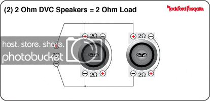

http://i99.photobucket.com/albums/l317/jdcrosse22/2_2ohmDVC_2ohm.gif
what about that? thats a two ohm load going to 2.... 2 ohm subs
Yes, that is how 2 DVC2 subs are wired to 2 ohms, however you simply don't have nearly enough power.
For 2 Daytona subs, rated at 1500wrms each, you'll need an amp to do 3kw of power at 0.5ohm. This is going to require a high output alternator as well as the big 3, and a battery or two.
if i wire the subs this way why would it only be 400w to each sub....why wouldn't it be the full 800w it says the amp would do at 2ohms?

Those two sets of speaker terminals on the MBQ (and a lot of other mono amps) are parallel inside the amp. If you wire each sub for 4 ohms and connect one to each terminal the amp sees 2 ohms.
