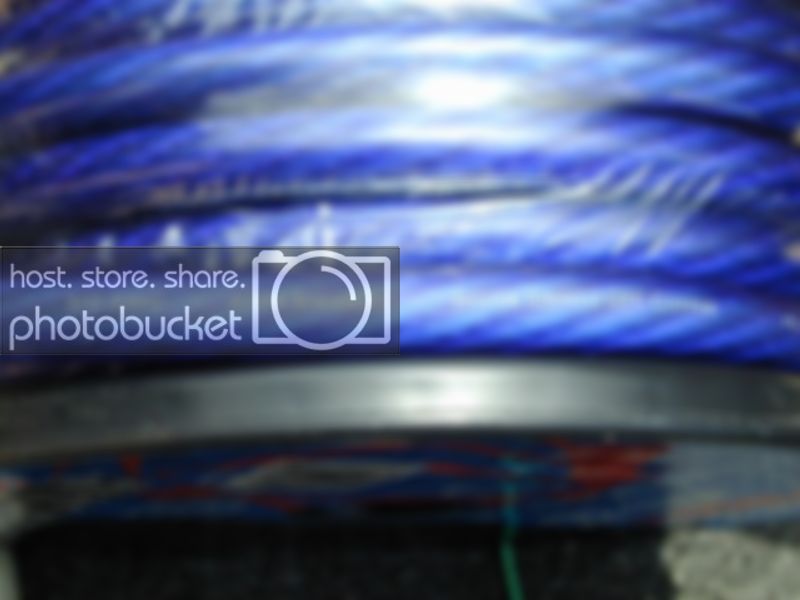

since u guys are talking about wire... when i am looking at options of the same gauge, what should be considered in my decision other than price?
Material:
OFC (Oxygen free copper)
Copper Clad Aluminum
Silver Tinned OFC Copper
Solid Copper Strands
Strand count really only had to do with flexibility... and those with higher strand counts don't necessarily mean more flexible. It also has quite a ibt to do with the jacket. You could also look at jacket material, temperature tolerance, etc, etc...

The cables are not tinned with silver. You have tinned oxygen free copper - tin is silver in color. Silver Plated Oxygen Free Copper is VERY different from Tinned Oxygen Free Copper (TOFC)
TOFC is marine grade - will not oxidize maiking it prime for automotive enviroment. Bare OFC is still exposed to elements and can oxidize over time.

Ah, I see. I was just relaying what it said on my wire...

Yea, its kinda funny they wrote that. If it were actual "silver" the cable would be well over $10/ft and would be a very good conductor, silver will oxidze/tanrish too. But silver oxide still conducts electricity while copper oxide, not so much...
