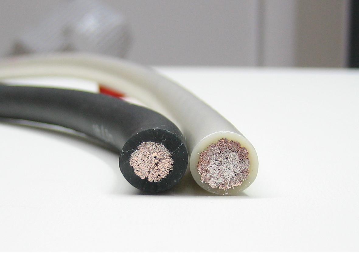

As posted previously, it is Copper Clad Aluminum. however it has been over sized to compensate for the difference in material resistance (copper vs CCA) this image illustrates it quite well Stinger PRO 4 gauge vs KLM 4 Gauge. I do not have any Stinger 1/0 laying around so I cant compare them in a photo.
