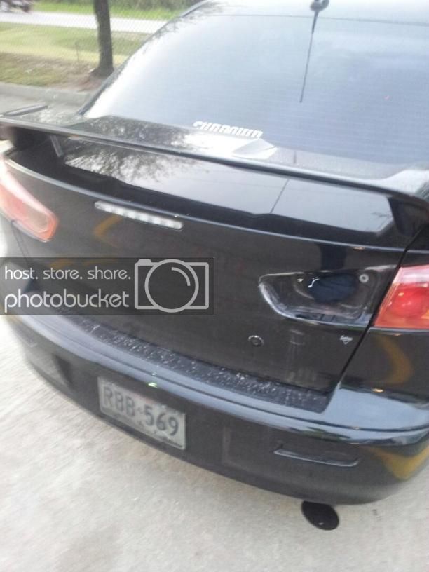

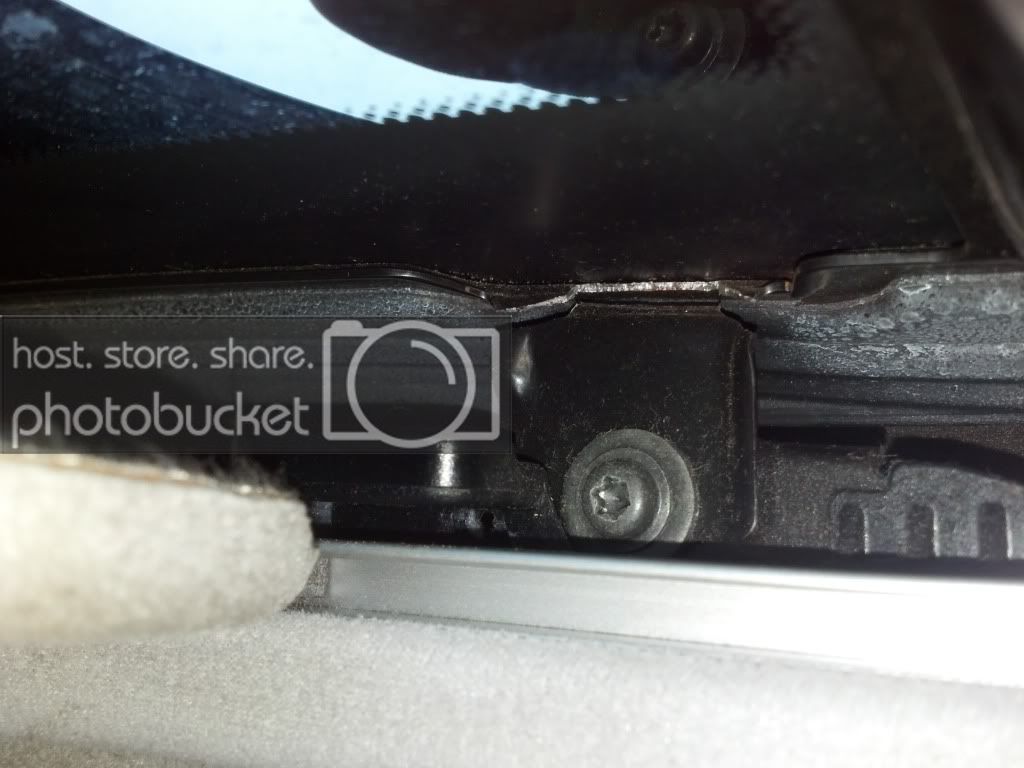

Sunroof is done for. Broke 2 mounting brackets that hold the glass down. And destroyed the sheet metal and lost a reverse light. He was drivin to work one morn, got out of his car and realized the light was completely gone. Scratched up and pitted the paint pretty bad underneath where its supposed to be
