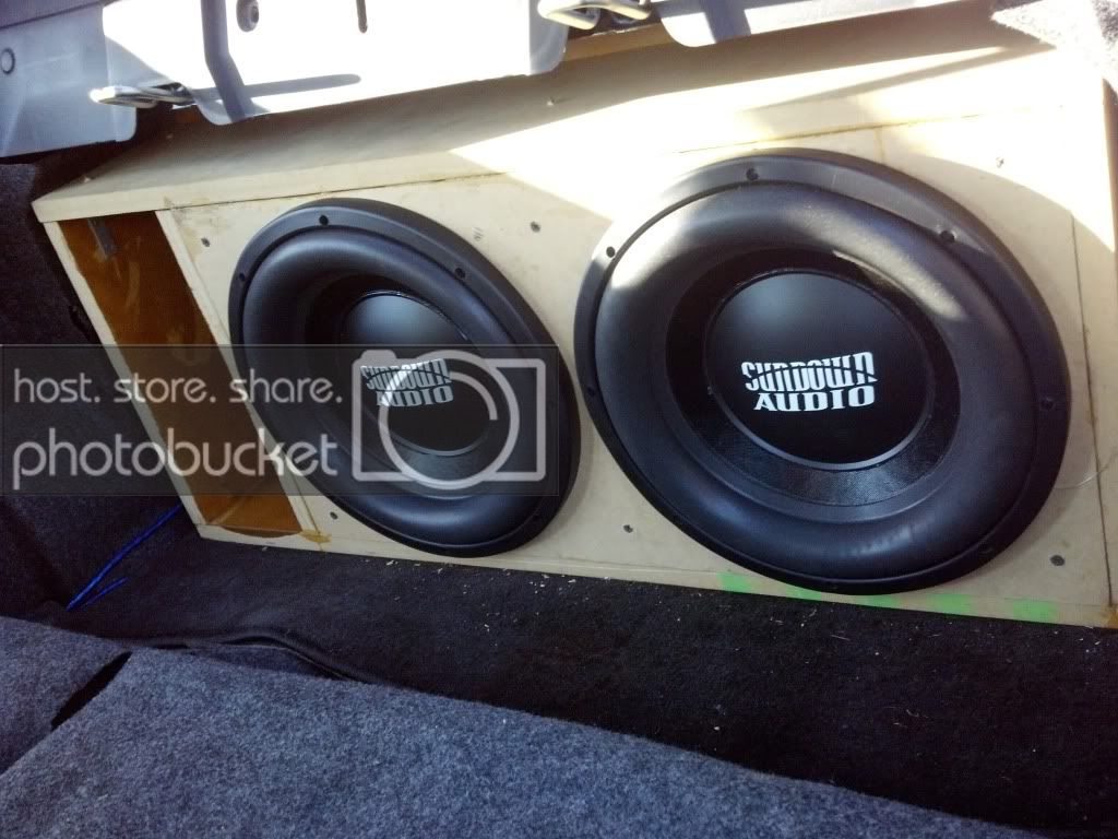

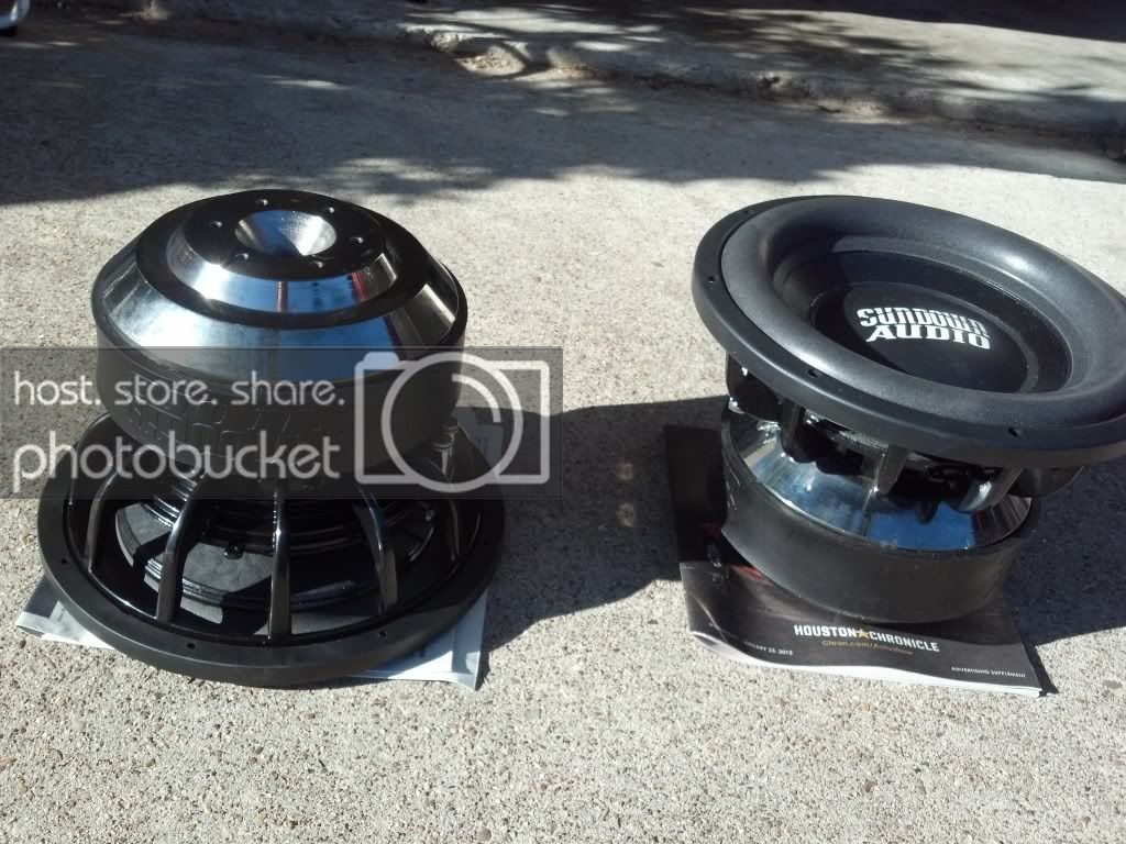

So after an issues we had with the atomics, Rob decided to sell them and picked up some Zv3's with all NS upgrades. With puttin them in and playing with them a little they dont seem as loud to ear right now, but can tell they build more pressure. May have to shrink box down a little and see if we gain anymore. They do sound much more musical tho

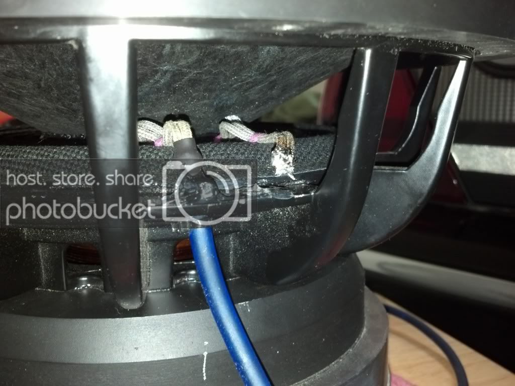

Tinsel broke away from the direct connect on the atomic
what size box, and tuning are they in now?
Same box. Same tuning. Its about 6.1gross. 4.9net. Tuned to 36. Peaks at 34. I think ima add some 45's and stuff to take up a lil space. Ima work on sealing it off from the trunk this week. When it hits about 32 and lower they just seem to unload real quick
