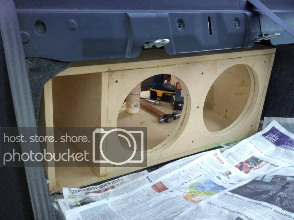

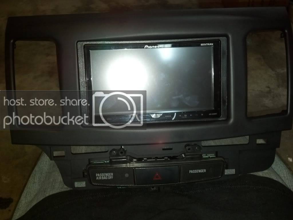

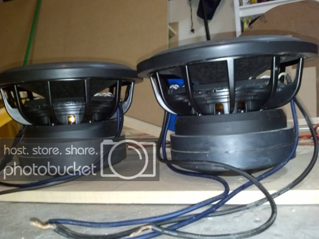

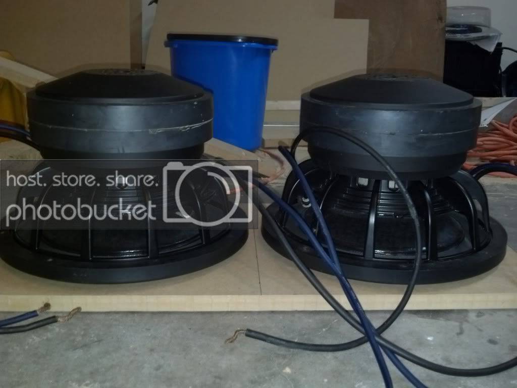

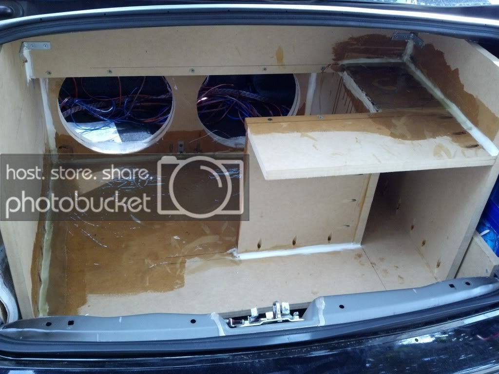

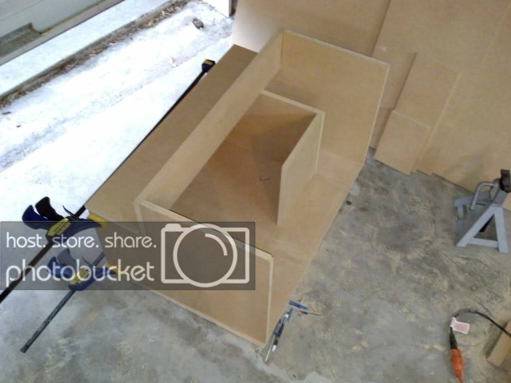

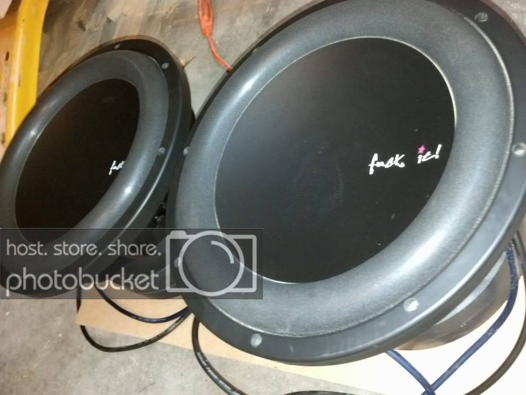

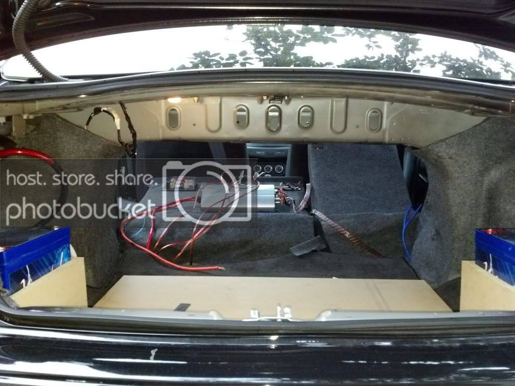

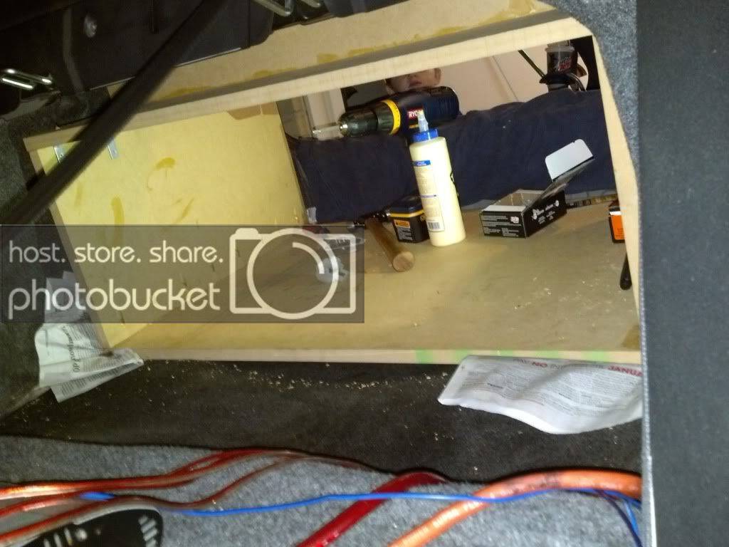

Working on doin an install for my buddy on his 09 Lancer. Box is having to be built inside the trunk. Box is about 6.1cubes gross, after all displacements is is about 5.4cubes. Tuned to around 36hz. All seams will be glassed and matted to insure tight sealed and strength. Equipment is 2 Atomic APX 12's on 2 Audioque AQ2200, 2 Kinetik hc2000, Audio Technix wiring and Big 3. Pioneer avh-x5500bhs headunit

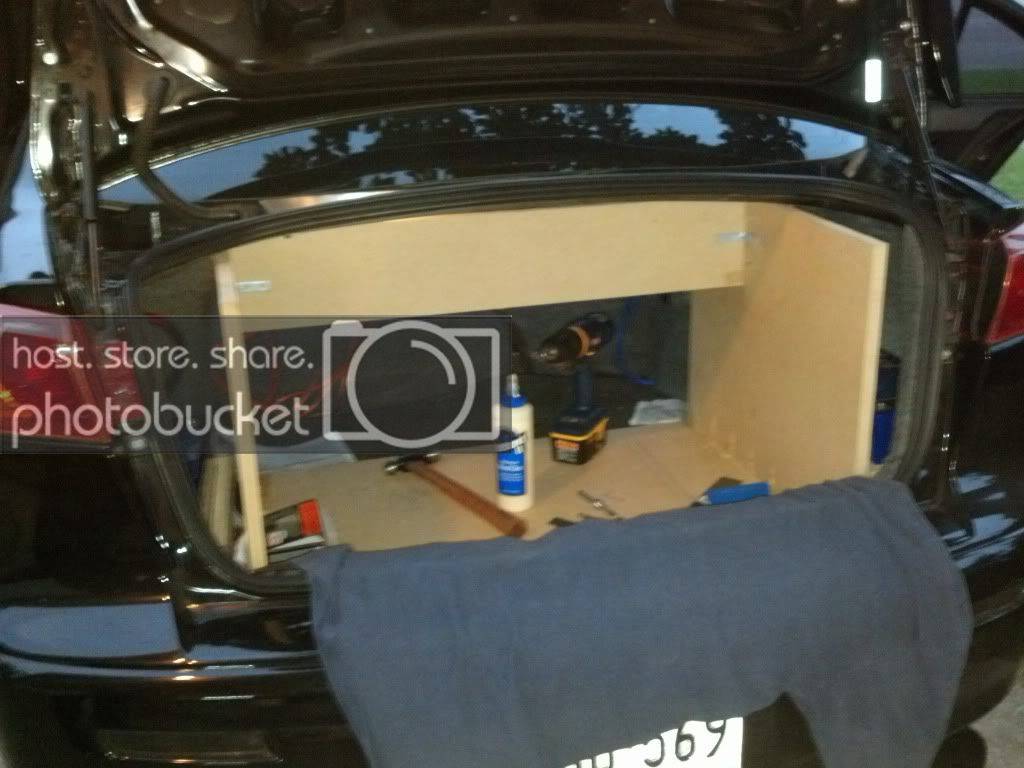

Dry fitting box
nice stuff should be loud //content.invisioncic.com/y282845/emoticons/smile.gif.1ebc41e1811405b213edfc4622c41e27.gif. i want a lancer so bad //content.invisioncic.com/y282845/emoticons/frown.gif.a3531fa0534503350665a1e957861287.gif

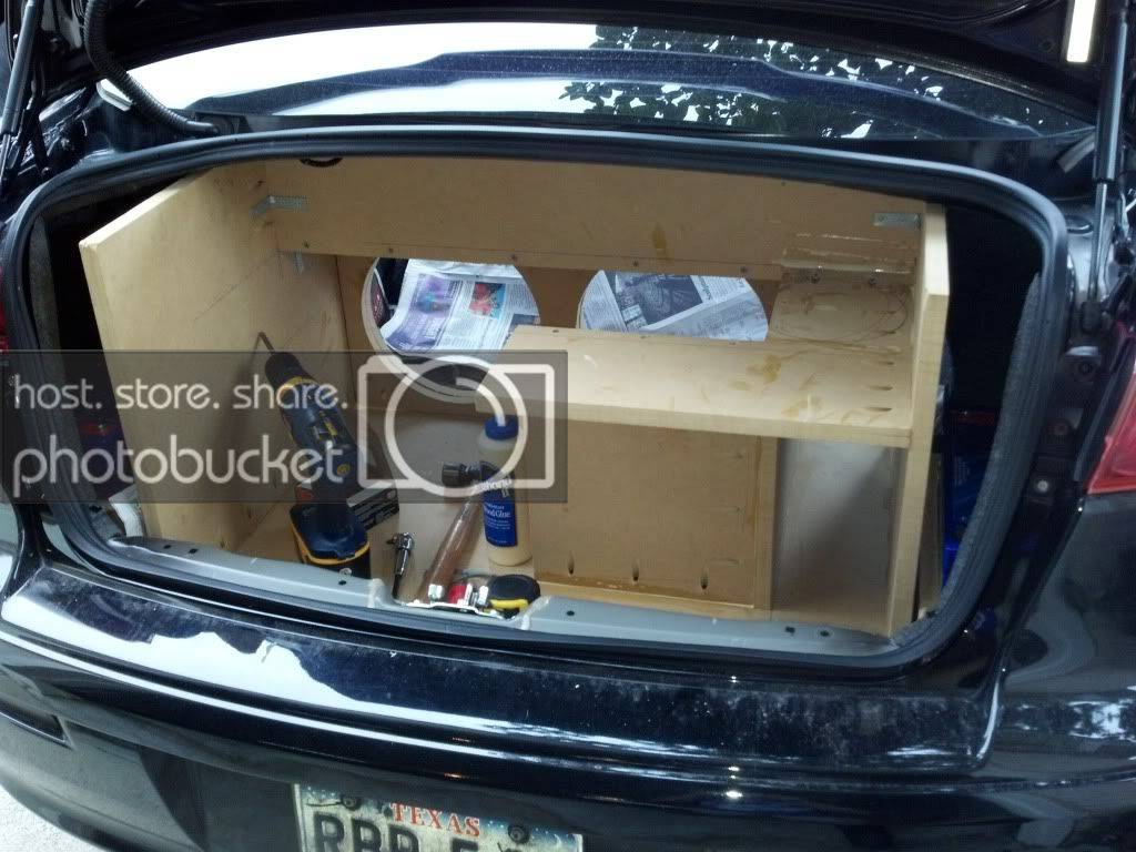

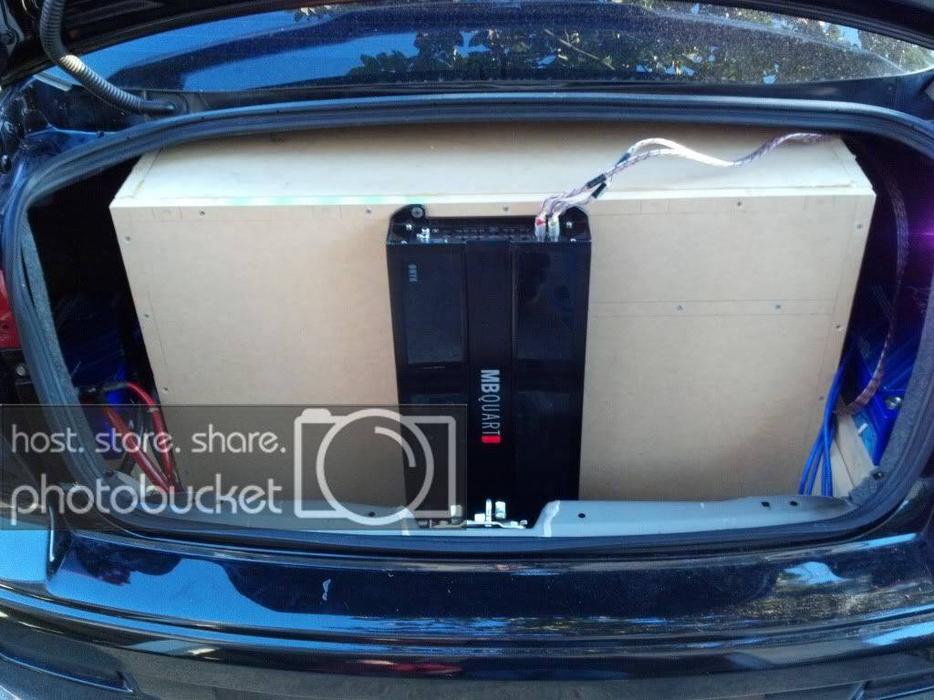

Woo gettin close to it playing.

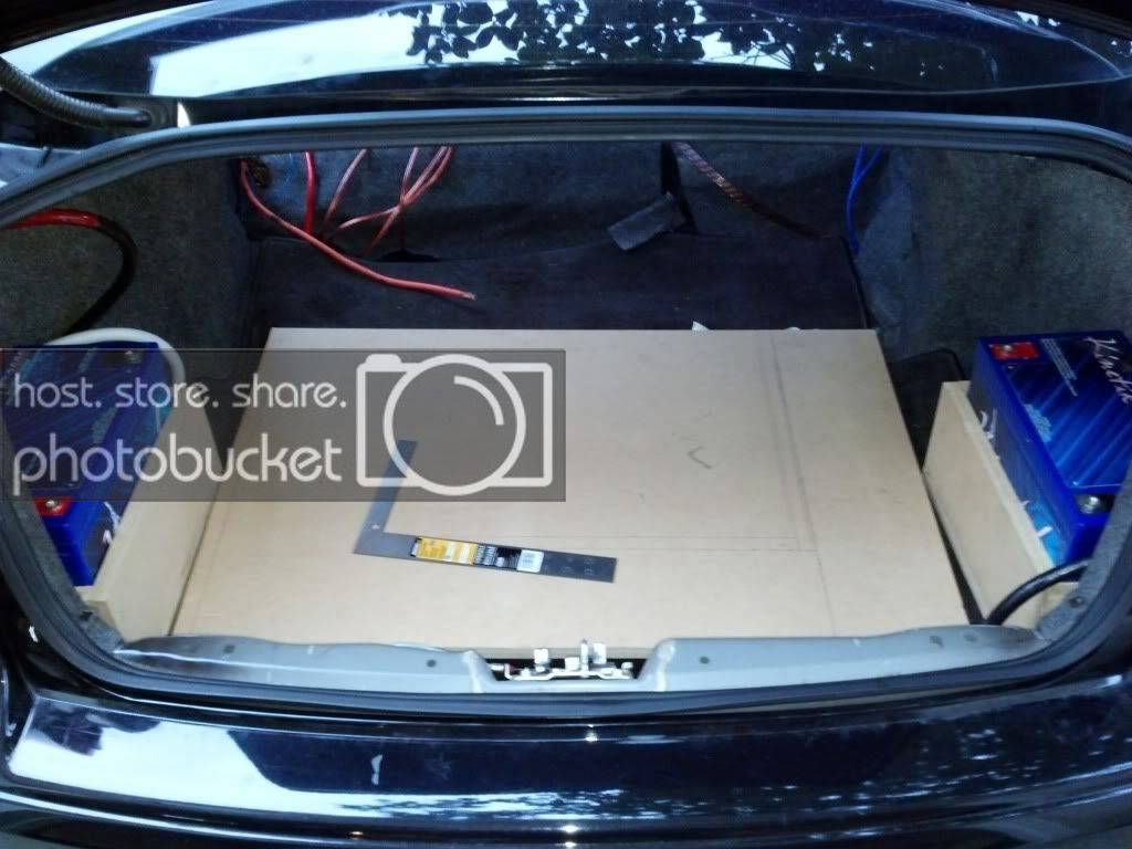

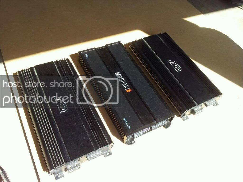

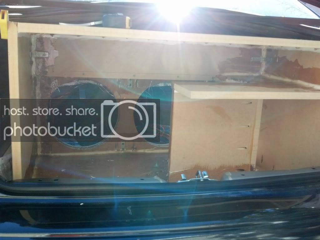

Lay out of amps. Will be attached to rear of box. With a washer seperating. It is a very very close fit between amps and trunk lid
Highs amp mounted
