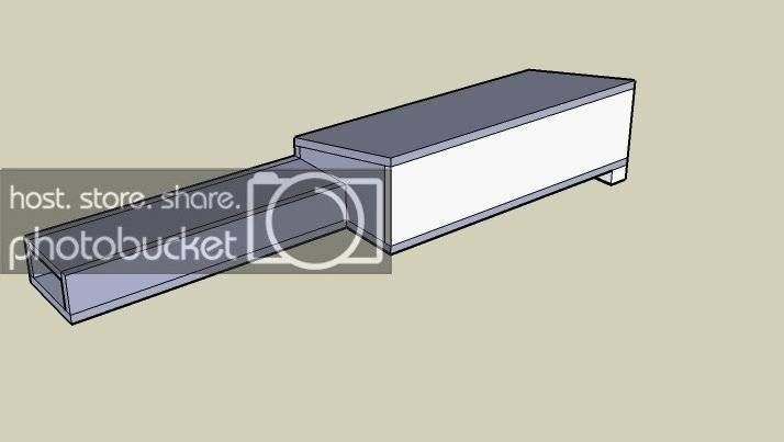

Here is the box I have been building for those trucks.

ye ai would go with 1 sub ported to be most effecient something like this above would be nice or the foxbox

but it looks like he is utilizing more space
but we need price rang u want to use, id get one nice beefy sub 1000 watts and port it
Don't want to rain on anyones parade, but that foxbox ported box looks like crap. Looks to be ~.8cuft at best.
1.2 amd they make some of the best truck boxes i know, only one id buy, but i did post ur box seems like its utilizing more space.
