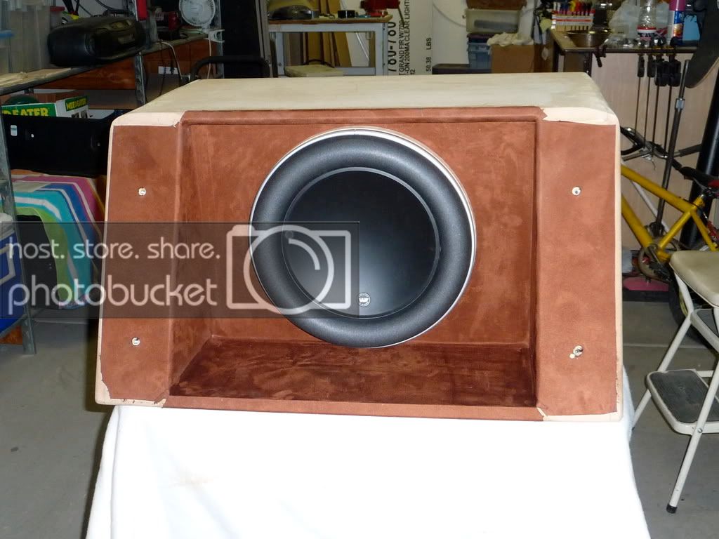

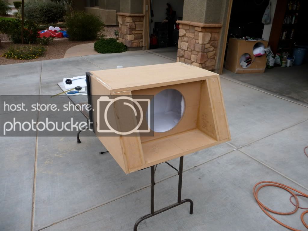

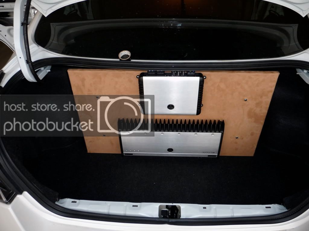

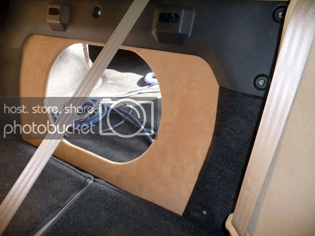

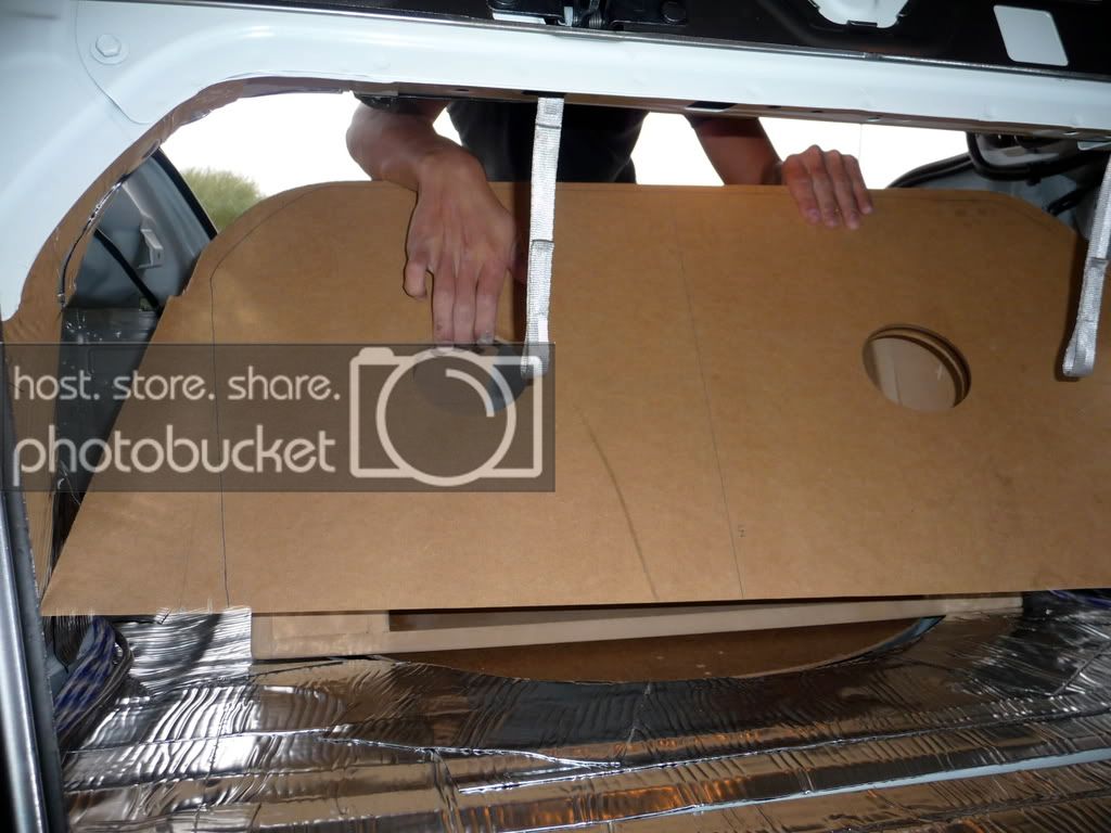

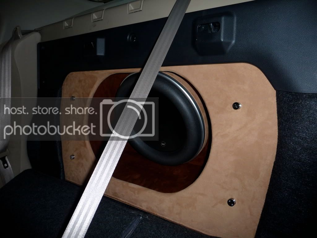

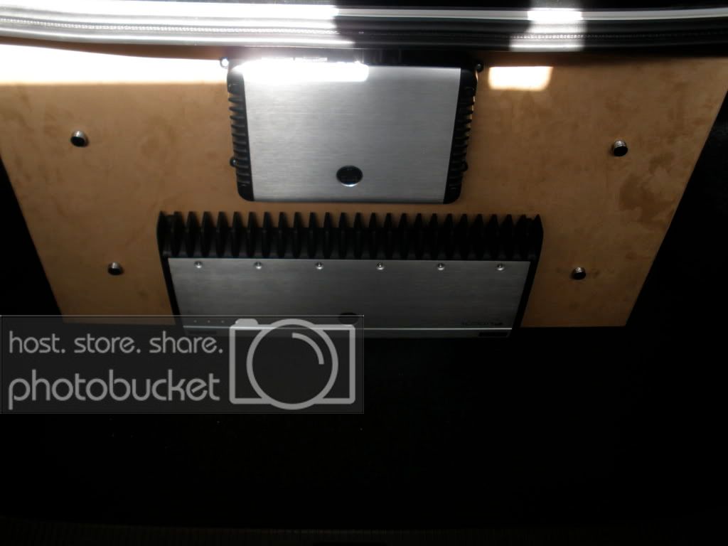

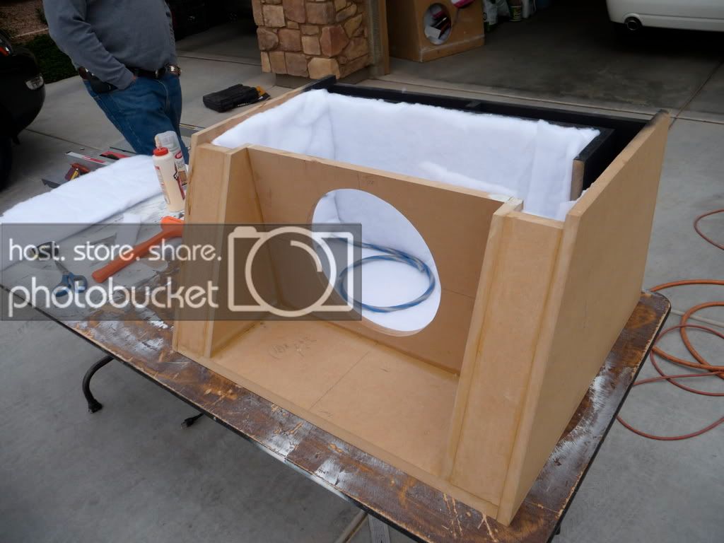

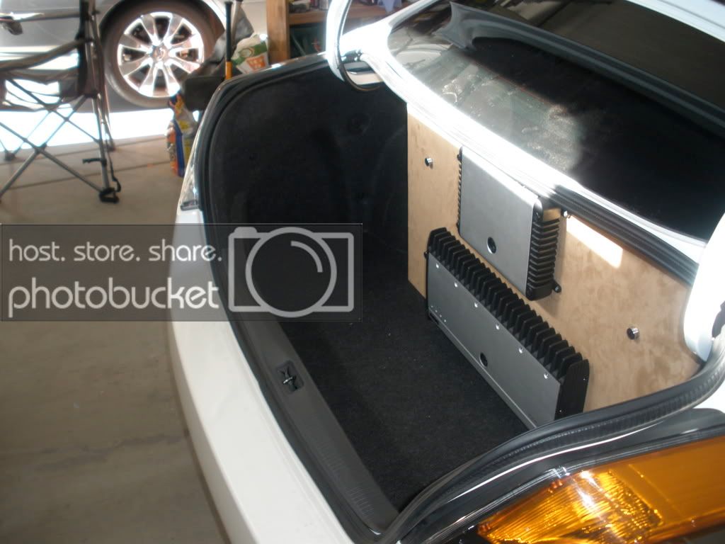

the box, wall,beauty plate and frame to box were all done using threaded bolts with t-nuts installed in the back of whatever the back piece was. Nothing including the mounted sub is just a screw into wood. therefore everything was drilled and aligned for installation and nothing is going anywhere.

Tweeters mounted by custom brackets into factory position:

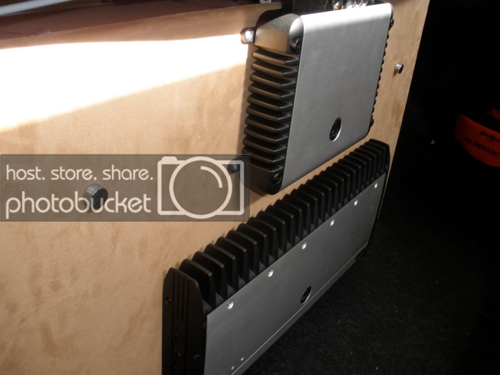

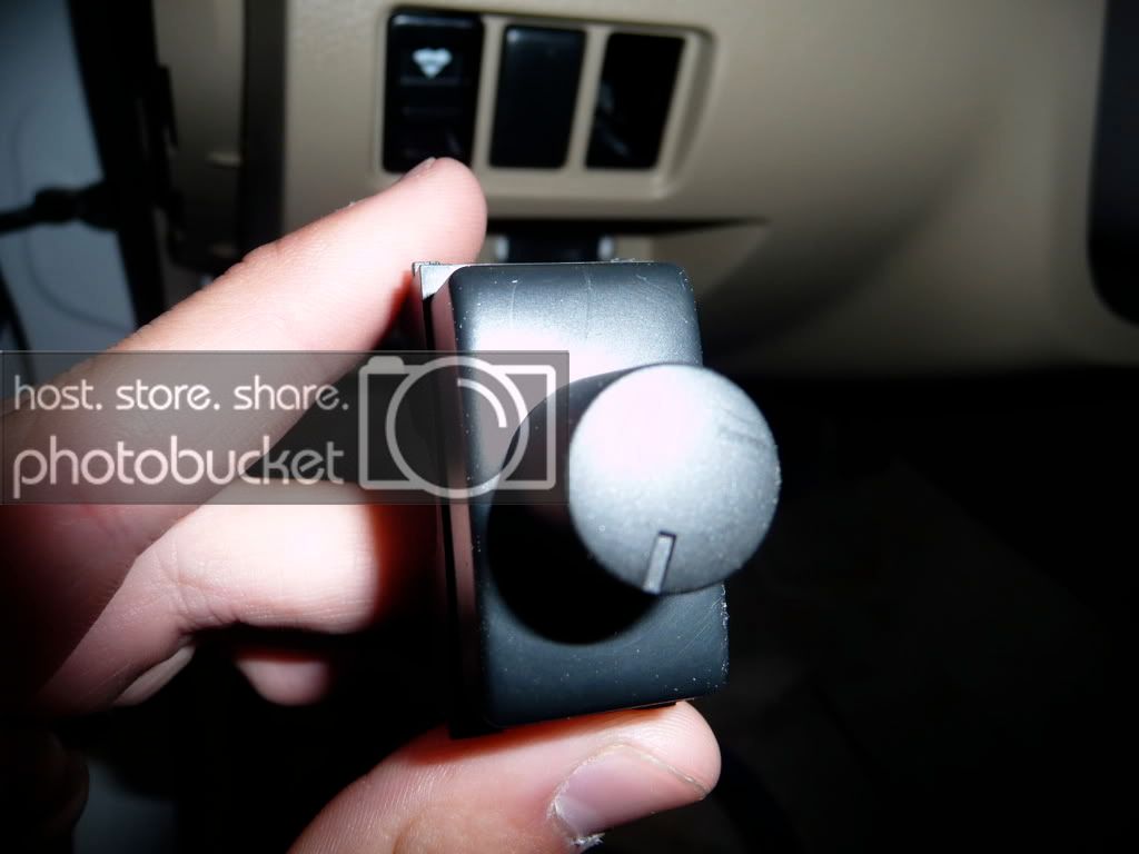

Bass Knob out of jl cage and into unused button:

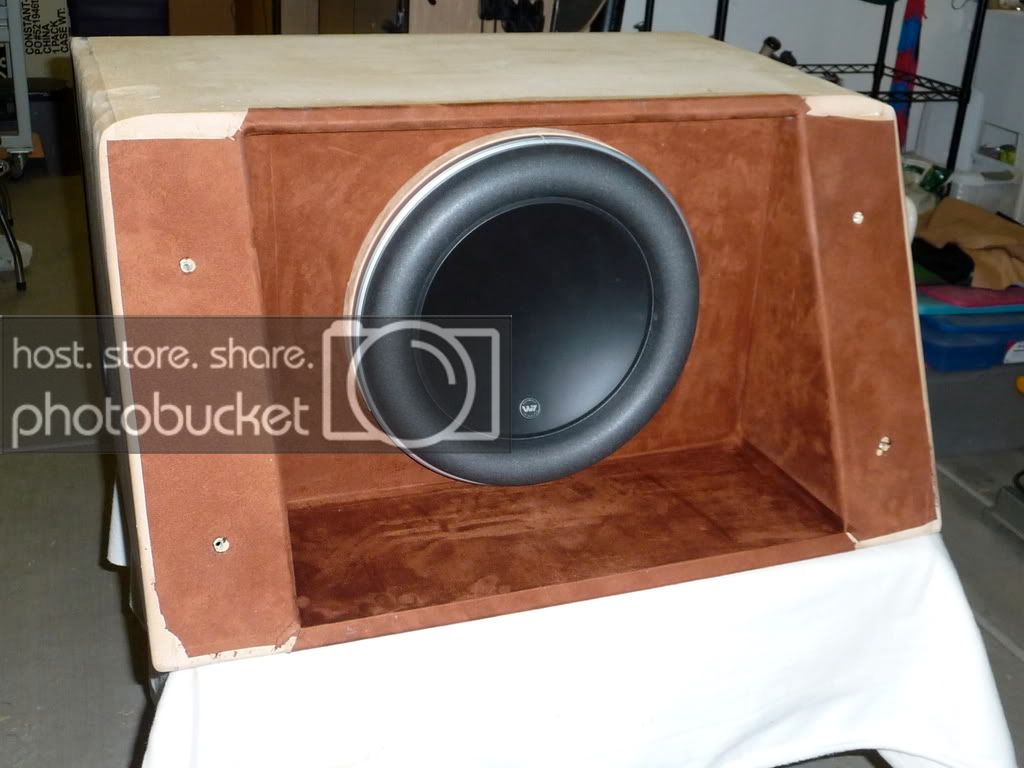

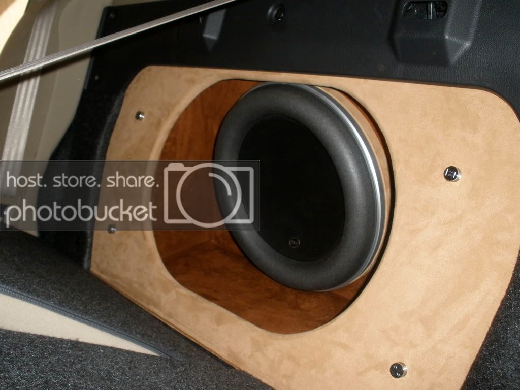

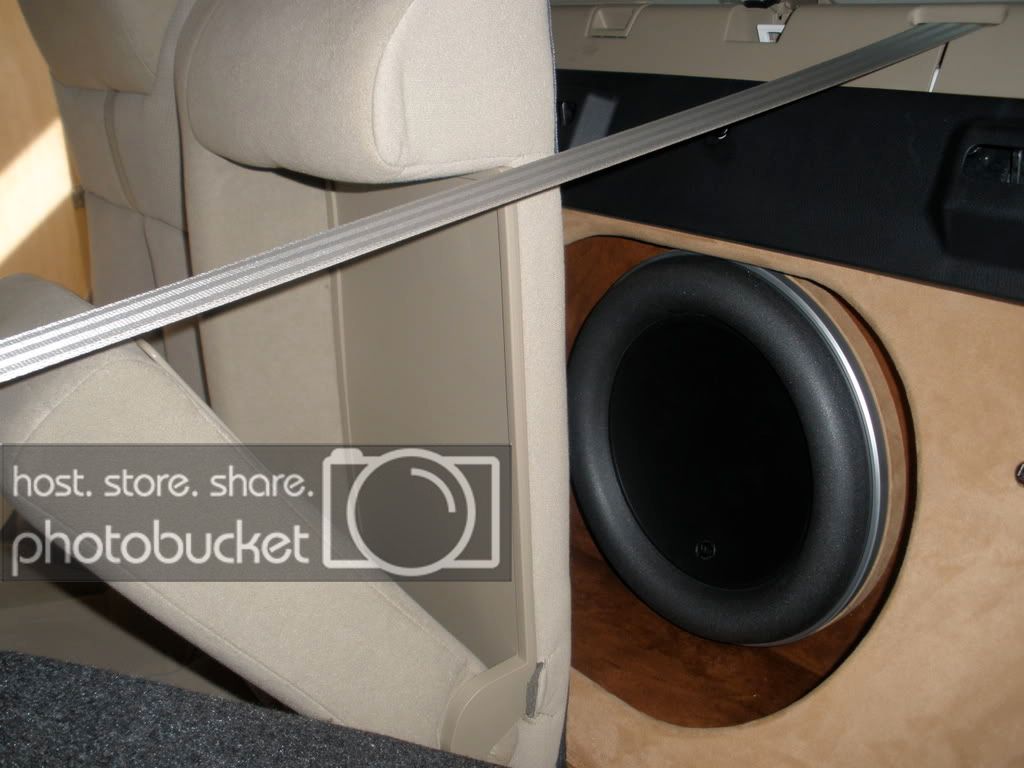

Sub in box:

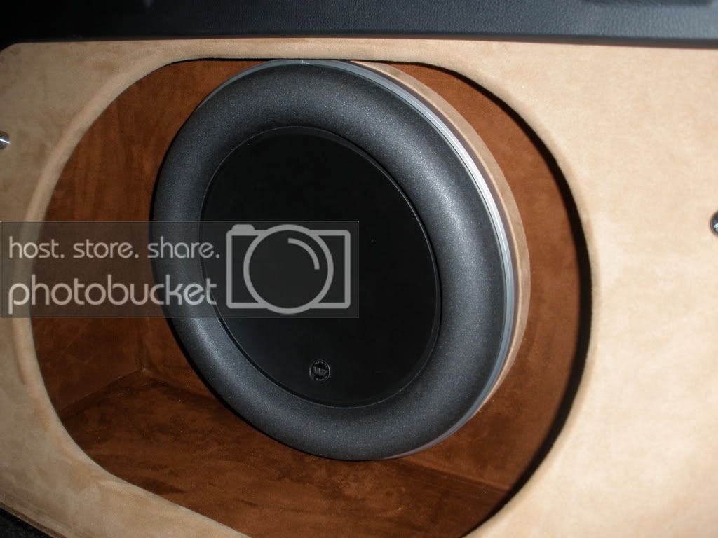

Beauty panel installed:

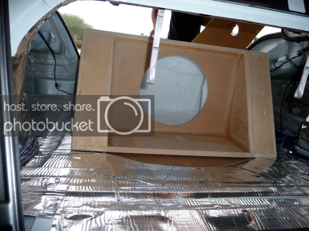

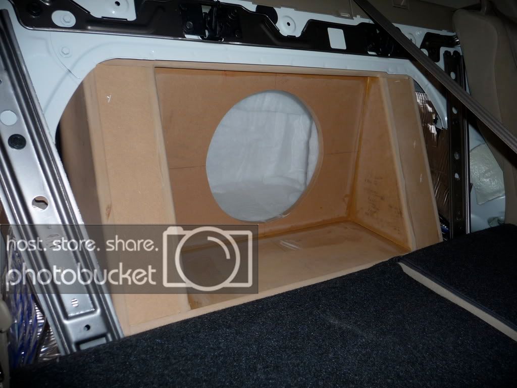

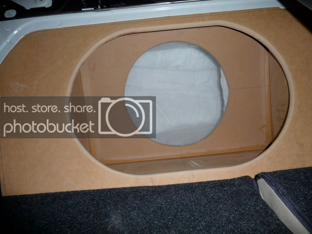

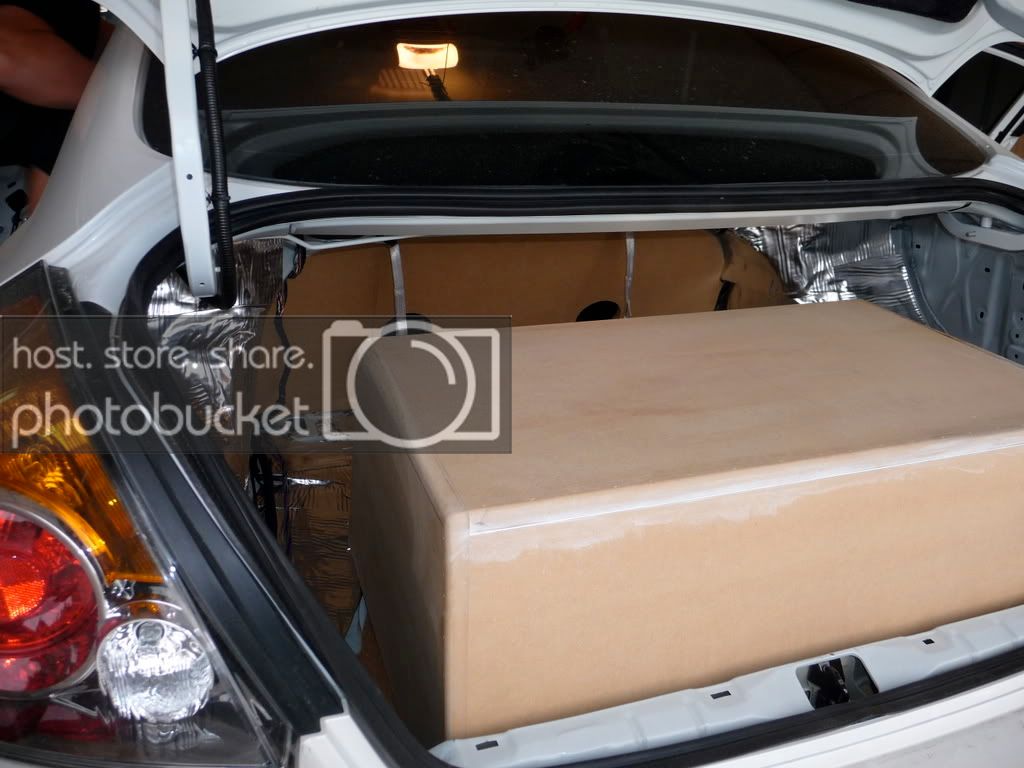

Box in:
