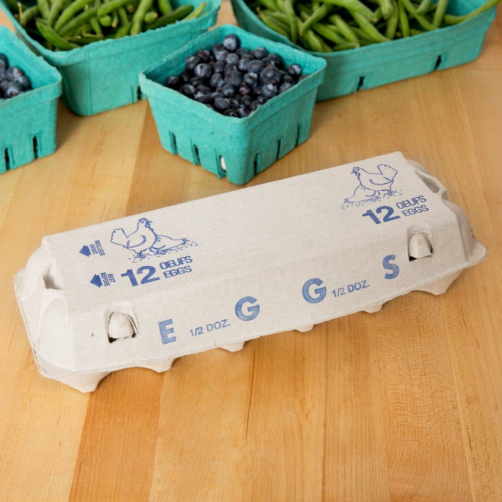

Im guilty but ecasue i got a ton of sounddeadner and used it to seal up my doors gaping holes which is fine but its a huge waste of money. lol granted its a hell of alot easier than trying to custom fabricate wood or plastic "covers" for the door its kinda wasteful but it does work good. i also usually spray abit of expanding foam inside the door to help lower leaks/losses and somewhat shape the door.. I also glue about a 6x6 peace of egg crate(the paper product not the foam) right behind the driver to beakup standing waves and stop reflection from the drivers rear wave it cleaners up the midrange //content.invisioncic.com/y282845/emoticons/wink.gif.608e3ea05f1a9f98611af0861652f8fb.gif

Yeah I kind of got an Idea of how to do it. At first I was just gonna get $60 worth of dynamat but then I heard abput SDS & thats whT im gonna end up going with.spoke to Dom & ima get what he recommended. I was thinking of making it a lil enclosure in the doors but I dont think Itll fit I just hope the speaker fits in there with an adapter. Yeah I was also thinking of doing that throwing some foam in the doors. Does the eggcrate work? Ive seen some videos of some eggcrate foam gettimg put around the speakers but dont have an idea if they work. Im gonna try it.Thanks for the advice man I really appreciate it!
when i say foam i mean the expanding foam like the great stuff you can buy at HD. i just put it towards the rea of the door and work back towards the driver. no need to get crazy with it just build up the back of the door abit and seal up the doors abit. the egg crate goes directly behind the midbass and yes it helps. its breaks up standing waves that cause distortion. will you hear it? maybe not but i know they science behind it and i think it works. Don't put anything in the door that isn't solid and will be excited by the pressure/vibrations the driver will create! the expanding foam gets hard and the egg crates are pretty snout as well.

of course you want to open it and use the bottom that has the ridges.
AGAIN NOT THE FOAM get the recycle pulp ones.
