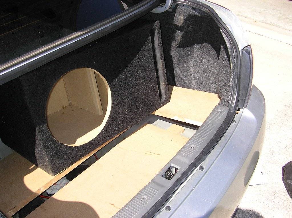

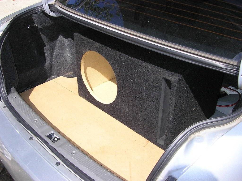

Sub Enclosure 1.5 Cubic Feet Channel Port @30Hz Built to Elemental Design Spec

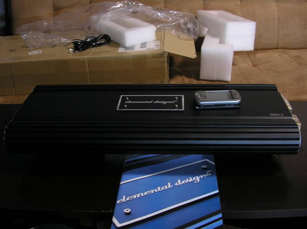

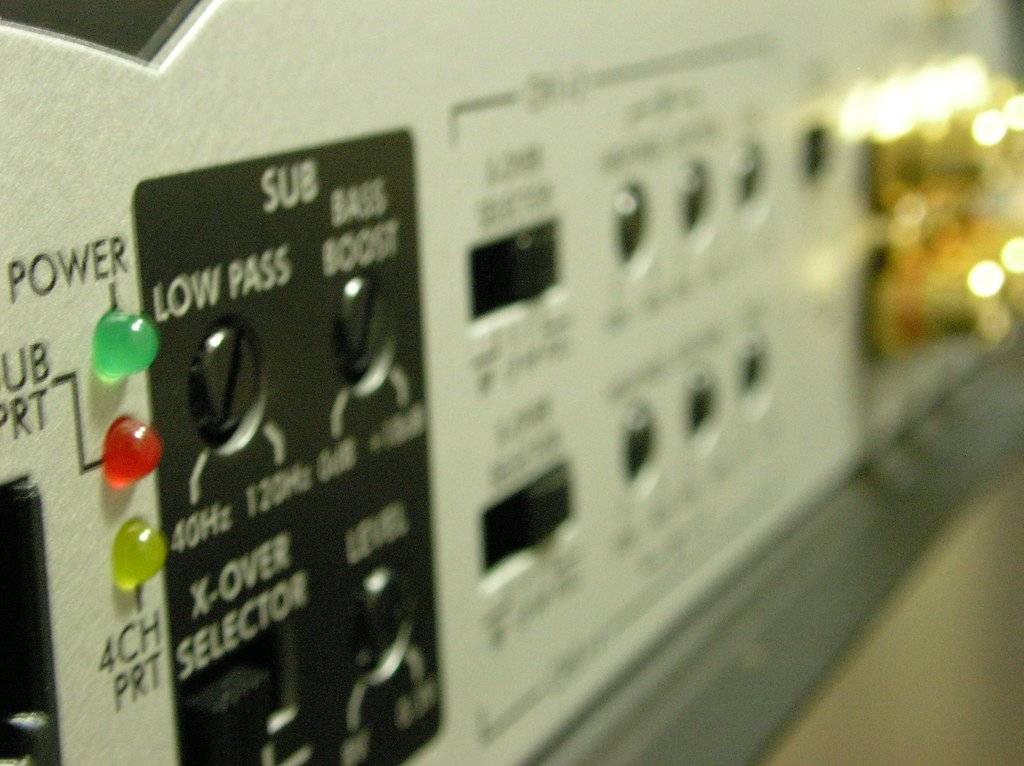

Amp: Elemental Design Nine.5 (5 channel)
Elemental Designs NINe.5 Test Report
13.2v Bench.
Tested at 1khz
4 Channel @ 4 ohm- 23 volts - 132 watts
4 channel @ 2 ohm- 22 volts - 242 watts
2 channel @ 4 ohm- 23 volts - 132 watts
2 channel @ 2 ohm- 22 volts - 242 watts
Tested at 50hz
Sub @ 4- 35.5volts - 315 watts
Sub @ 2- 31 volts - 480 watts
Sub @ 1- 28 volts - 784 watts

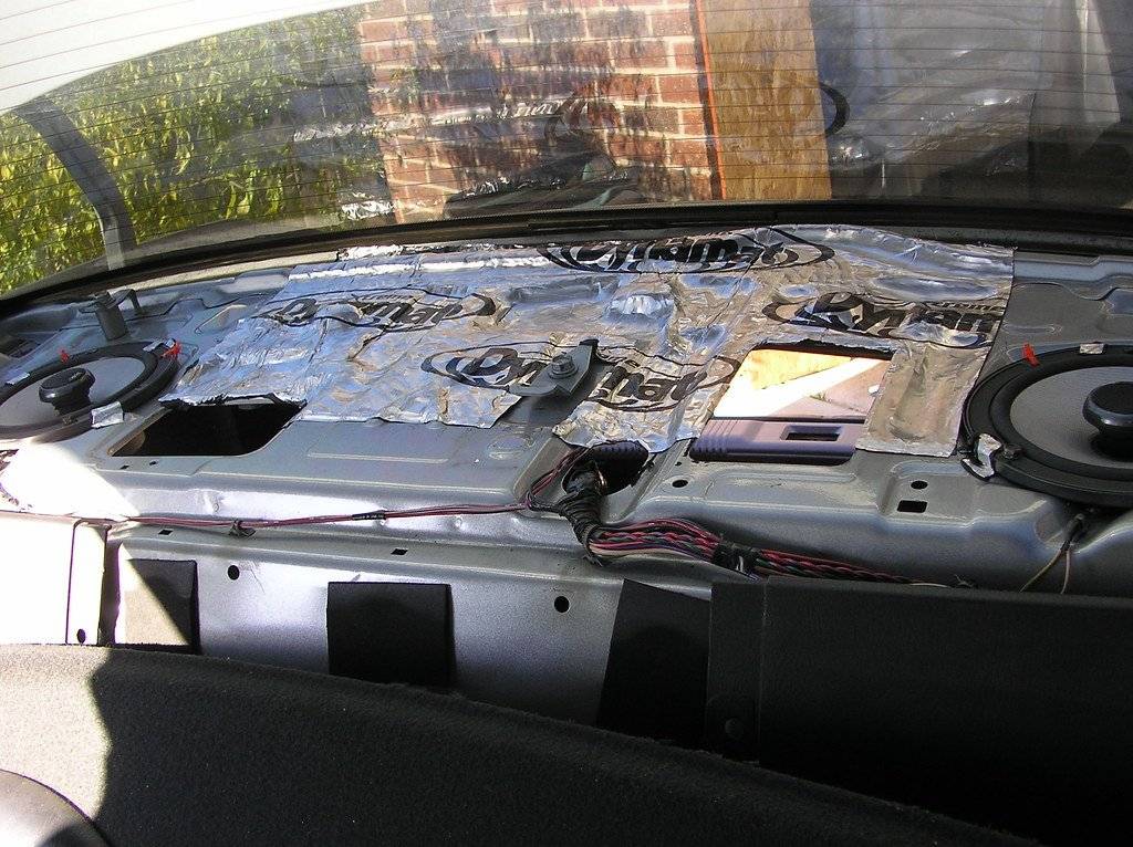

* Dynamat Extreme about 4-5 sheets...Surprisingly the Sentra had OEM Deading aswell

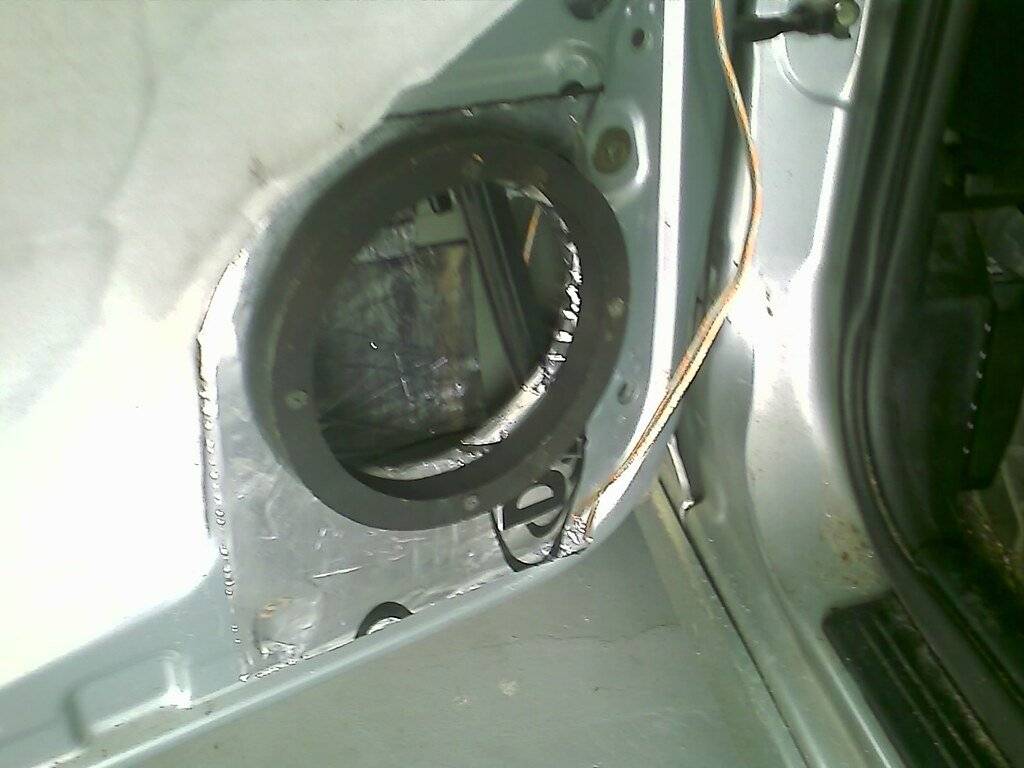

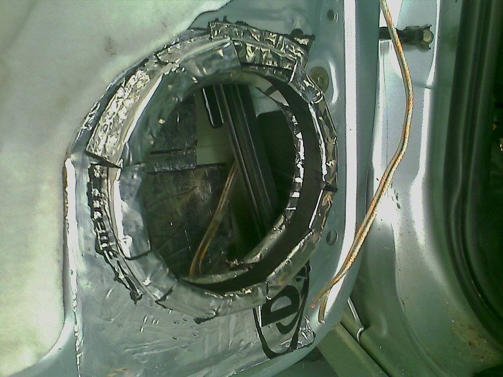

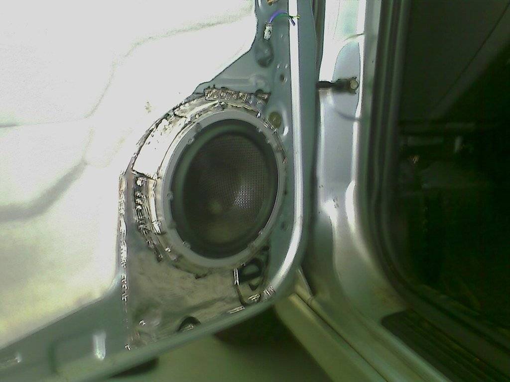

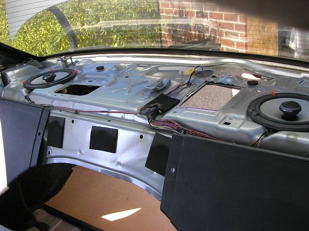

deading then spacers
then some more deading ovr the spacer just incase..

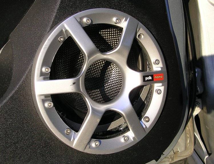

then finally the momo 6.5" mid bass
Sorry for the camera phone picture...(lost my digital camera for a while)..

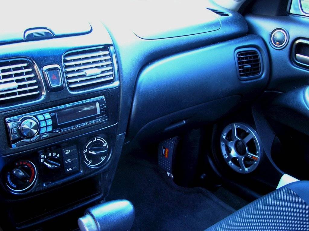

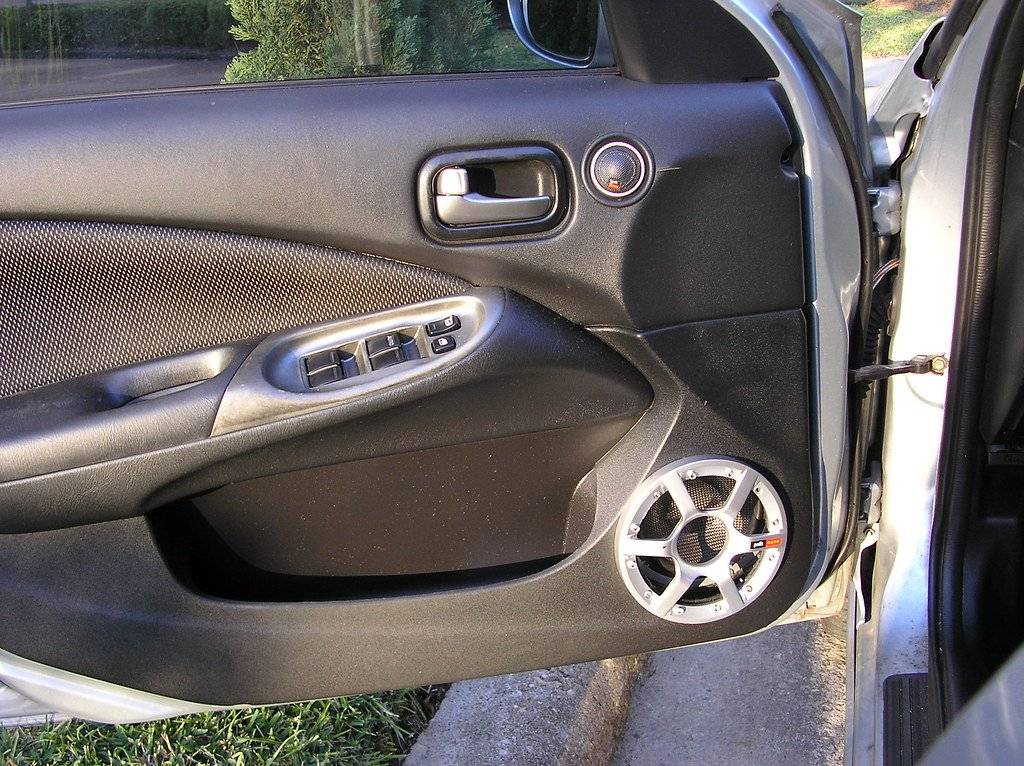

door with momo grill on the panel.

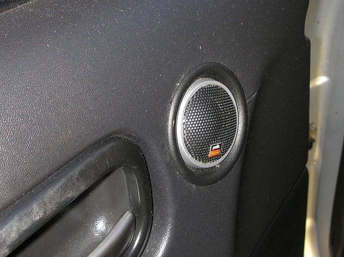

Silk/Polymer tweeter
Finished driver side door Panel
RIght Door

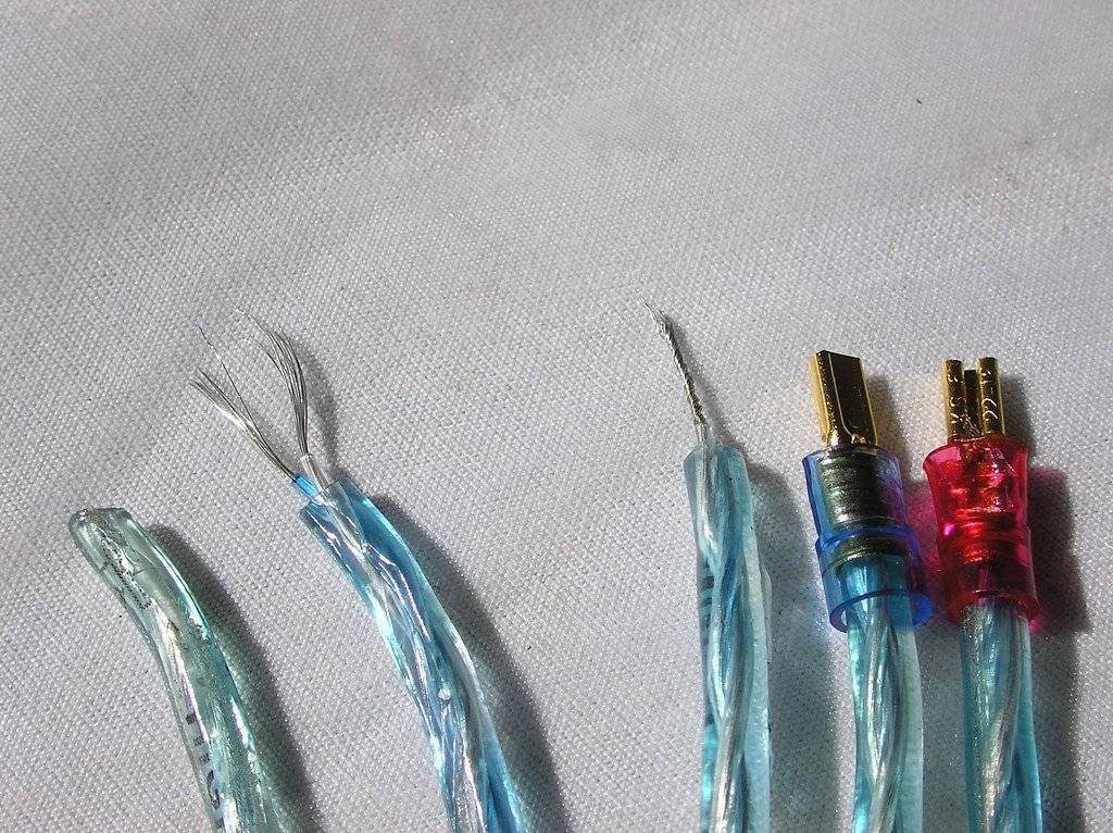

The wires n accessory for the build

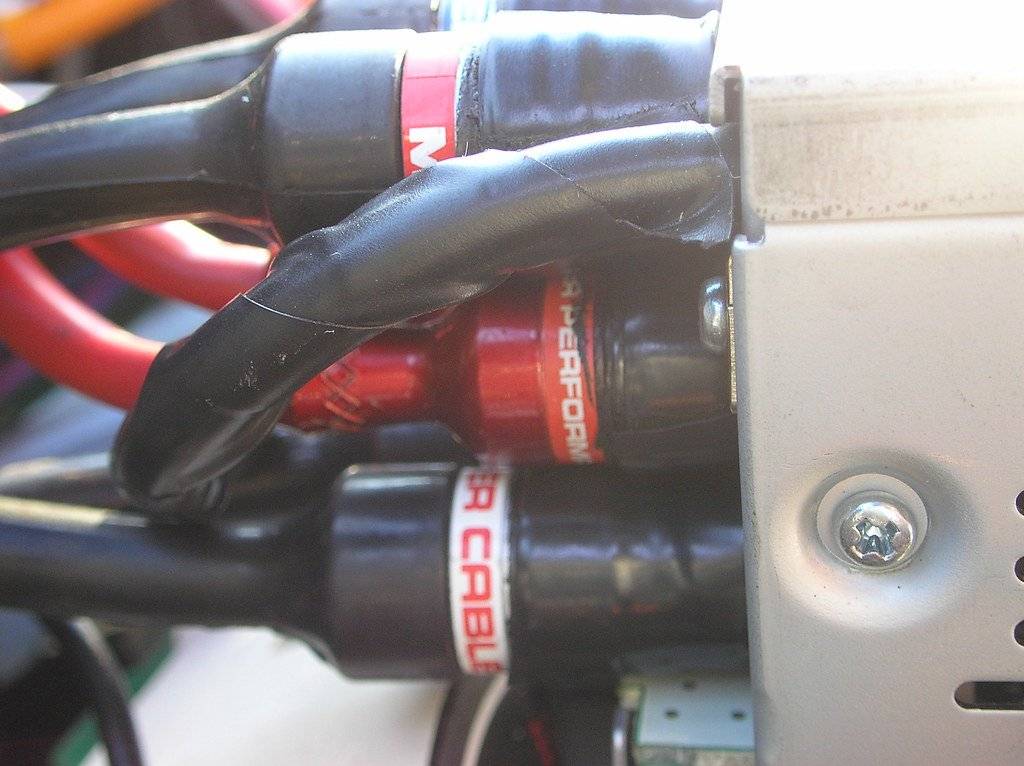

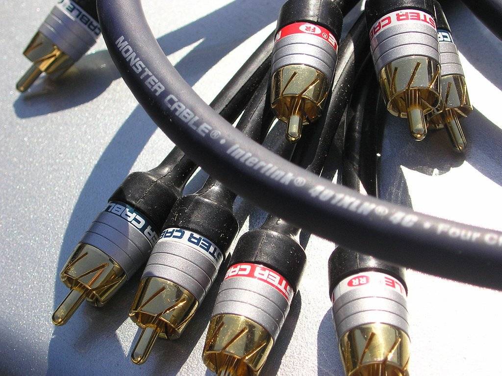

Monster Cable XLN 401
Monster Cable XLN 302KunKonceptz 0AWG 5140 strands!!!

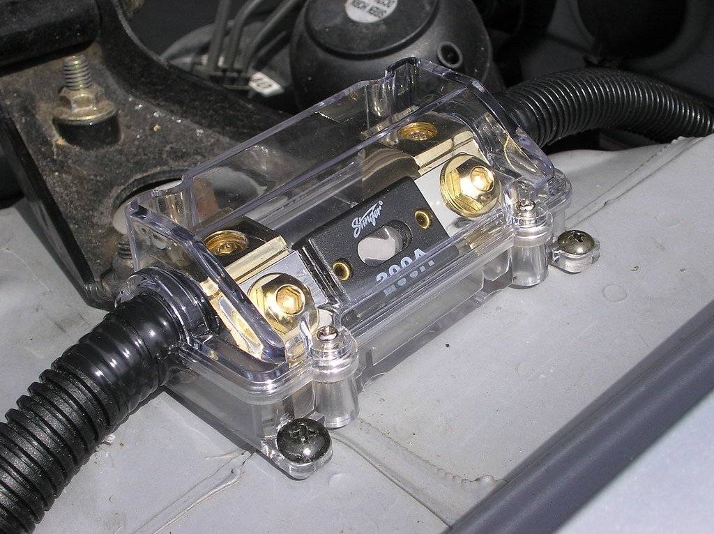

Stinger 200A /Generic Block
Rockford Fosgate Speaker wire 16AWG
Rockford Fosgate Sub Wire 12AWG
Monster 300 Crimpless Ring Terminals

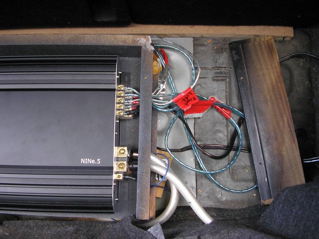

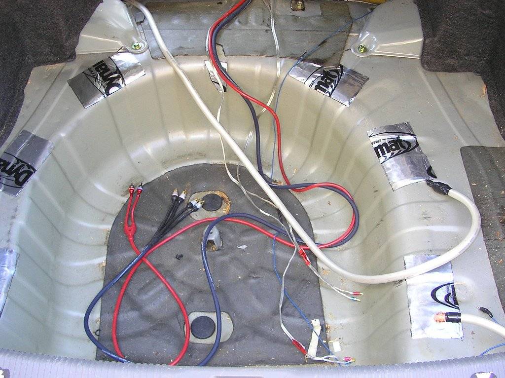

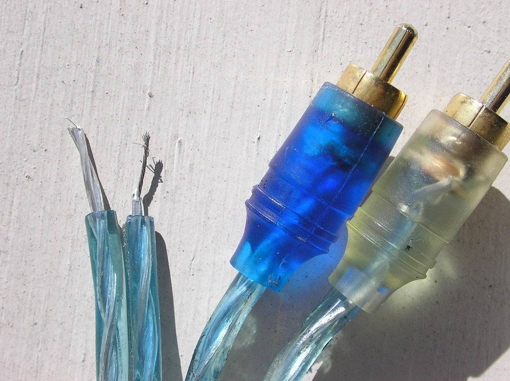

For the rear fill i ran out of wire..so this being a budget build/BROKE... had to use old RCAs as Speaker wire...
(step by step process starting from the left)

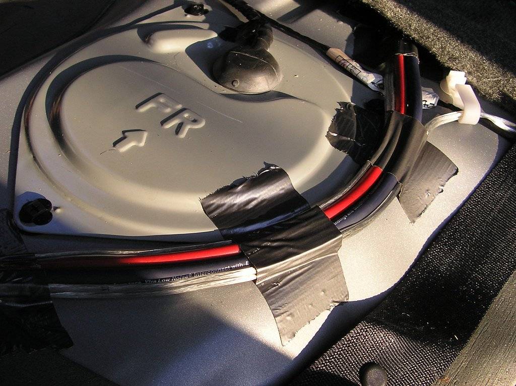

RCAs going to the deck - Rapped heavily with Electric tape to ensure clarity/static prevention

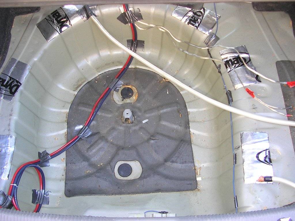

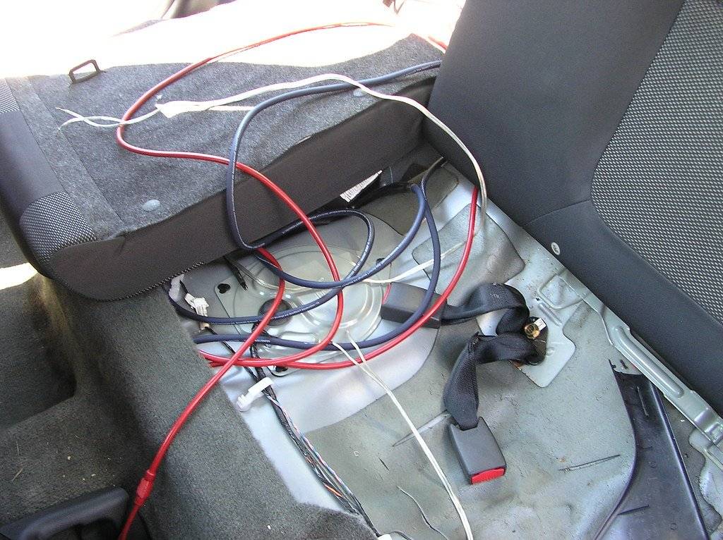

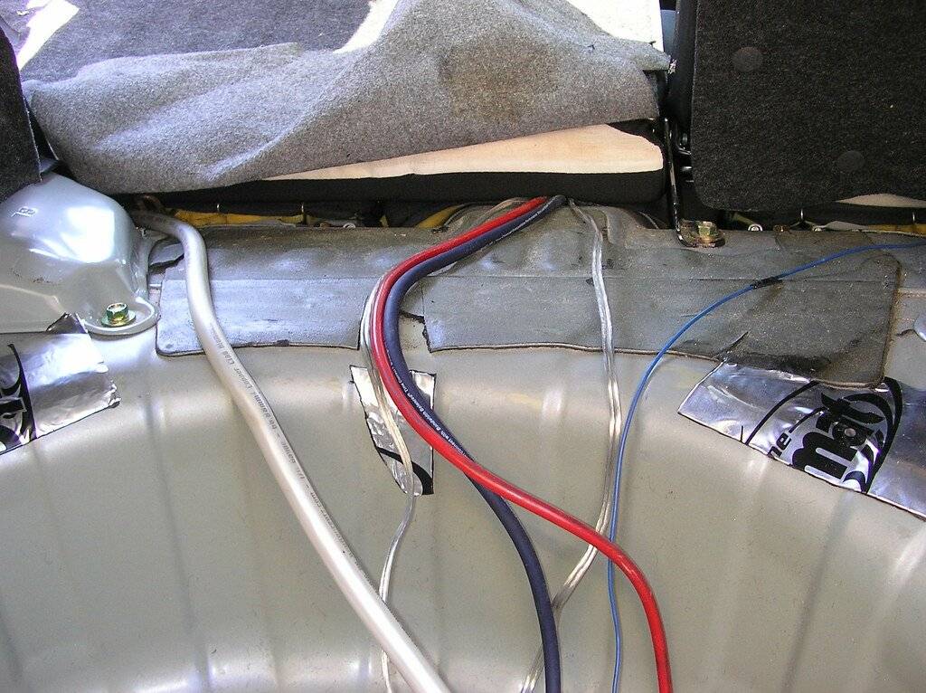

Wiring going to the trunk
After sorting

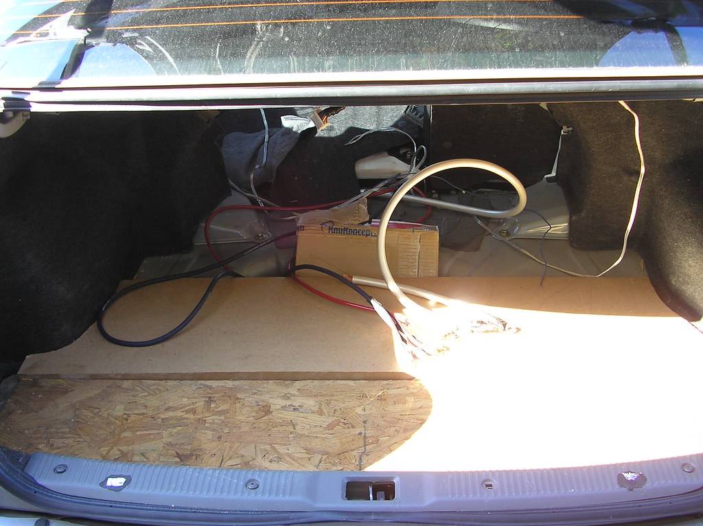

Unsorted wires in the trunk
after sorting

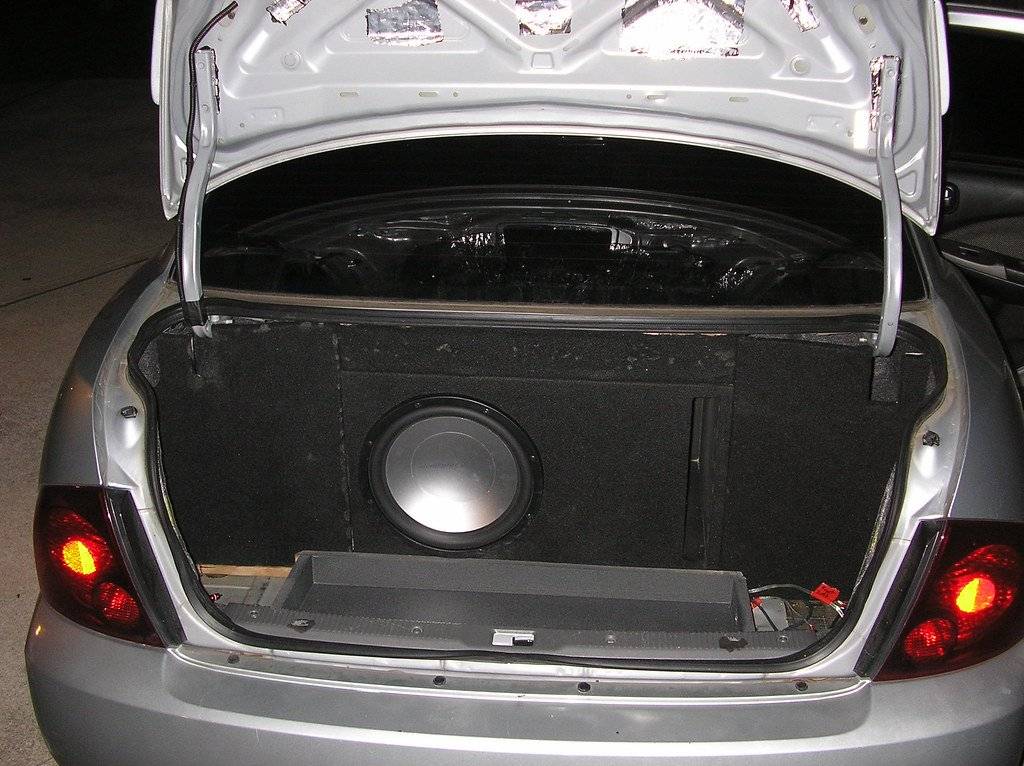

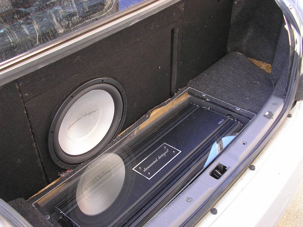

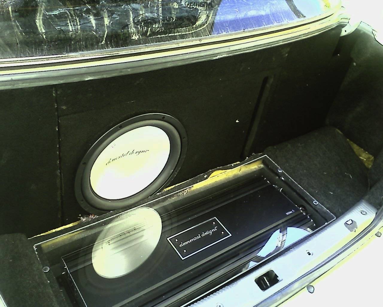

That last pic isn' the final touches is it? I hope not, if it is, work on the cosmetics and you should be good.
I didn't see any fans, I am not sure if that amp produces a lot heat, but that is something I would look at, especially in this Texas heat in summer. Also, you need more dynamat in the doors, try to fully seal them f-ers, yes I know it is very time consuming, but the payoff is great.

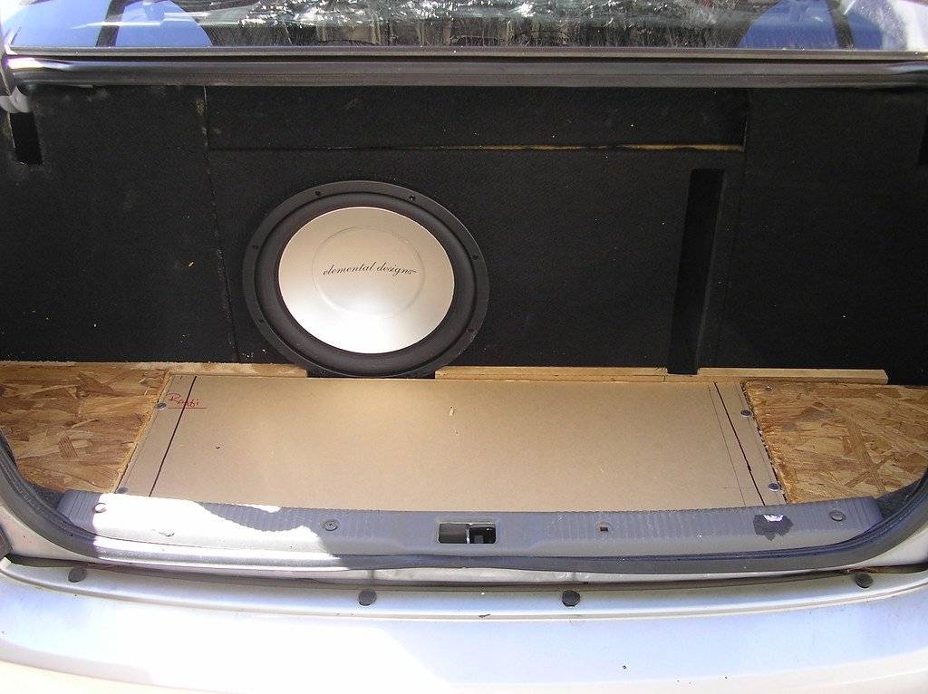

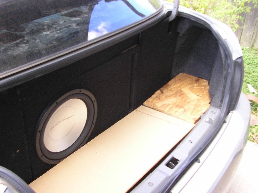

No..lol its not finished yet...i need to buy carpet...ima redo the hole thing with just one piece of carpet on the wall..and one on the floor...
i already have fans left ovr from my computer...but i need to buy volt regulators...i can't remember wat the name is for it...but need consitent 12V...its cheap but...kinda burned out on this project at the moment..plus got other things that needs to b done..but i definitely keep u guys posted. also thinkin bout doing some kind of light for the amp rack
Good setup! Yeah I agree with redoing that wall and bottom. Use one board for both. It will look way better. But over all you made me miss my Sentra thanks! lol. Nice build man keep us posted. //content.invisioncic.com/y282845/emoticons/cool.gif.3bcaf8f141236c00f8044d07150e34f7.gif
nice camera. nice build, i would of done with out the wall though or built a face plate
Thanks..the camera is OLD!!! lol its a 4MP olympus IR-500..

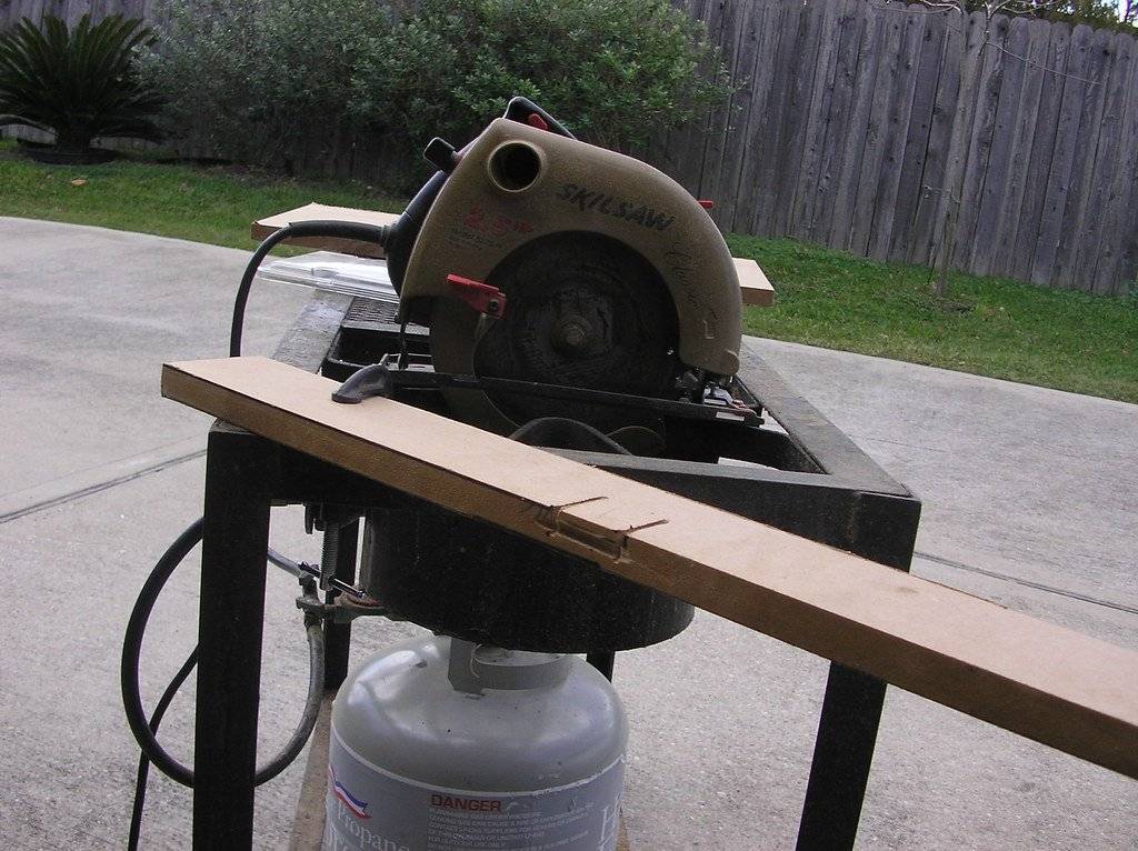

Im not sure wat u ment by face plate...but...im guess like a single peace of wood instead of the 3 piece around the sub box.....if so.. i didn't/couldn't wanna do that cause...the only real tool i had was a Circular saw!!! and a chisel!! lol...it was hell cutting the MDF to match the corners of trunk..so.. i can only do so much..i do plan on getting more electric tools though
i think it came along pretty well... even though we had not planned anything out, we did not have the right tools, and this was our first time doing something like this!!!
