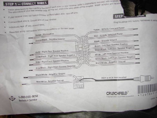

I installed a JVC Head unti but I do not think the factory sub is working. All 4 spakers are working fine. I did not see any extra wires on the wire harness that may be for the factory sub. Any help will be apreciated...//content.invisioncic.com/y282845/emoticons/smile.gif.1ebc41e1811405b213edfc4622c41e27.gif
There where 3 plugs I pulled from the factory radio but the harness only used one..//content.invisioncic.com/y282845/emoticons/confused.gif.e820e0216602db4765798ac39d28caa9.gif Right now there are 2 unused..
the sub amp is prolly one of the unsued plugs.. you ned to find the remote turn on if you plan on turning on the O/E Sub & Amp..
I guess we need more detail on what your trying todo..
Troy
the sub amp is prolly one of the unsued plugs.. you ned to find the remote turn on if you plan on turning on the O/E Sub & Amp..I guess we need more detail on what your trying todo..
Troy
All I am trying to do is install an aftermarket HU and keep the factory amp and sub.
Well, mine's a 2001 so it may be different. here's a diagram of the wiring harnesses that I got from Crutchfield. The bottom one is the one he's missing. They work fine.
