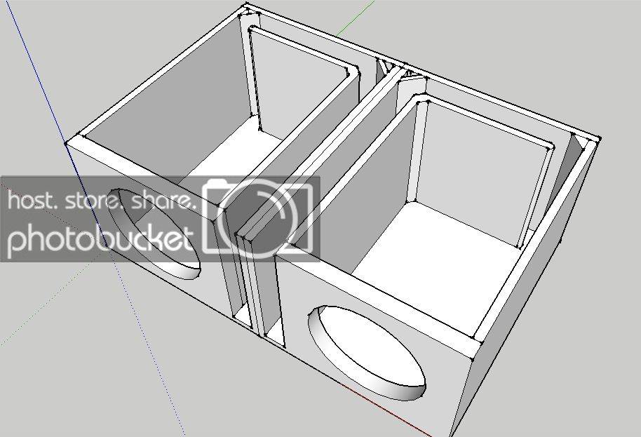

So its been quite some time and Im finally doing another real build. Running two SounDrive SDA3 12's. Had one in the trunk facing the trunk on 500 at 2 ohms. As of today I have two in the trunk facing forward on ~ 300 @ 4 ohms. This is where I need some input: It was much louder with the one 12 facing the rear. I have not sealed anything off yet. Any input as to why its so much quieter? I expected it to be at least the same as it was with the single 12 facing the rear.
Equipment specs:
2 - SounDrive SDA3 d1
1 - Alpine MRV 500
They are each in separate enclosures that are the same. 2.33 ft tuned to ~ 30hz 31-32 inches of port
Thats what Im guessing now. I took them out and played one at a time ( although facing the rear) at 2 ohms and each one played much better than the two together. I also tried with both facing the rear and it didn't change at all from both facing forward. I didn't think dropping 200 ish watts would make that much of a difference, although it maybe more from rise with two coils rather than just one.
