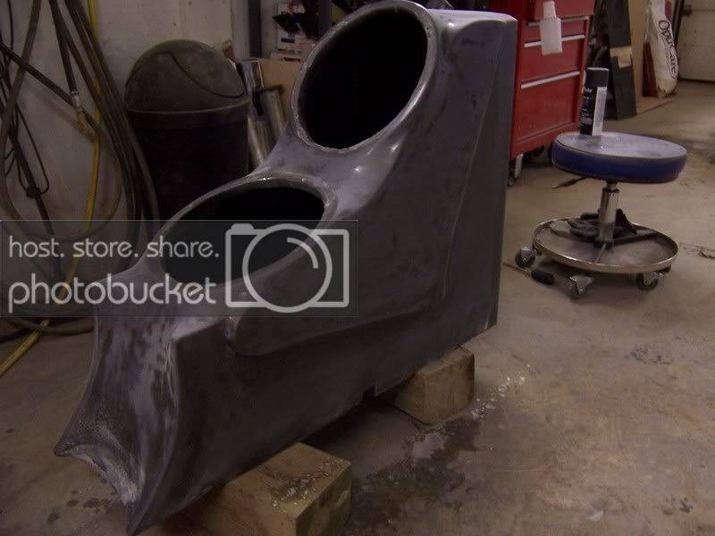

Also sold him my rear bucket seat and fiberglass speaker box along with my two JL Audio W1s and amp. The speaker box has already been repainted, did it a two tone with the color we are using and a SEM dye the same color as the interior. That is already installed and painted. Also this was my first ever fiberglassed speaker box I made. Built it a year ago.

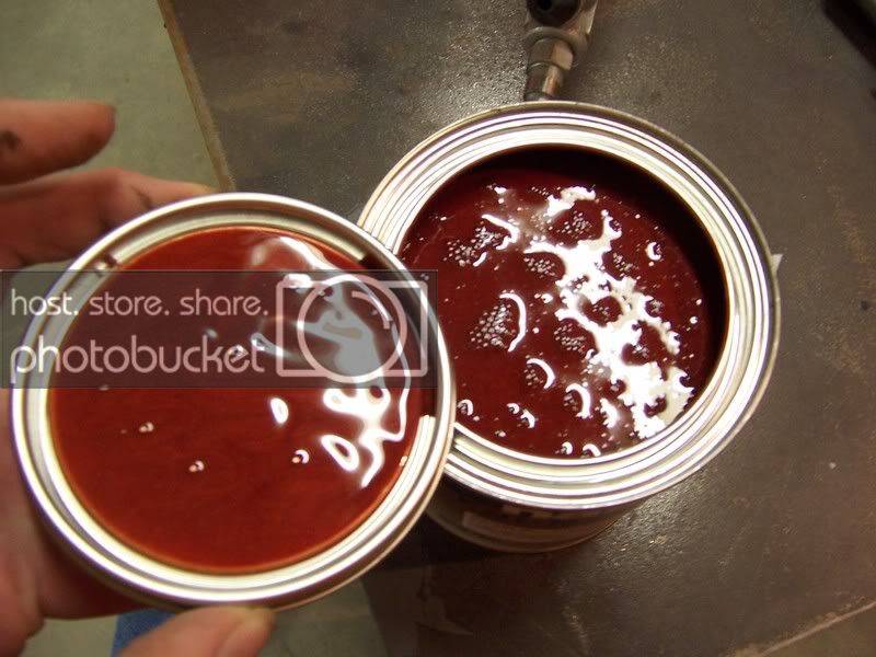

First off the paint that is being used for everything
Wetsanding the speaker box

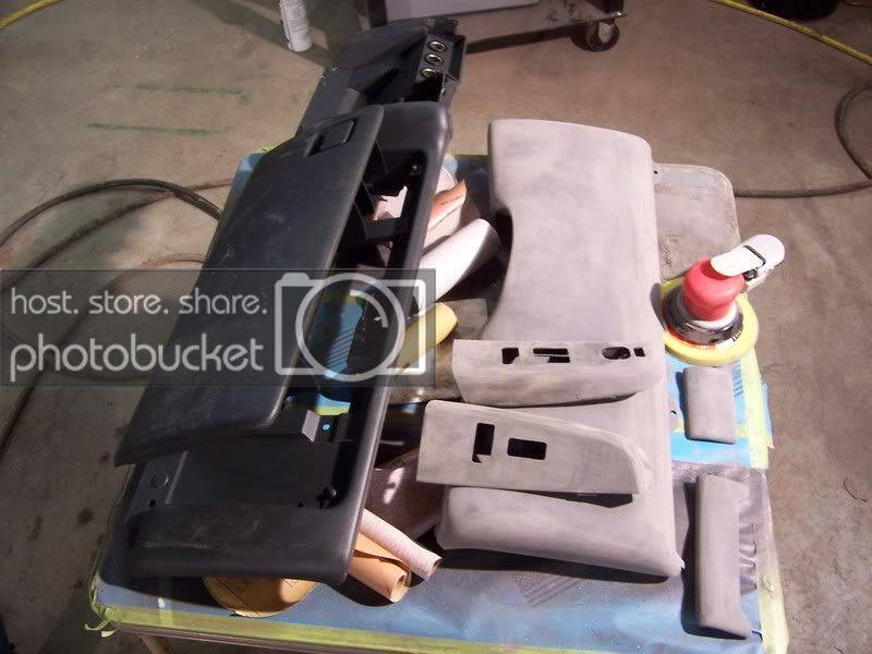

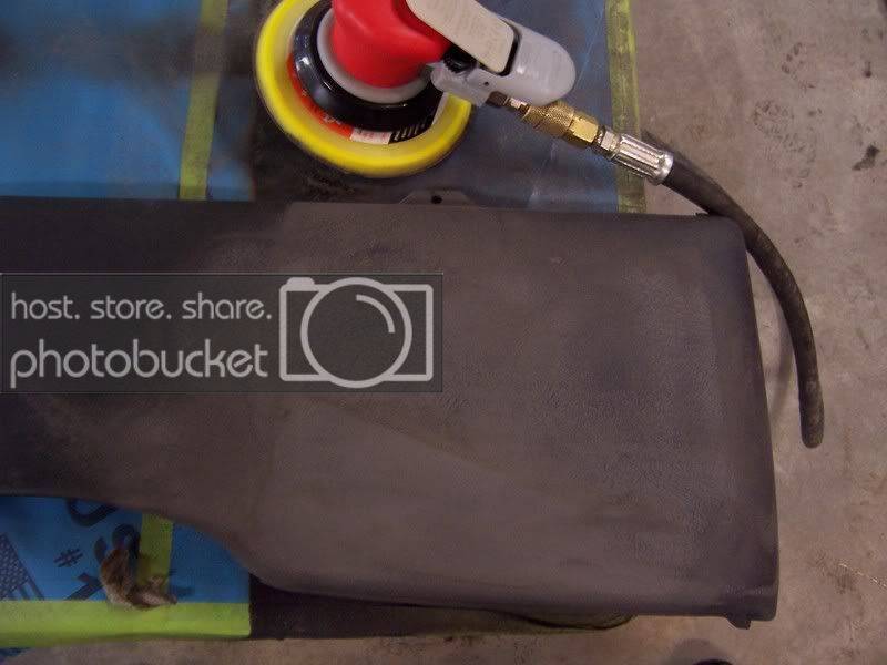

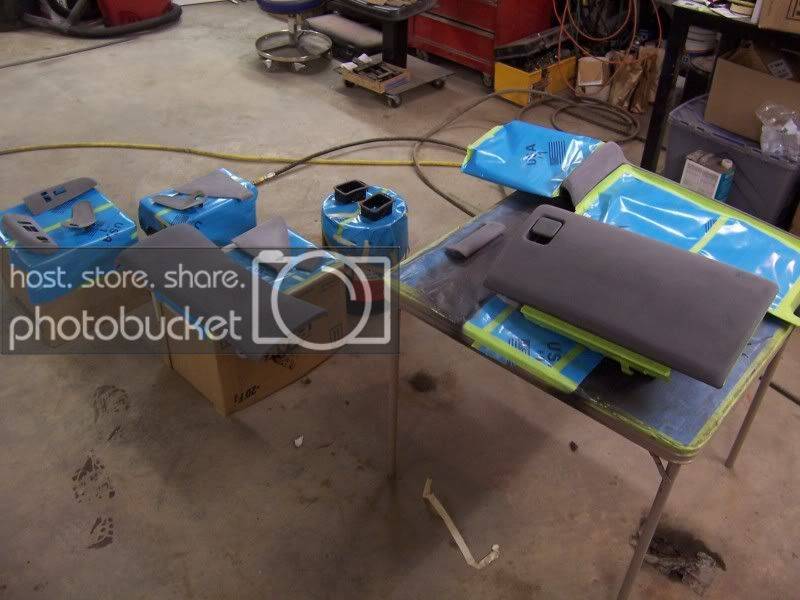

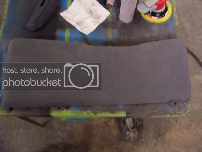

Sanding on the knee bolster piece. Starting off with 120 grit.

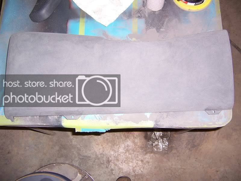

All sanded with 120.
Went over with 180.
Got the glove box apart and other pieces sanded

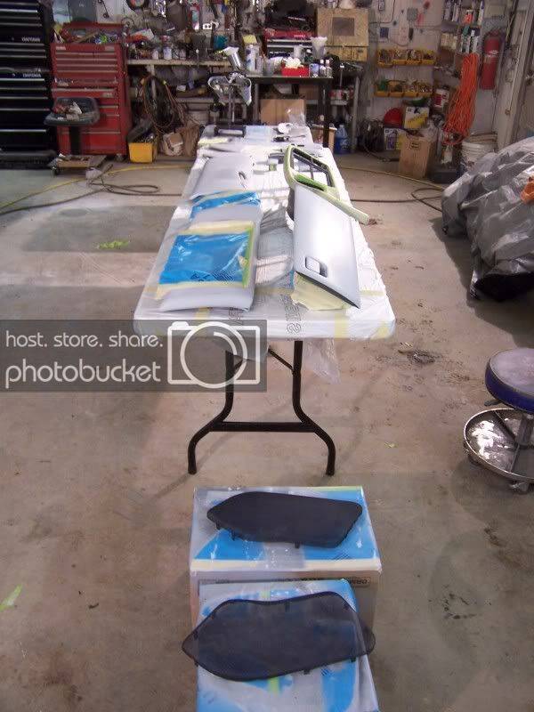

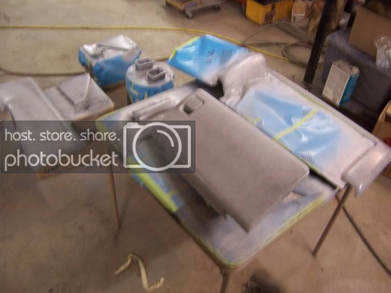

Priming:
All wiped down ready to be shot

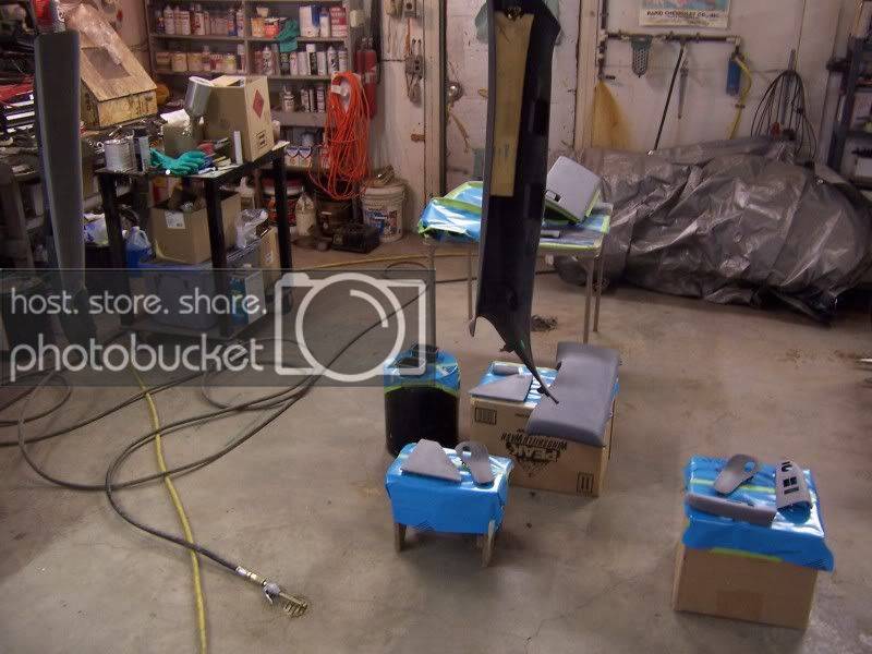

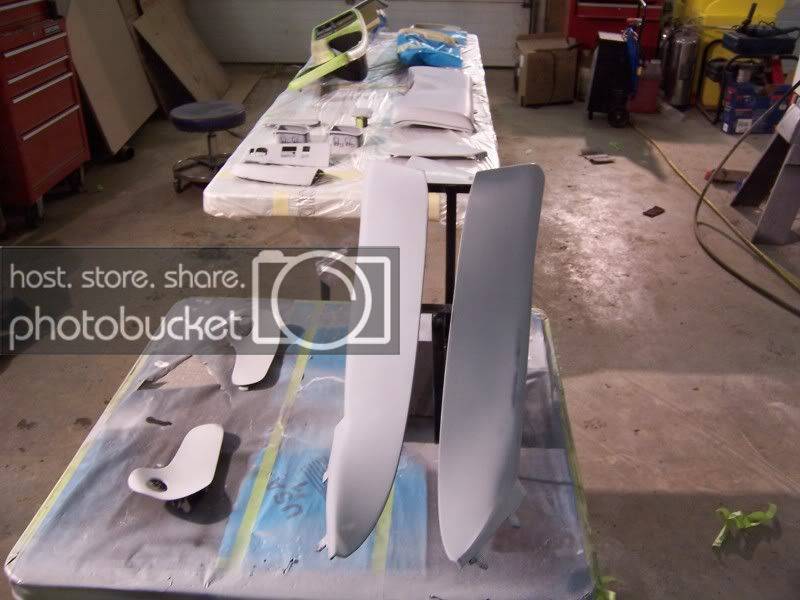

A pillars primed

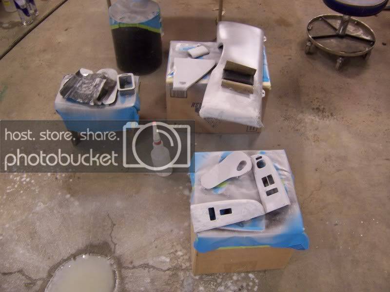

Wetsanding

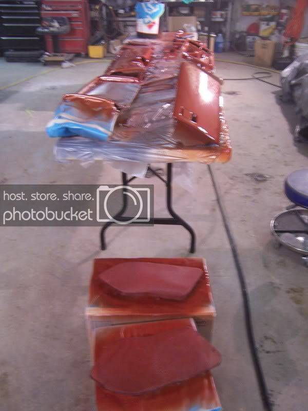

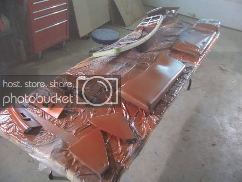

Painting This was done last night.
Everything wiped down ready for sealer.

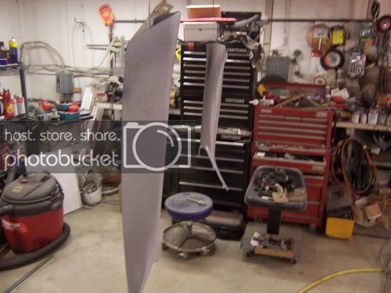

Note the little stand I made for painting/airbrushing the A pillars.

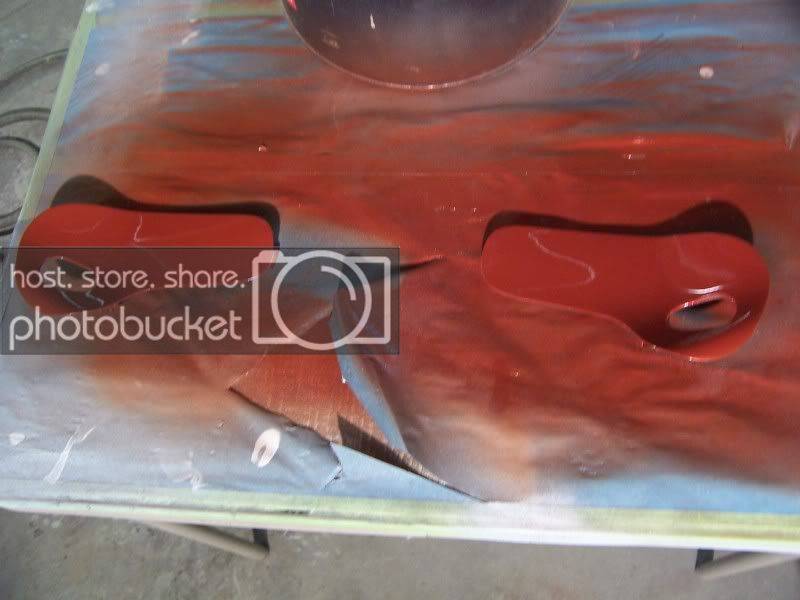

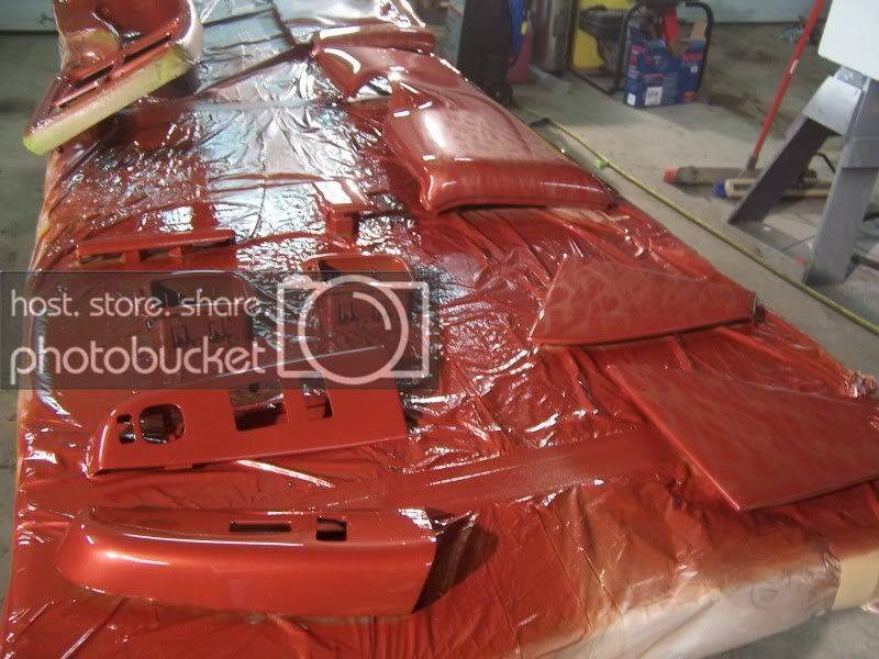

First coat of base.

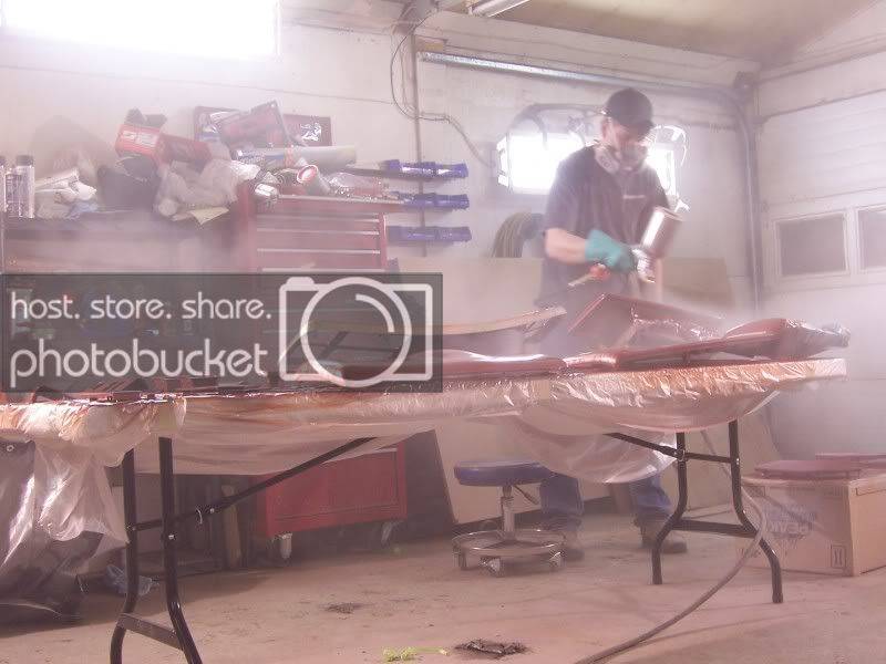

Me spraying the clear.

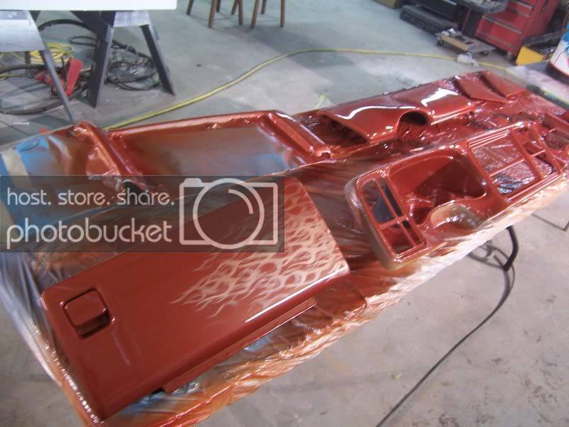

Done and cleared.
