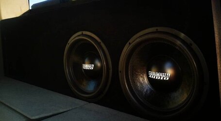

could just be the box's design is not good for your car.  Usually for trucks its subs forward port to the passenger door is the loudest out of every configuration other than walled or a really tall box with port up sub up.
Here is a pic of the box, one with sundowns is mine the other is one similar in better lighting
Okay so I ended up getting a good deal on a new AVH1400NEX unit, the dvd muiltmedia version. got it in and the system sounds a hell of a lot better. close to what it should sound like now I feel.. Thanks for the input!
