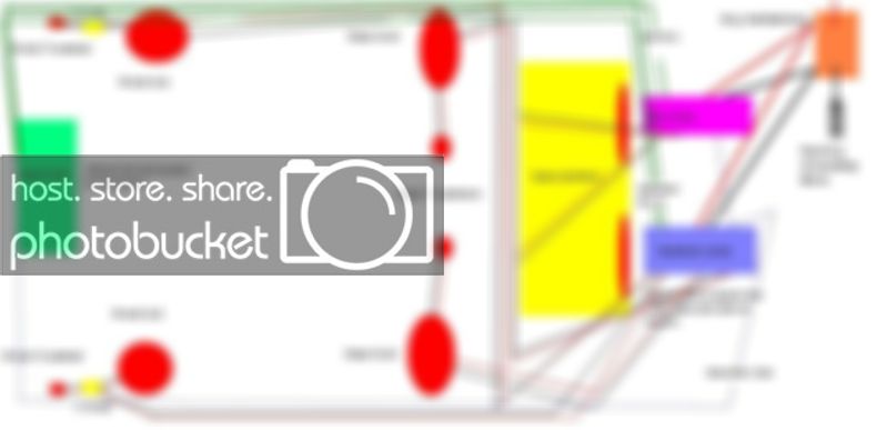

In my continuing battle with engine whine im down to 2 things. Either my rca cables are trash or the amp running my speakers is fubar. What I need clarification on is the way to figure out which one is effed. Im thinking I unplug the RCA's from the amp and turn the car and the deck on. If I hear noise then the amp is effed and if I don't then the rca's are effed. Am I right? or is there another variable im missing. Keep in mind folks, this is an 06 Pontiac G5, battery is in the trunk from factory so no power wire is running with my RCA's. I even went further and ran my remote on the opposite side of the RCA's. Another concern I had is, can speaker wire pick up engine noise? Thanks for all the help guys, im confident i'll get it figured out!

ive been thinking that the sheer fact that the amp is so close to the battery is probably the culprit. I don't think i can ever get rid of it. I bought 2 ground loop isolators, and before you kill me, they came highly recomended by my friend. As you could probably guess they did nothing, I think maybe making slightly quieter but not the silence im seeking.
Here is a rough outline of my system.
