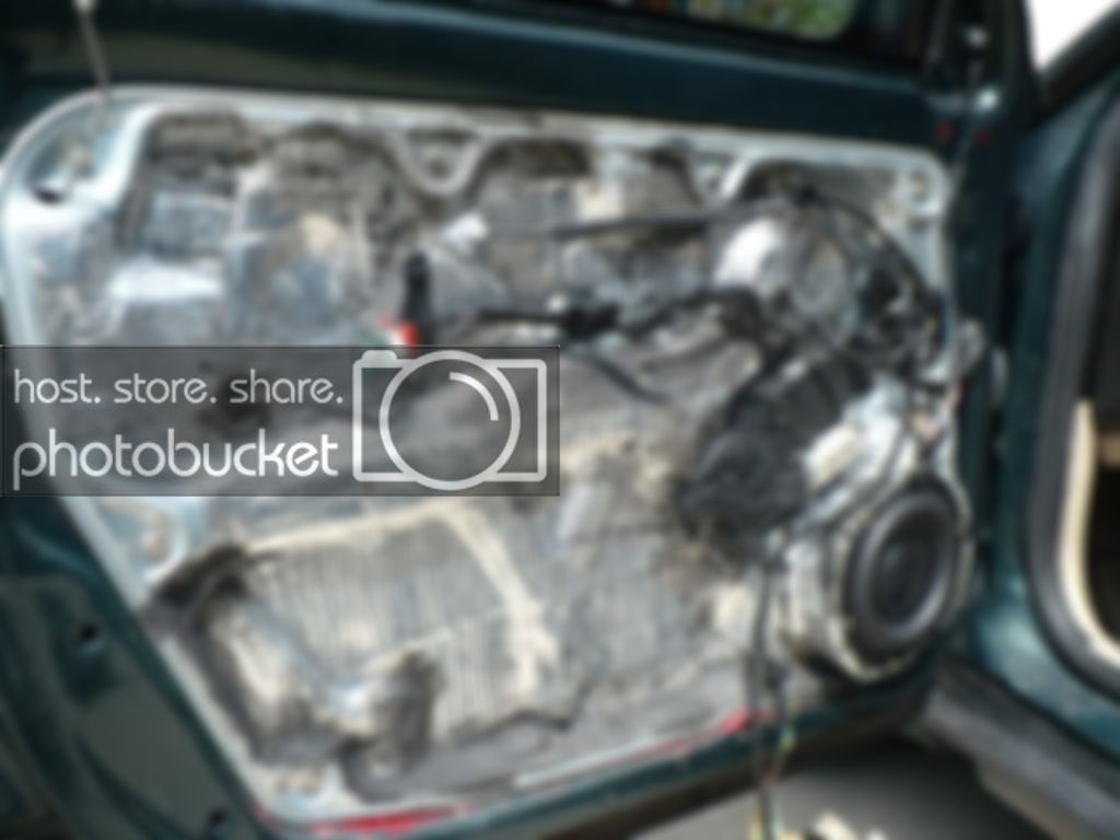

so your 98 is set up the same way as my 01? did you do this upgrade in your car how did it work for you?
Yes, 98-04.5 is basically the same thing, maybe some minor differences.
I swapped out the factory speakers a long time ago, worked out great.
I have different speakers in there now, but you get the idea. The speaker is mounted a 3/4" MDF ring.
did you use the plastic mounting bracket that came with your stock speakers or did you by pass that all together, bc in the pic it looks like the mounting bracket was still used but maybe im misstaken? i have alpine sps500 compoinents mounted to the mounting brackets right now and im waiting on a head unit to see how they sound but im fairly positive i want something better than sps 5 1/4
