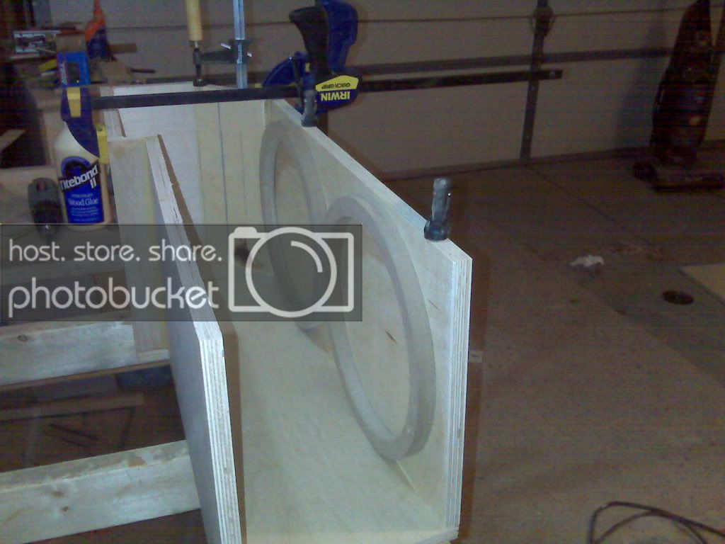

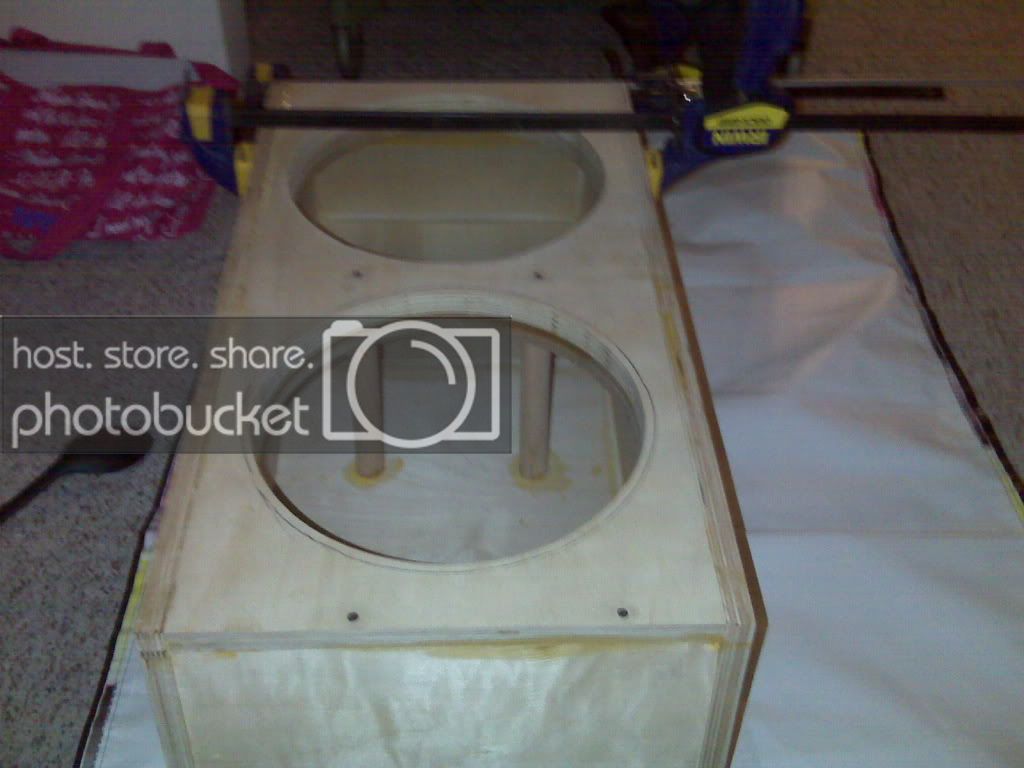

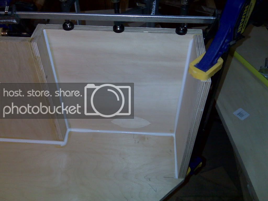

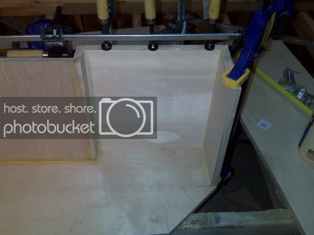

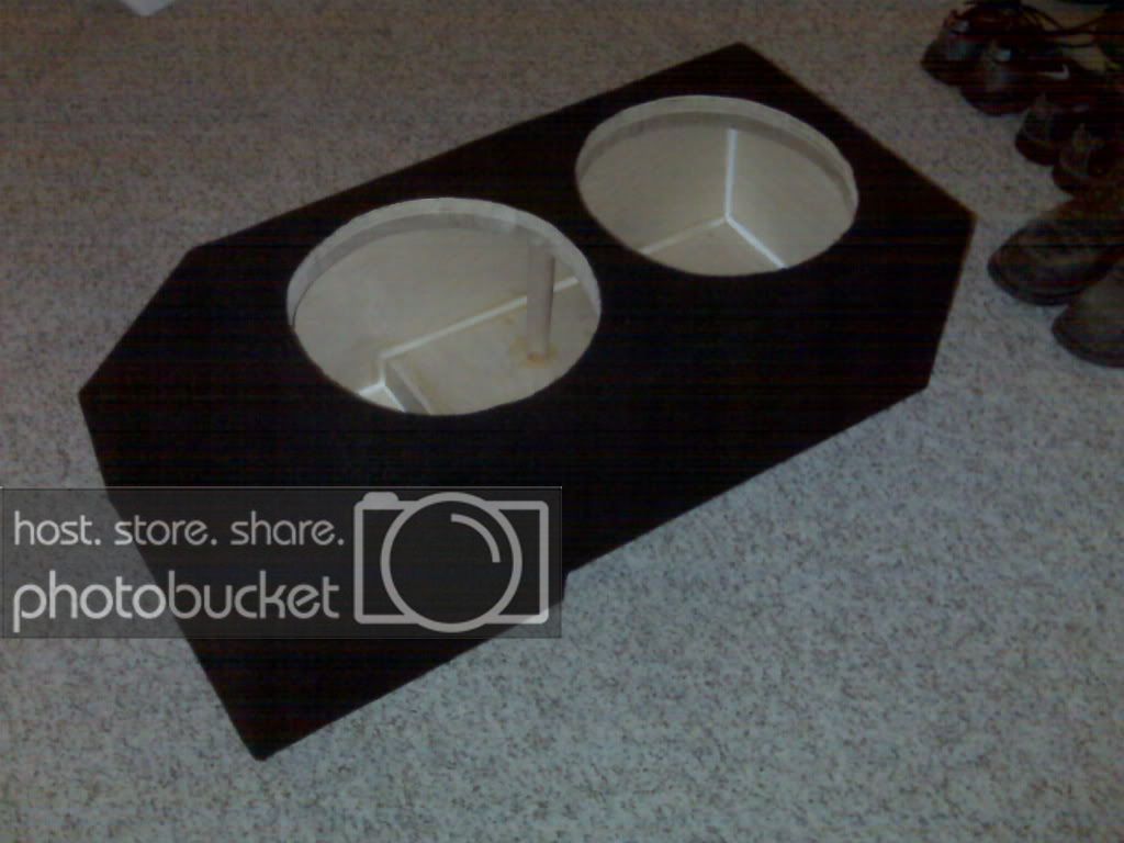

Weird shaped, birch, sealed box for 2 12" subs. Building for anther member here.
One of these days, i'll get a tablesaw.

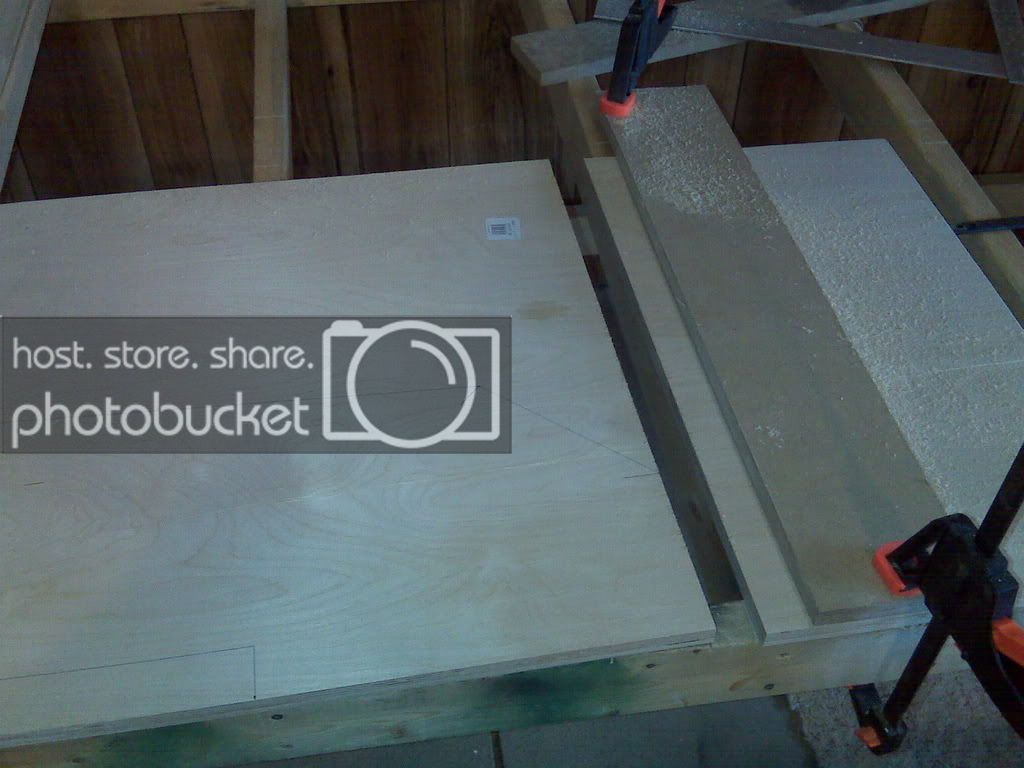

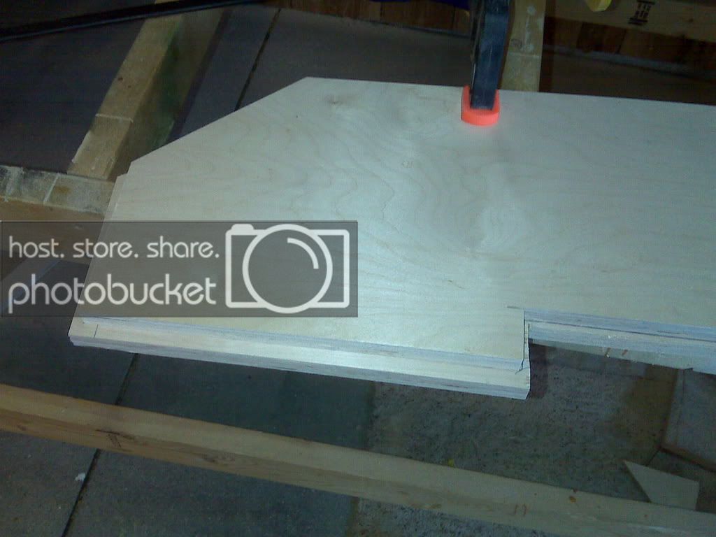

Best way to replicate an odd shaped pice...Get it close with a jigsaw and flush trim bit on the router FTW

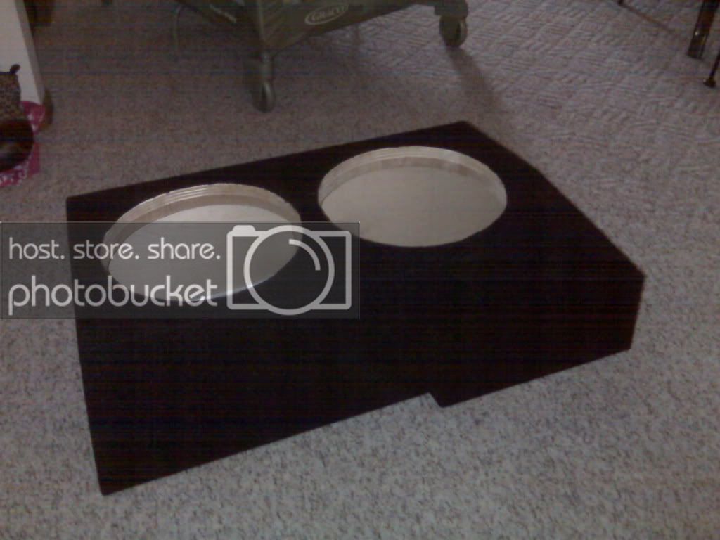

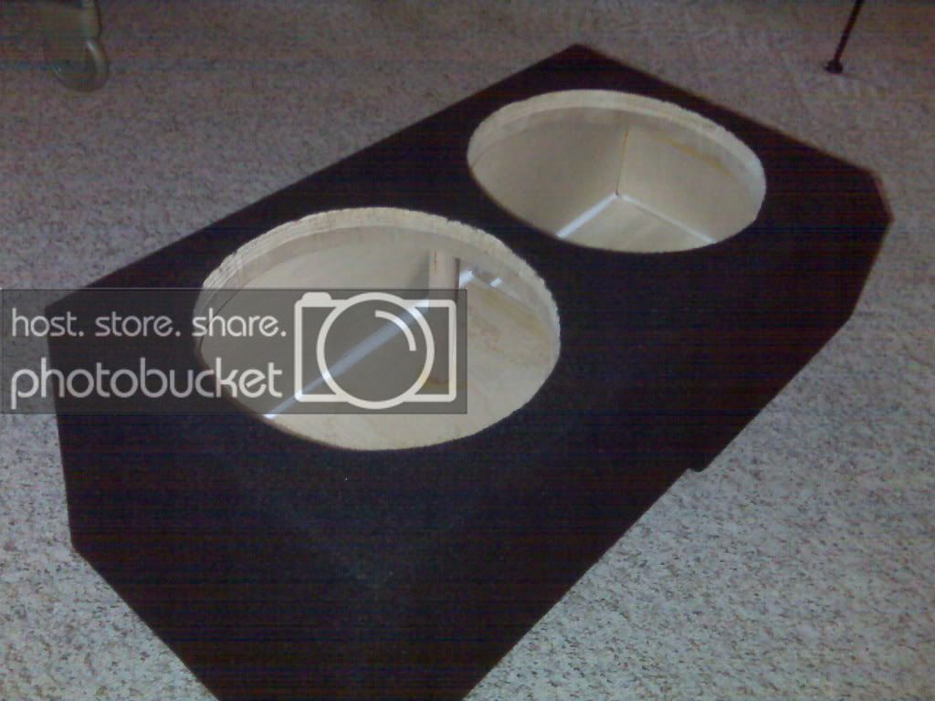

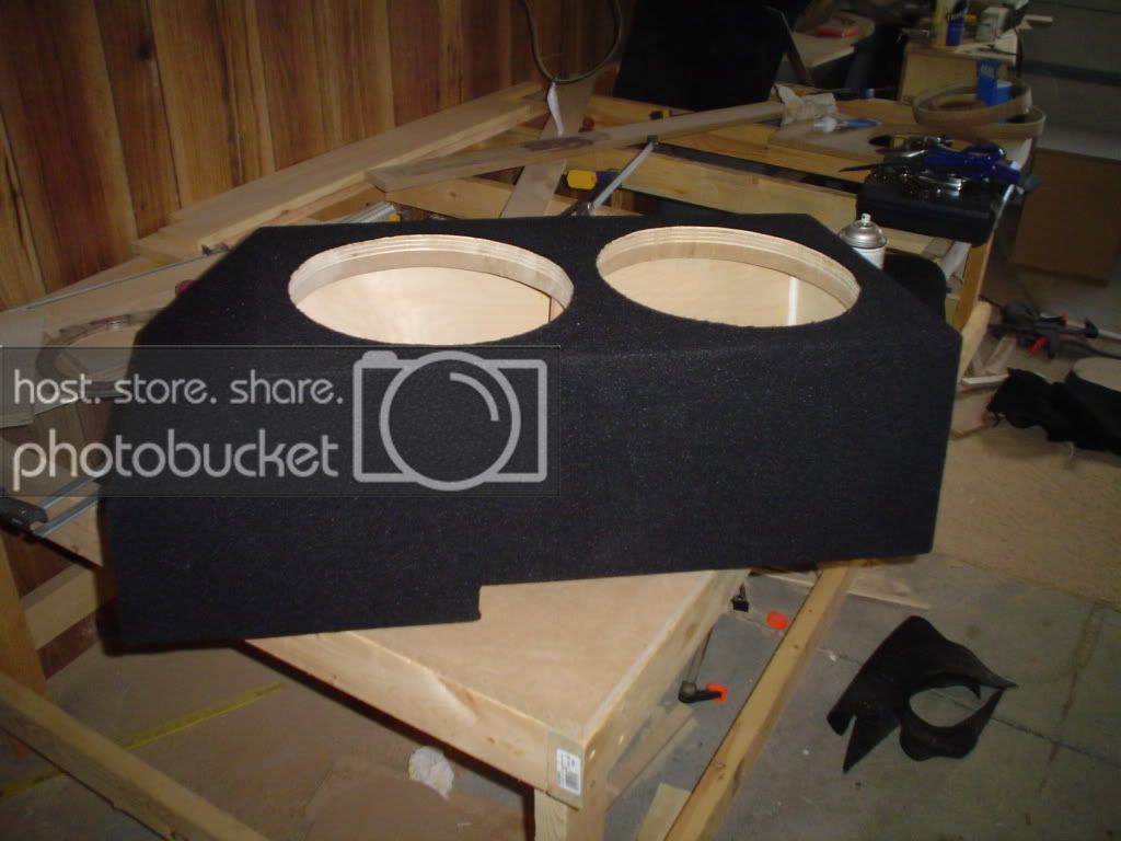

Looks great, looks like you also managed a great job on the carpet.
thanks....the carpet wasn't very easy either. Turned out great tho
edit: i never put my seams on edges of the box, they wear very easy when you put them there. I put all my seams on a flat panel
where are the seams? Im a total noob to this shit, just wondering how you make the seams so they dont look like shit
