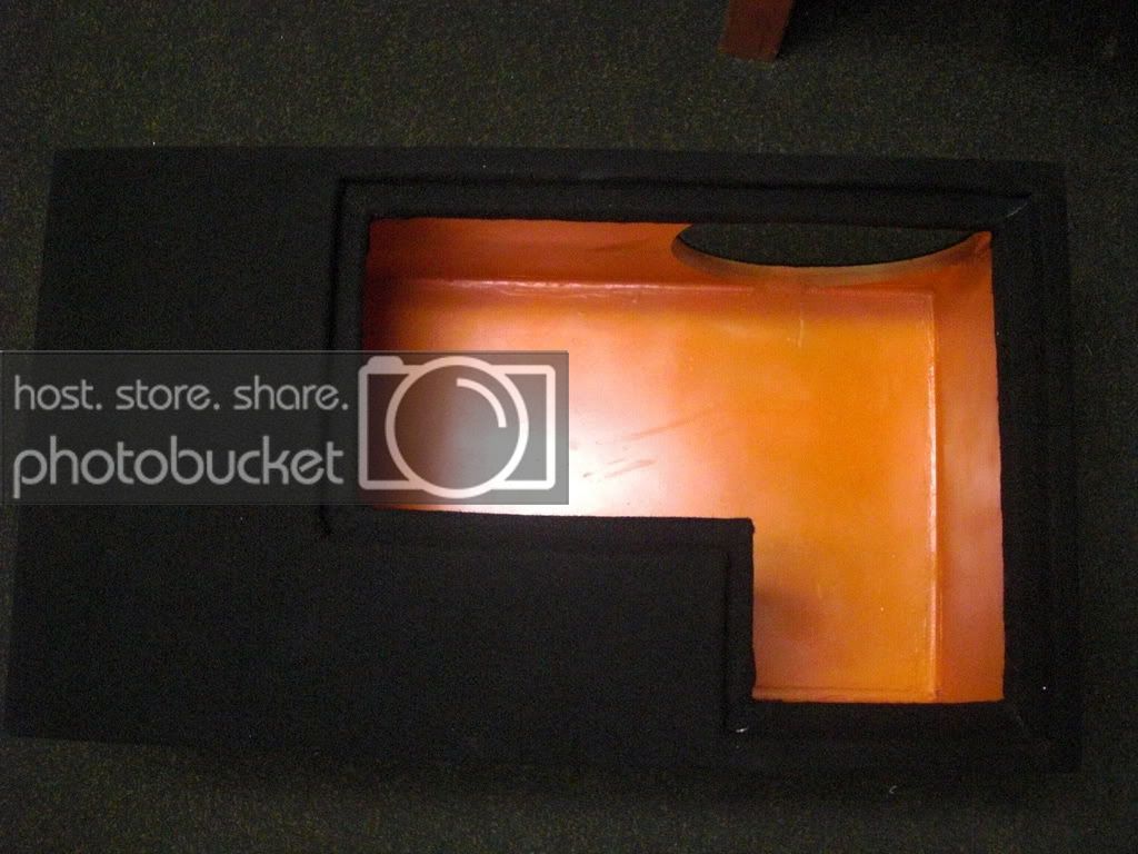

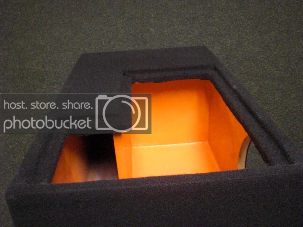

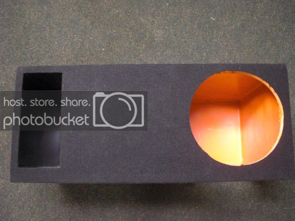

This is my enclosure i designed for my new 12"RE XXX D2 subwoofer.
33"x19"x13"
2.487 net volume
57.5 in^2 port area
32.67 hz tuning
This is my enclosure i designed for my new 12"RE XXX D2 subwoofer.33"x19"x13"
2.487 net volume
57.5 in^2 port area
32.67 hz tuning
That looks nice! Is that plexi? In the picture it kind of looks like it's just a big opening. That's about the same dimensions I'm trying to work with. You should inform me of how that sounds. //content.invisioncic.com/y282845/emoticons/biggrin.gif.d71a5d36fcbab170f2364c9f2e3946cb.gif
