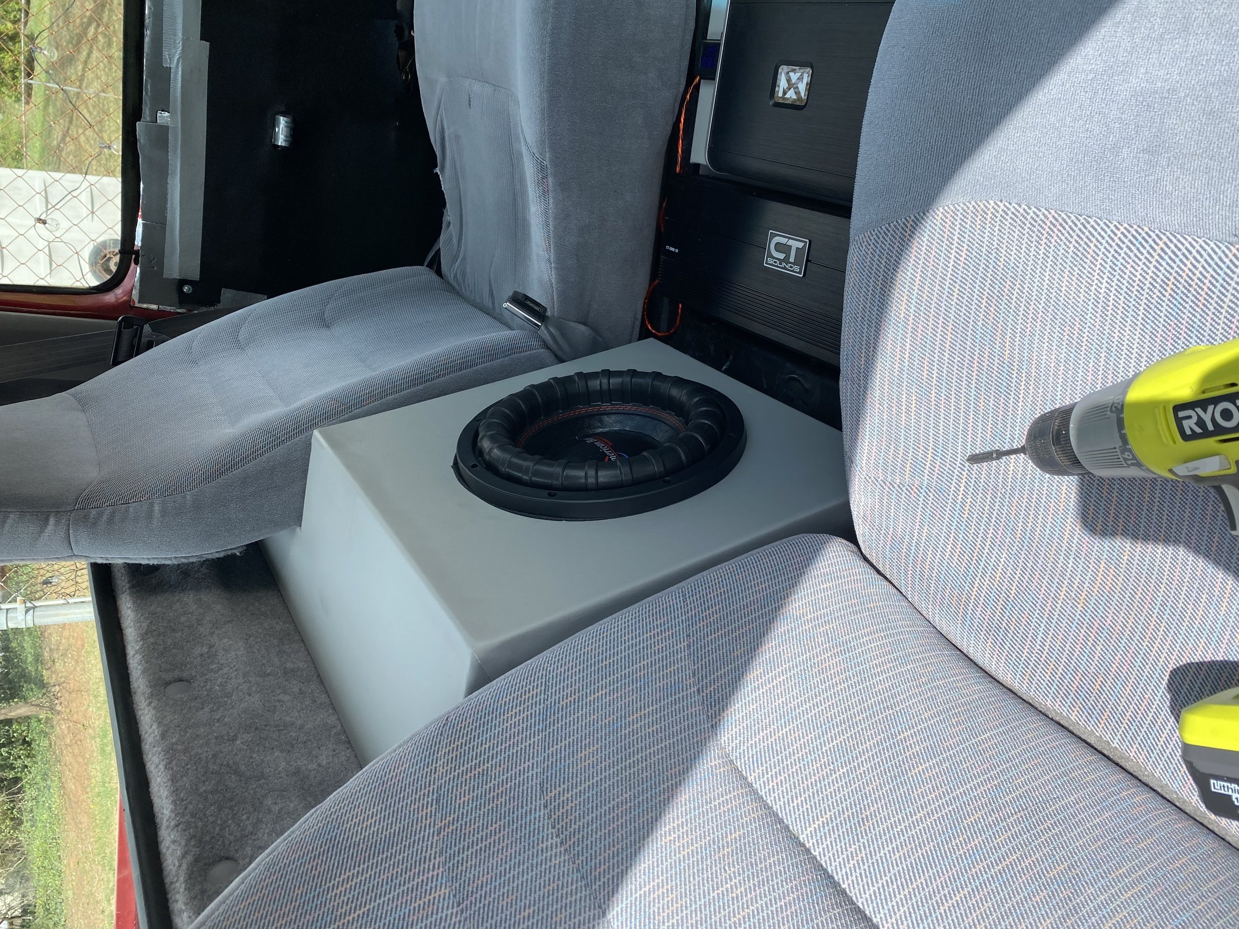

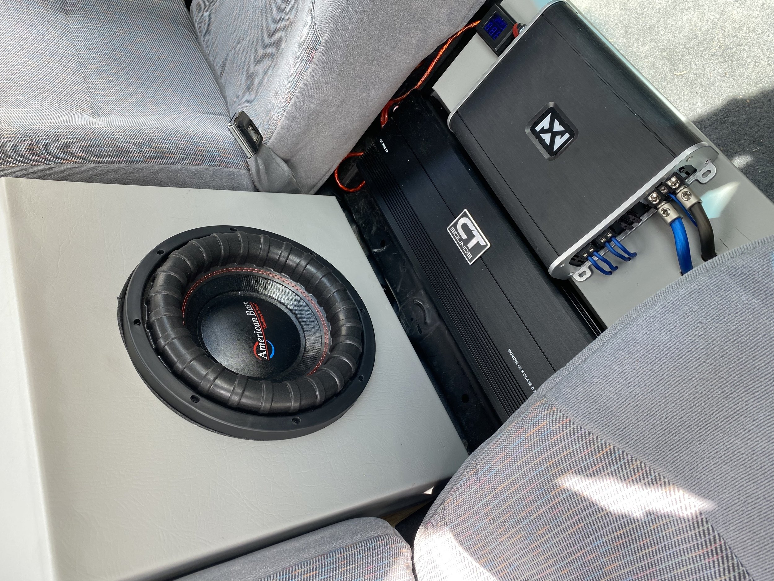

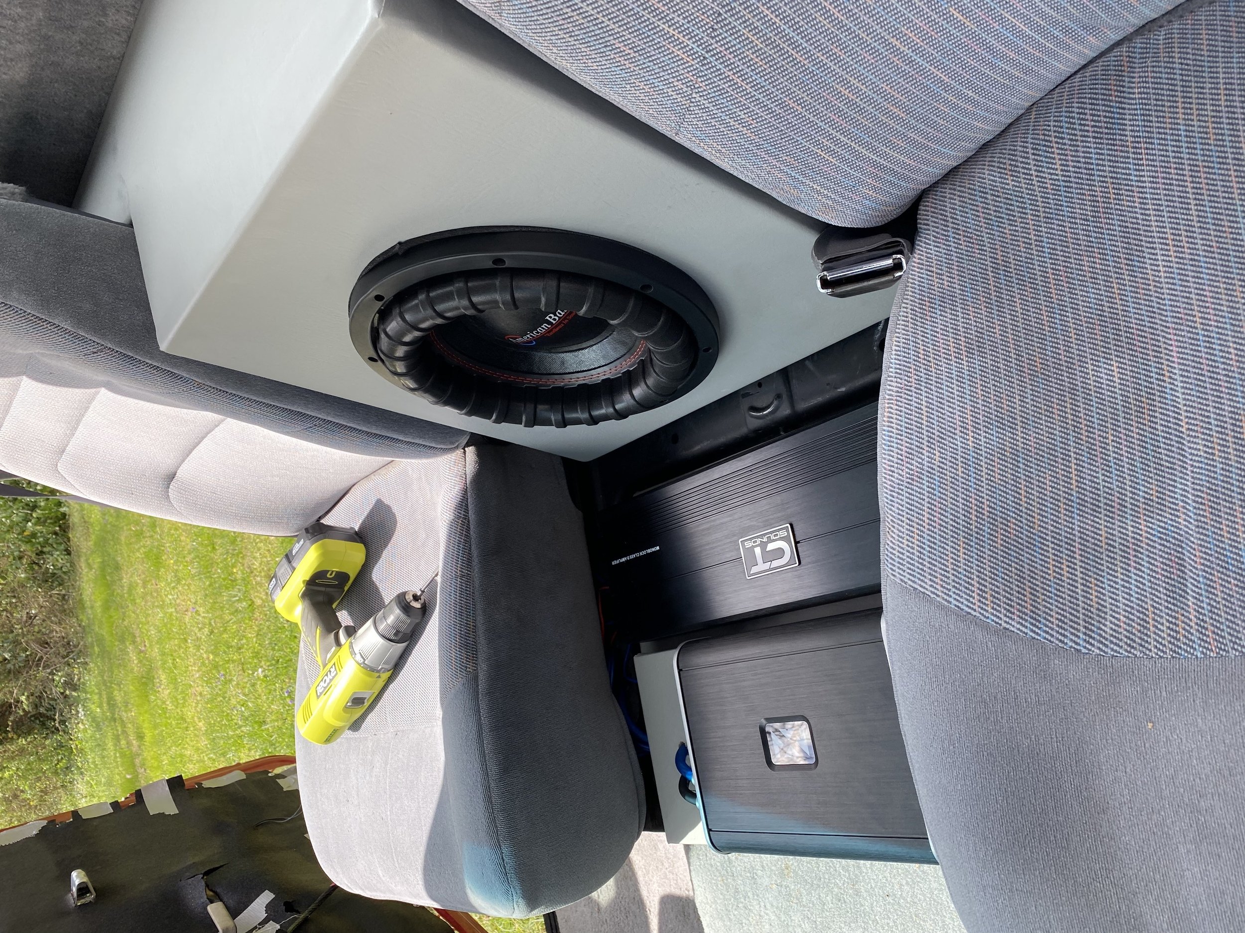

Current setup is American Bass xfl 10”

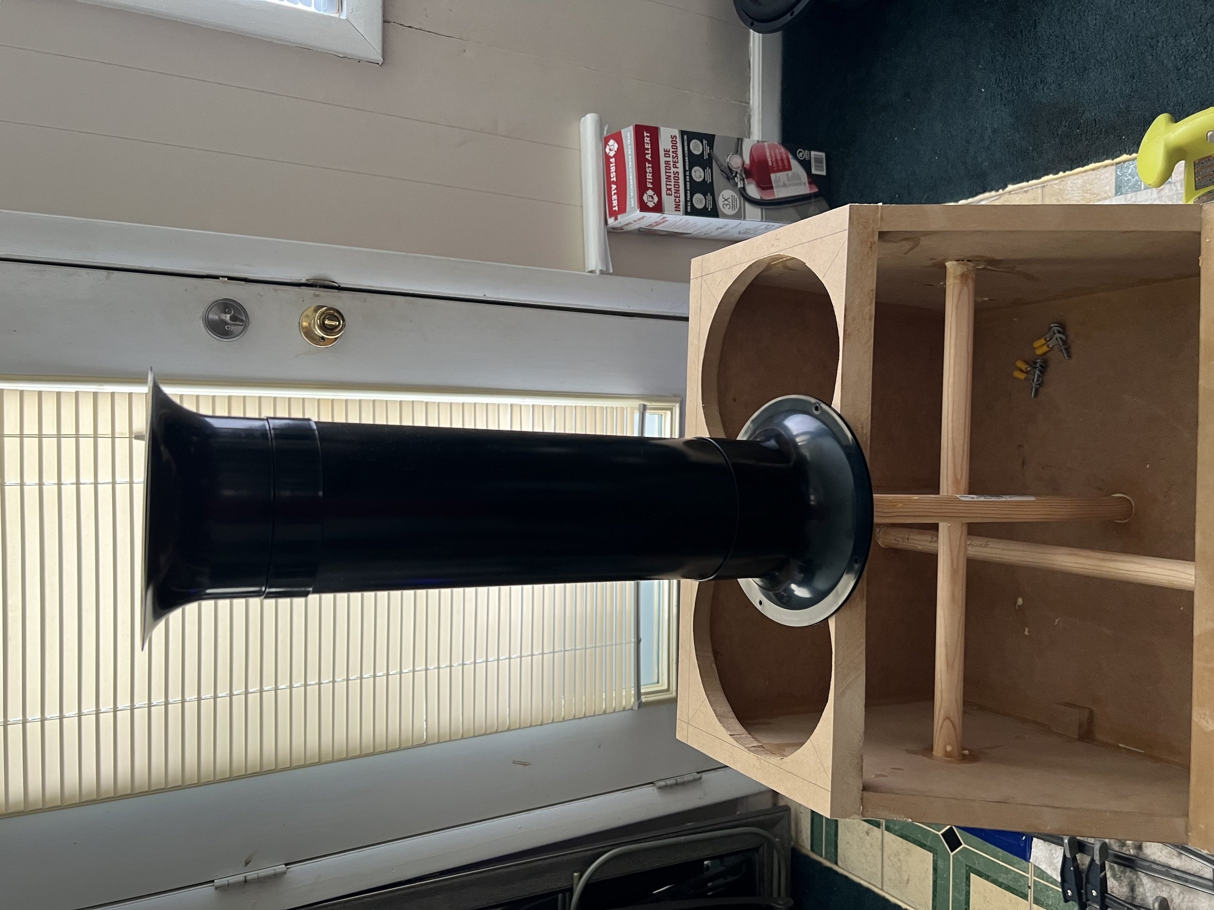

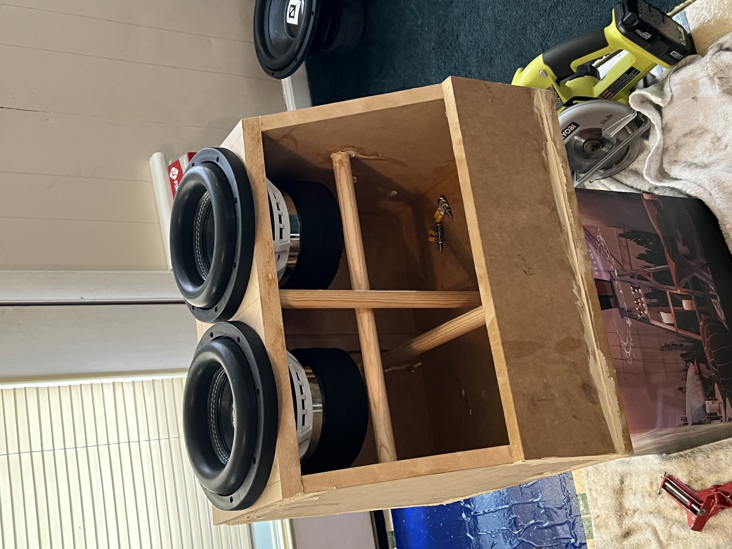

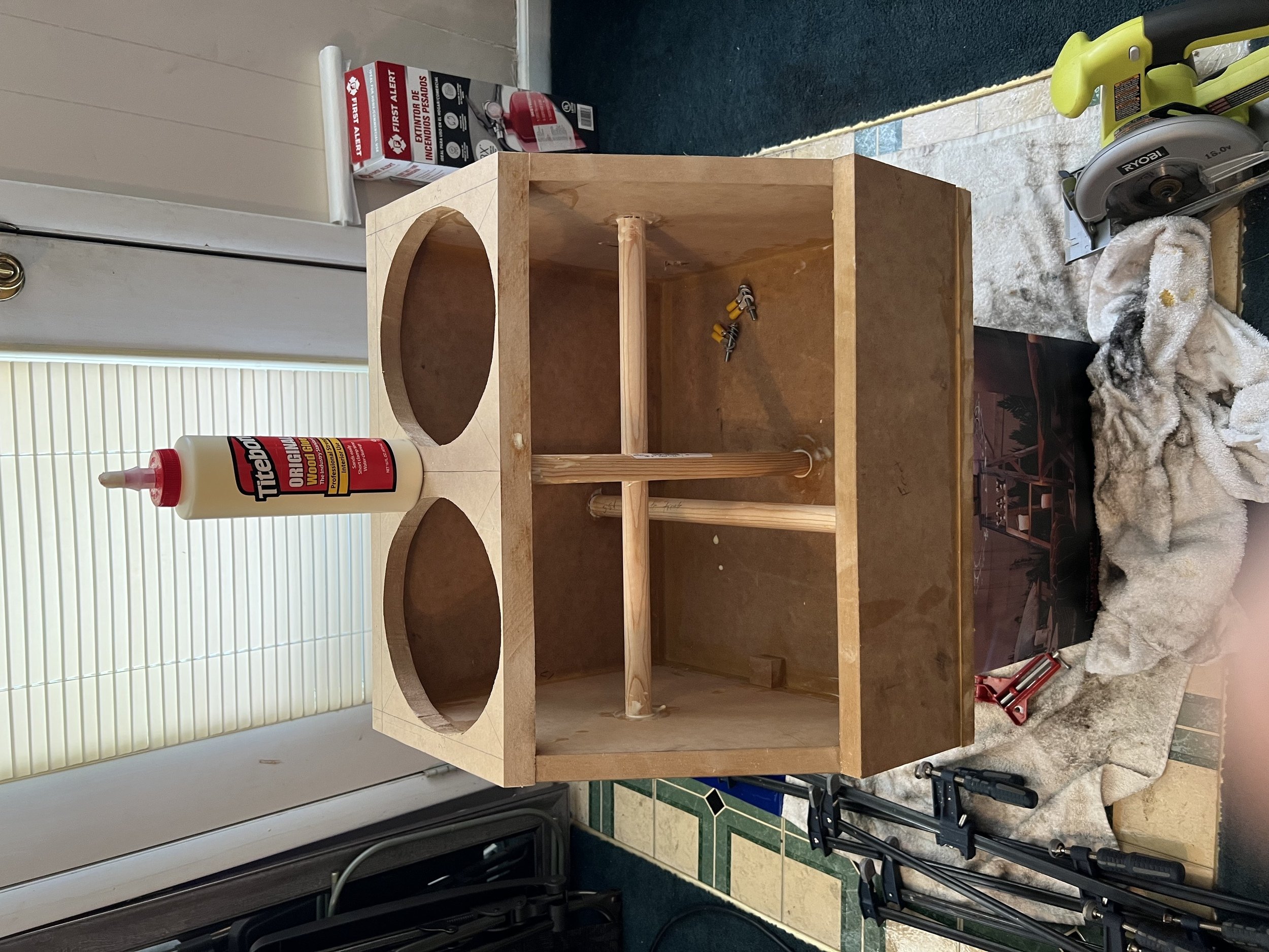

Switching it up to a pair of Ct Sounds Strato 8’s.
single cab truck, 2000 watts, foward firing vs up firing
Looks TIGHT man!! LOL. Curious as to how you like the 8s. I though about picking up a Meso8. Hows your 2k holding up??
I will definitely give my opinion of the 8’s.
Meso 8’s were An idea but I went with the Strato’s because of the box size.
.5 cubes per. Not sure how accurate that is but I am putting the pair in 1.25 net @32-34hz. Haven’t decided on the tuning yet.

American bass 10 currently in there sounds really good. Loud(to me) and really hits the lows. Just always wanting to try new things and want to compare a pair of eights to this 10 on same power. Skar 8’s before had Less power, and smaller alternator.
