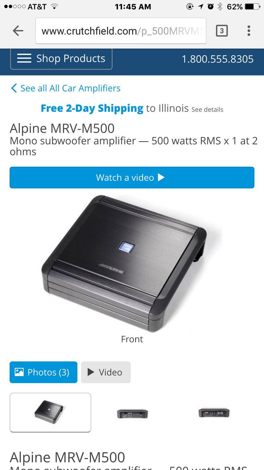

Would this be a good match for the Alpine MRV-M500 amp?

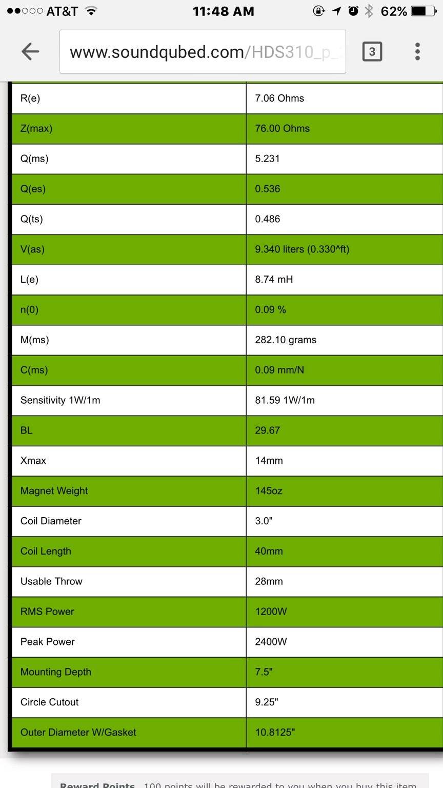

You know my problem seems to be a box. If I buy a specific subwoofer, I can't build a custom box for it, and I imagine it would be pretty expensive to have one custom built. I think these are around 130-150 without the box. Just the fact that it has a custom tuned box specific to that sub is kind of appealing. Or what do you recommend box wise if I bought the sub new? This sub is $150 on Amazon. I figured a box is at least another $100. This one the guy is selling is 3 months old with the box.
Id buy a BNIB Squbed HDS210,or 12,and have a tuned ported box made for it for under $200 bucks, and should sound really nice on that amp you have..Get a DVC4 ohm sub, and it will run just fine off that amp you have @2ohms mono.Trend boxes are junk in my experiences.You can get a cut sheet/design from a box builder for under 50 bucks, and have Lowes, or HDepot cut the pieces and you can put it together yourself easily with very min tools, and sound and perform 3-5 times better than that prefabbed box, and get a warranty on your sub..I think a BNIB SQubed HDS210 is less than 100 bucks shipped.You might spend a weekend with some minor tools to build a hella box that that sub will perform nicely in

The sub is probably 1200 rms and your amp is 500 rms X 1 at 2 ohms. Very underpowered
