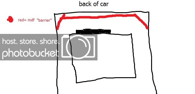

option 3: build a "barrier" between the sub and the back of the trunk, to act as a reflective surface and to block sound waves from getting to back of car
kinda like this:
I wouldn't make any kind of barrier, but that's just me. Anyways, I personally would just go with the sound deadening.

sounds reasonable. I didn't want to deaden the trunk if it would still have considerable rattle. but i guess i'll give it a try
has anyone else experienced my problem with facing the subs forward and losing some lows? Is it just because there was clothing used to seal and they didn't create a reflective surface for the waves? or should i build a box that's tuned lower for forward facing? it's tuned at 35hz right now
honestly man on a trunk i dont think anything really can be done about the rattle when the sub is loading off it. even with sound deadener. thats like with my blazer hatch, theres nothing i can do about the annoying *** rattle

it's wasn't trunk lid because it has two layers of sound deadener on it. and when i hold it down with my hand nothing changes. however, when i hold the rear bumper down the rattles stop. So i did some deadening today and found that there's openings at the back of the trunk that go into an air chamber where the rear bumper is. Sealed those off with some board and deadened the area. havent tried it out yet, but i have a feeling this will be a good improvement
