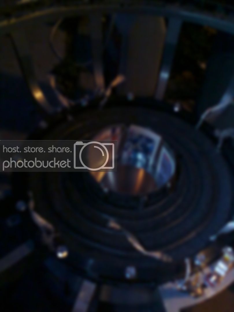

Woofer Rebuilderz , wut r using for gap spacers
hmm very interesting . . . hunterw nice job on ur truck by the way im thinking of doing three HW 15's cut thru , need some more batts first tho
thank you. //content.invisioncic.com/y282845/emoticons/smile.gif.1ebc41e1811405b213edfc4622c41e27.gif. really you can uise just about anything. as long as the coil is centered and is very snug
Sheets of paper, trimmed if needed, and as many sheets as the gap needs. This provides for equidistant spacing, keeps it as tight as possible, and is easily disposable... or reuseable if you want. It's generally readily available whenever you need it...
