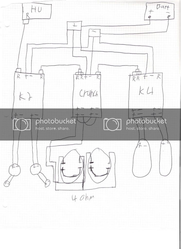

Wiring.
does this look right?
R is for RCA...
sorry for the sloppyness
And what in the HELL are the things at the bottom right?
OK I see
The only thing i see a little fucxed up is the wiring on the CRUNCH amp to sub
well the only advice i can offer from that diagram is that you dont need a distro for your ground...or you can if you want you just dont need to run it all the way back to your battery...just drill a hole in your trunk and ground to the chassis. You can still use the distro and just ground the 1 larger wire.
well it's just that I have plenty of 4 gague and like 20 feet of 8 gauge... plus I don't feel like making a ground....
that's what I got for the subs for 4 ohm...
and ground wires are recommended to be what 3 feet?
so since you don't feel like drilling a hole and attatching a ring terminal your sacrificing current...
:p
meh, 4 gauge ftw... I have the ring terminals...
your deck only has 1 set of RCA outputs?
that's cheap JVC for ya
