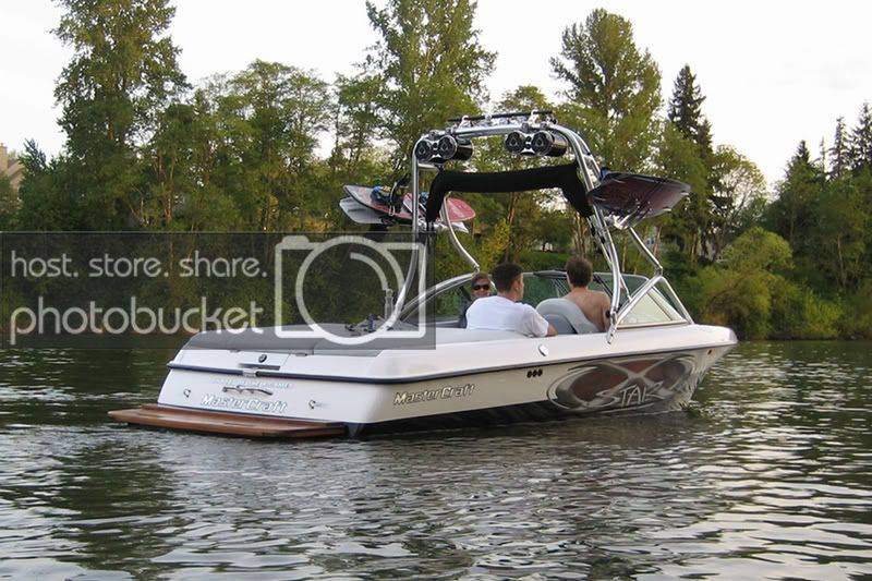

You got any pictures of this boat ?
yeah, unfortunately they are 3 ohm They did that to get more power out of the amps. Does you no good though when you want to double up. I was originally told they were 3 ohm by the stereo shop where I bought them and then verified with Kicker tech support.
Sorry, no pics of the new one. It's a '04 X-Star. Here is the old one I traded in:
