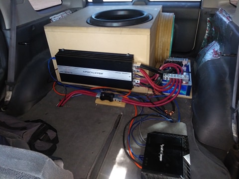

Yours looks fine same size wire. Its when you go from larger wire to smaller wires one would want to fuse.
Wow... you sure got some preconceptions on the needs/whys regarding fusing.
lol... same wire size?
In the system pictured theres 3 amps there and 1 uses dual 1/0 guage, 1 uses 4ga and 1 uses 8ga.
