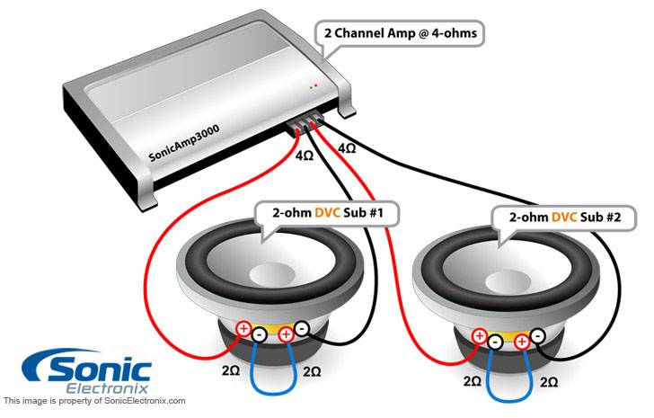

I just want to know all of my available wiring options and what the output per sub would be. It is a 2000 watt 4 channel amp that is not 1 ohm capable. The sub setup is (2) 2 ohm dvc 1000 watt rms
If you can help me I would very much appreciate it, I want to be able to get as much power as possible through those subs
If I got a 1 ohm capable mono amp and then got dual 1 ohm subs would I be able to make the load 1 ohm and then get 1000 watts through each speaker?
Wire them to 4 ohm and bridge one to front and one to rear

This.
And here's how you'd do that:
If you got two dual 1 ohm subs you could wire them a couple ways to ultimate get the final load at 1 ohm. If you have a monoblock truly capable of 2000W @ 1 ohm (and the electrical to support it) attached to two speakers wired at a final impedance of 1 ohm they'll split the power and should get 1000W each.
Nice that's what I want to hear. I think I'll go with the dual 1 ohm subs. Would I have to do the big 3 switch?
I would, definitely. You can try it without but you'll probably get bad voltage drop. The Big 3 should help alleviate this.
