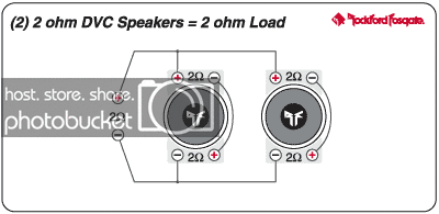

wiring geniuses! i need your help.
im taking it the subs are both dual 1 ohm? if so, this will give you a 1 ohm load.
thats the one i thought i would use..but..how would i wire them together? wouldnt i need a wire going from one coil on one sub, to one coil of the other sub?
or do i split the initial wire comming off the amp into 2?
makes sense. i thought about that before, but how could i go about doing so? any helpful suggestions?
im using 8ga wiring for my subs, and my terminals only allow 1 8ga max per terminal, so is there any way to do it the "right way" or do i just go for it give it hell, mash twist and thread 1 piece of 8ga in both sides of the terminal and put tape around it?
i like to solder the wires together but thats just me //content.invisioncic.com/y282845/emoticons/smile.gif.1ebc41e1811405b213edfc4622c41e27.gif. but twisting the wires together will work too.
ok. i know im being noobish but i want to make sure its right. so i peel back half the 8ga (essentially making it 12ga) on both wires, twist it so its 8ga size and shove her back in, and trim the excess? and tape, of coarse.
excellent.
it pulls the job more than perfect. it just kindof happened a few systems ago that i used 8ga for my subs, as i was ready to wire everything thats all i had, and it fit perfectly. **** sure no loss of current
