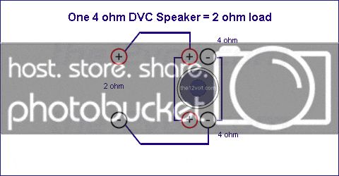

also how do you know what to chose on the amp 1 ohm 2 ohm 4 ohm? My sub is 4 ohm so how do you change it to 2 ohm?

Here's how you wire a 4 ohm dvc sub to 2 ohms.
