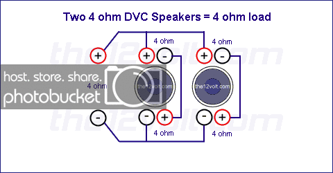

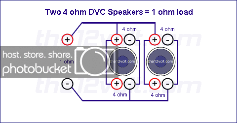

Dude, wiring a pair of subwoofers has nothing to do with opinions. You have a pair of 4 ohm dvc subs, that means they can be wired to 1 ohm:
or 4 ohms:
They're 300 watts rms, which means you'll need 600 watts rms OR MORE @ 1 or 4 ohms for the pair. Once again, no opinions needed.

Once again, wire the subs to 1 or 4 ohms, just as I've shown. Then choose a sealed or ported enclosure based on your listening habits and/or preferences. Finally, look at the websites I linked and choose an amplifier that looks good to you (600+ watts rms at whatever impedance you decide to wire the subs to). Ask questions about that specific product.
