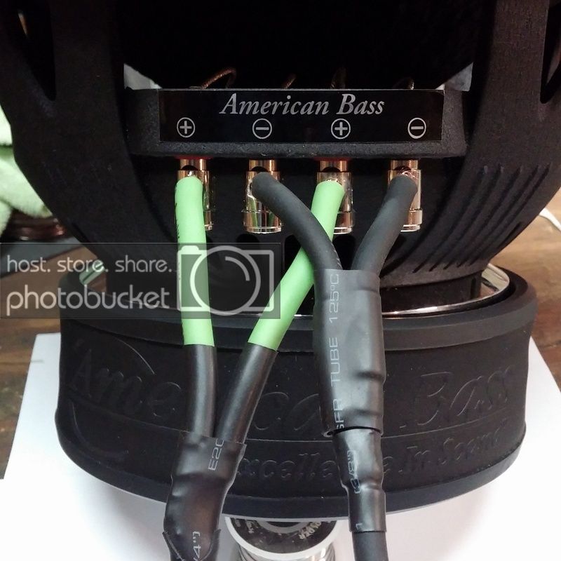

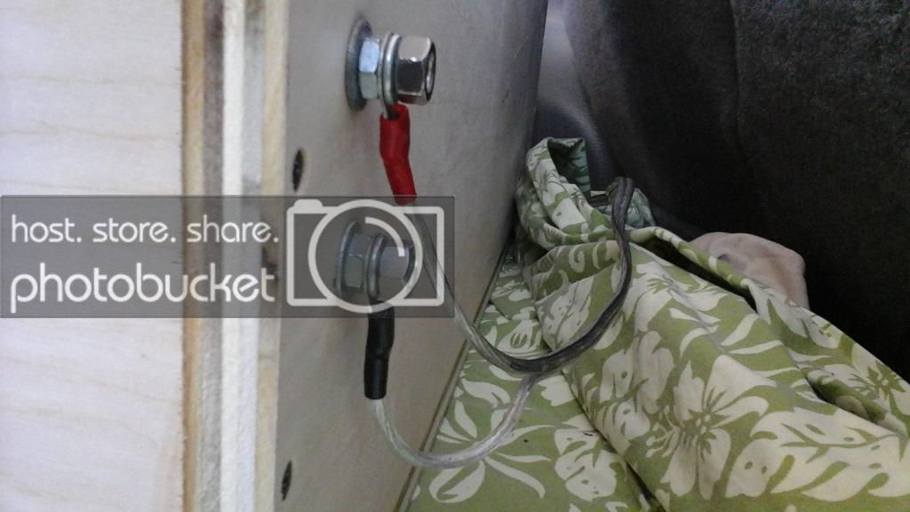

I use 4 bolt terminals per sub and have each wire going to its own bolt, then I'll take short pieces of wire with ring terminals and jump the terminals to set the impedance. Pretty much like you u would wire direct leads. My zvx8 has the smallest push terminals I've ever seen, they will barely hold 2 pieces of 18awg twisted together. You can also do your jumper on the outside of the box to change your impedance on the run. I'm actually going to be mountong it in the new box in a little bit, I'll snap some pictures of how I do it.
My xd8's were direct lead and I had 4 wires with ring terminals per sub. Only needed 2 bolt terminals since it was parallel/parallel.
