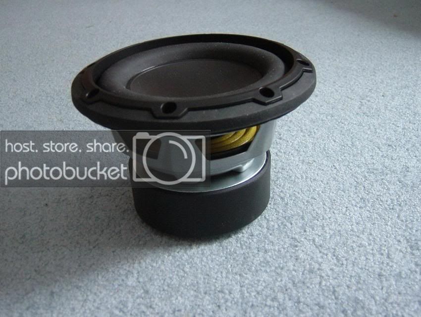

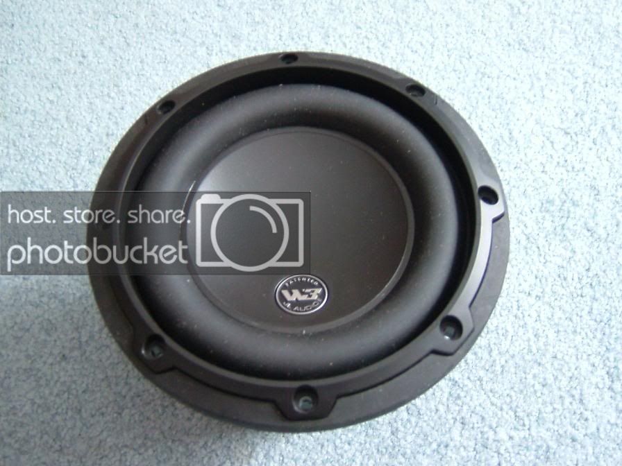

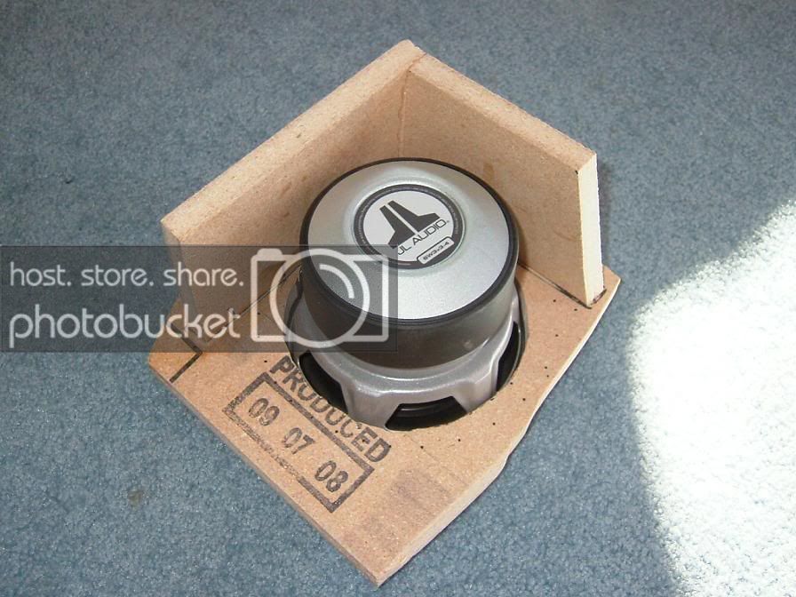

Here's the sub. There are two of them:
I'm making two seperate boxes for under the dash and in front of the cup holders. I'll need to cut out the small shelf to make room. One box wouldn't work because it wouldn't fit into position.

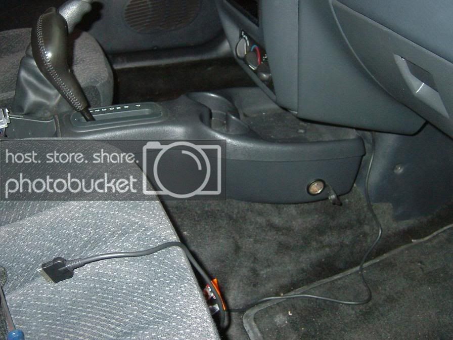

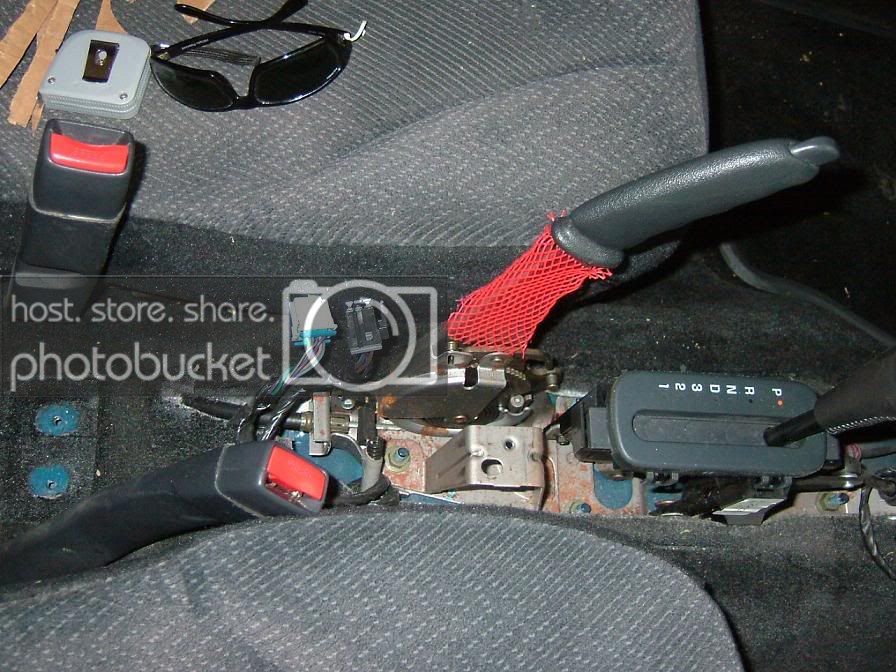

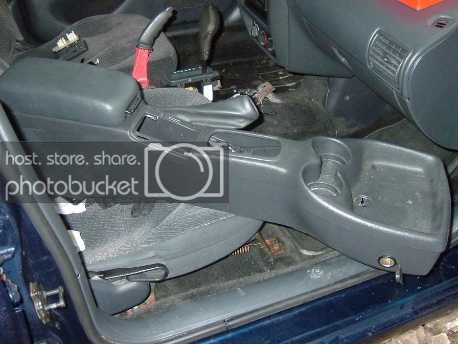

Four bolts and the center console comes right out.

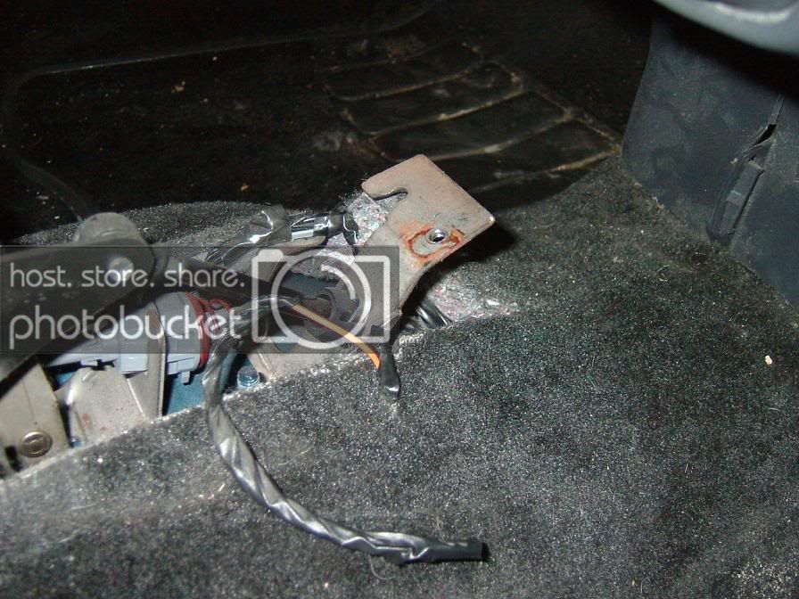

This metal piece that part of the center console bolts to will need to get out of the way later.

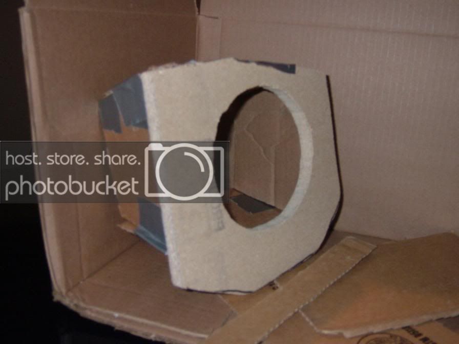

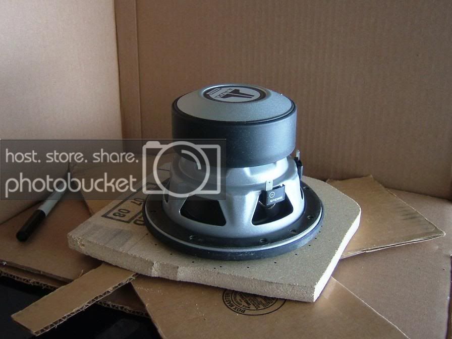

Starting to make the front face of one box.

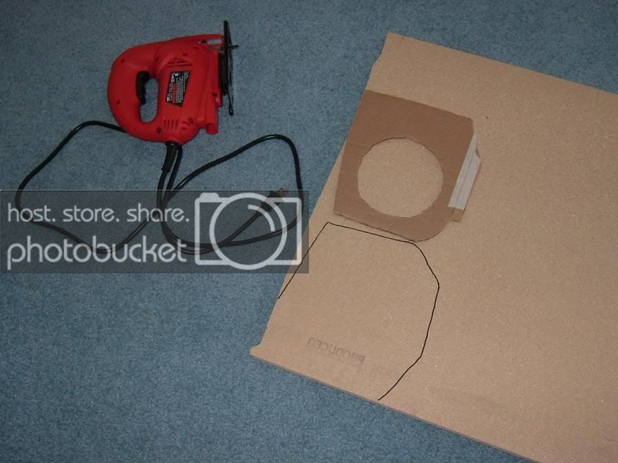

Cut out the circle with a coping saw.
