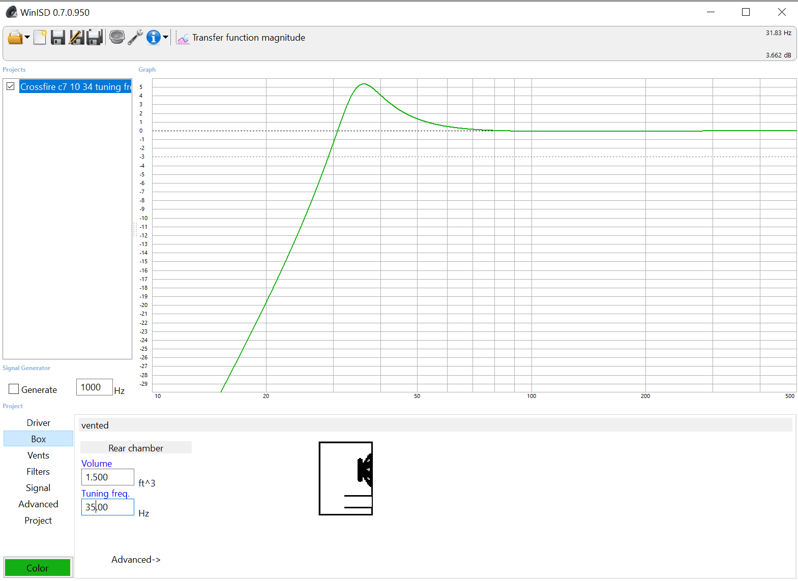

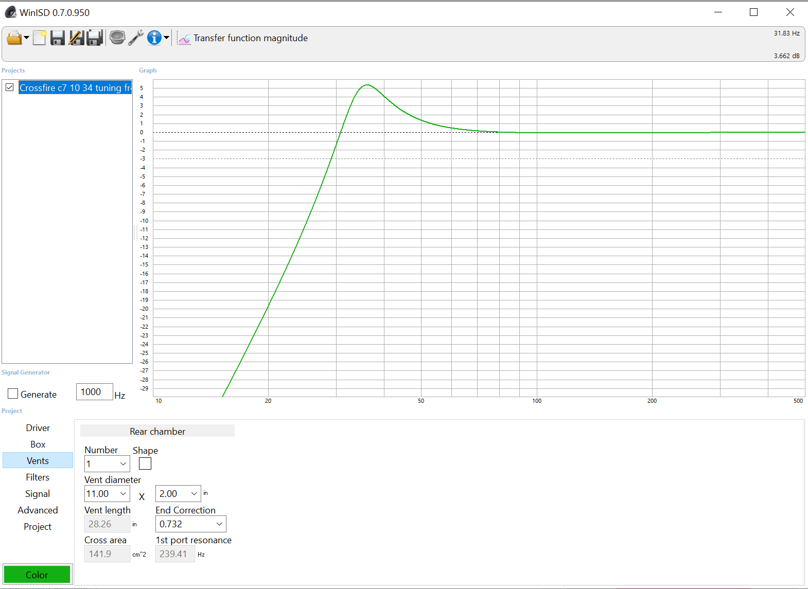

designing a box for a crossfire c7 10" plan on using the recommended 1.5 cf volume and tuning to 35 hz.
when i modeled the sub i noticed its ridiculously peaky unless i lower the volume to like 0.8 cf which is insanely low for a ported 10
25029
25030
Where did i f up? could a small mistake in the parameters be the cause?
You can't take winisd too seriously, and sometimes you can't take some woofer's t/s too seriously. Don't depend on that program for it's DB response. It can give you an idea of a rolloff, but I wouldn't worry about that peak too much.
thanks probably just gonna go with the manuals recomendation
