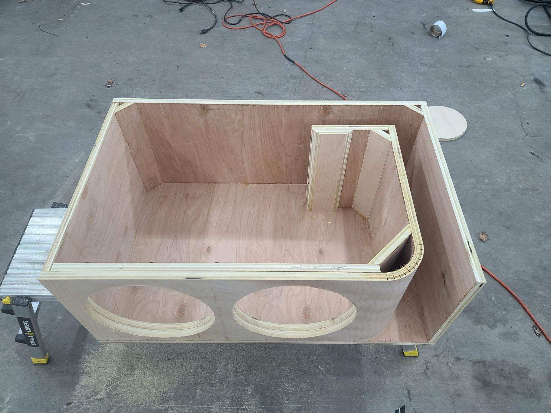

It’s a 250a small case from brand x and box dimensions are 34in wide 14.5in tall 22in deep and the port is 3in wide 29in long kerfed slot port I have the subs inverted facing forward.

Do you have the actual cubic footage and what not? Try putting your motors in the box and see how that sounds as well. Sometimes it does make a difference.
I did a set of lvl4 12s in 3.75ft3 60in2 of port and it did great on a bc4k. Wired down, strong electrical and all too. So the power was a bit more. The enclosure was close airspace wise to what you got but larger overall because of port area/length.
Its making the guy pretty happy and his blazer sad.
39in2 of port IS a little low imo.
